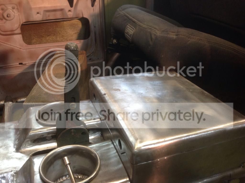

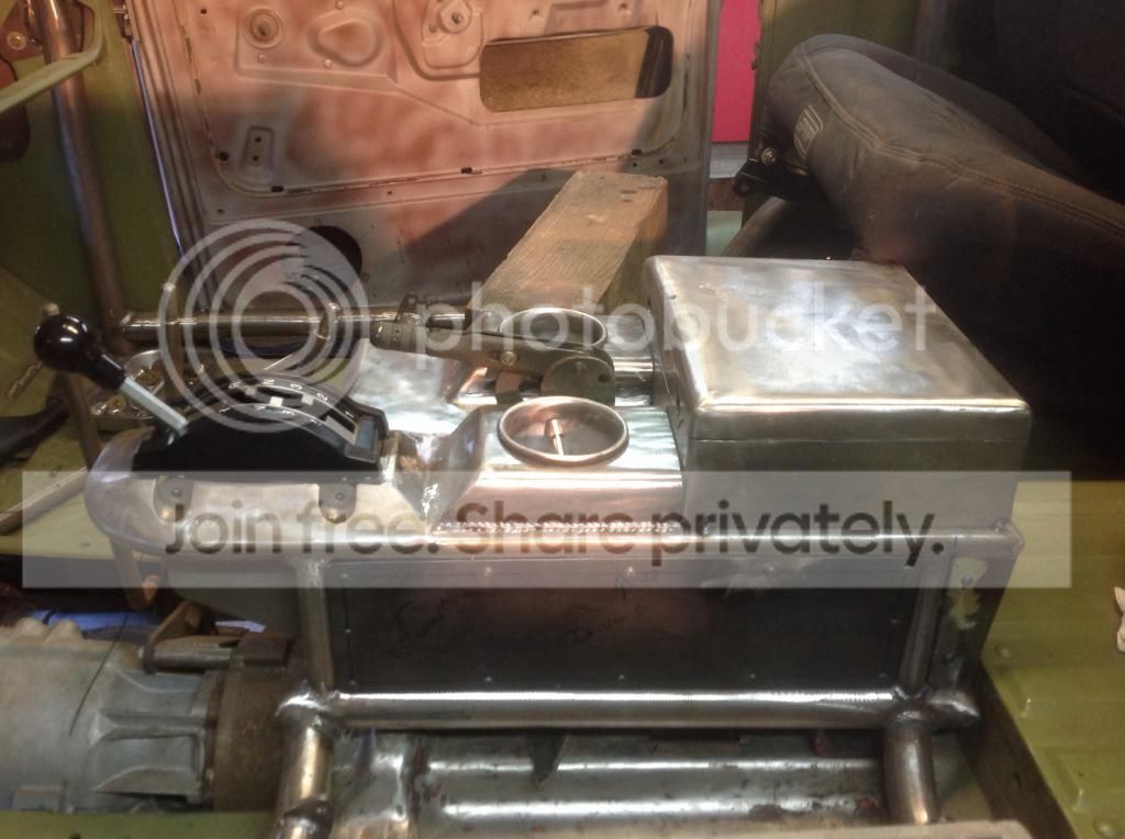

Last Friday I went up and talked to Jess. Job site was about two miles from HAD. We were bs'ing about the ebrake. The first thing he said was, " you're not using a lokar, are ya?".......
I'm sure my face went pale, as I started thinking how much work went into that handle to make it work. After a big gulp of pride and a "Yep, sure am", he explained how it was only a 1:1 and I should be looking for a 2:1. He ran through the math real quick using my 4:10's and basically said I should be able to get about 8k worth of holding power with another handle.... Well low and behold, he had one sitting on a shelve. It's a military one just like I have on the camp trailer. Not only did he give me that, he also gave me a cable that had been sitting on the shelve for years.
After totally reframing the underside of the console. Here we have it. It sits a little higher, as the cable comes out the bottom, but not too bad. The plan was always to use some cordura for around the shifter and on top of the lid, so I don't think it will be too noticeable. Besides, this thing is badass. So much more heavy duty than the Lokar one. I have almost a 1/2" or more of play just by twisting the knob.

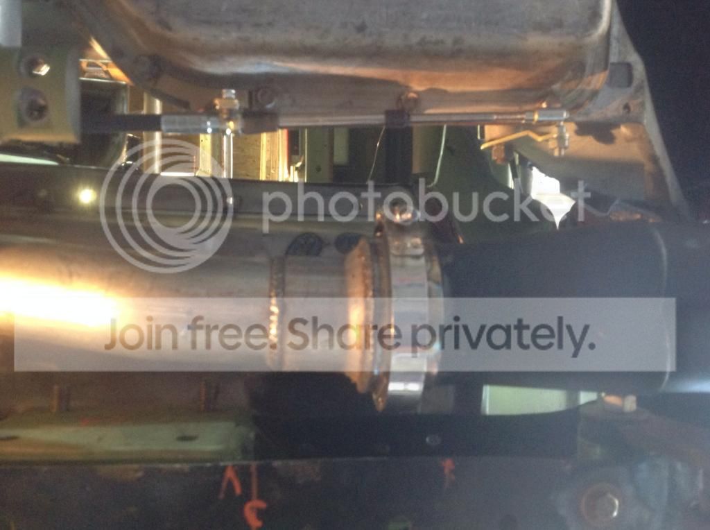

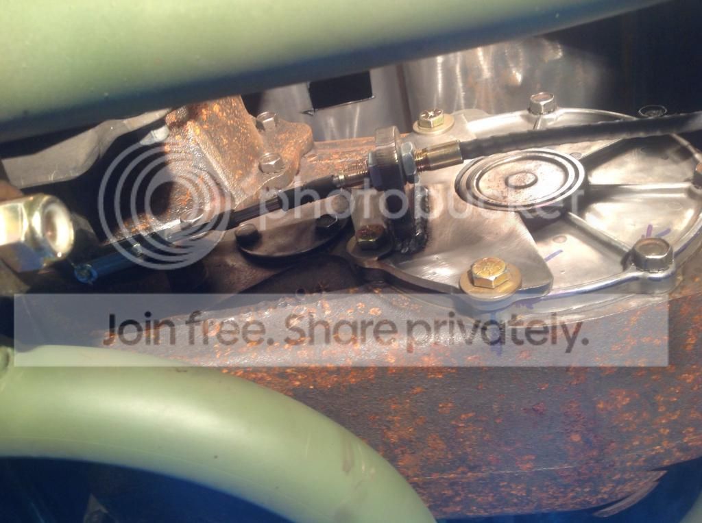

And onto the cable....Made a mount off the back of the 205.
And a little HAD bling.....been waiting for this day. Lol

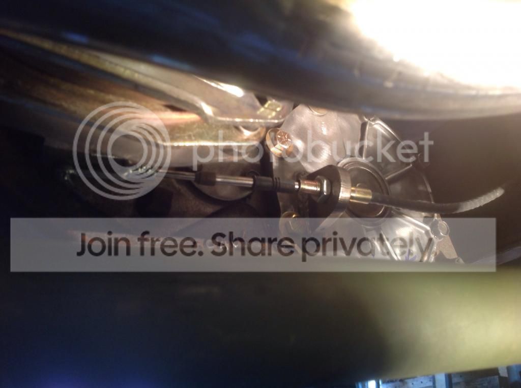

I also hooked up the shifter linkage. That took awhile... No matter how I adjusted the cable ends or the detent area, I could get park, but no 1st, or 1st with no park. I ended up threading the cable back another 3/4", cutting off 1/2" with the grinder, and boom. It all works.

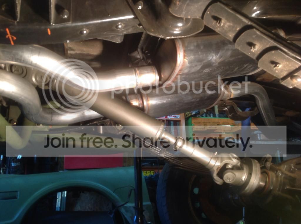

Yep, had the exhaust installed when I had the cast on. Figured I was still moving forward.

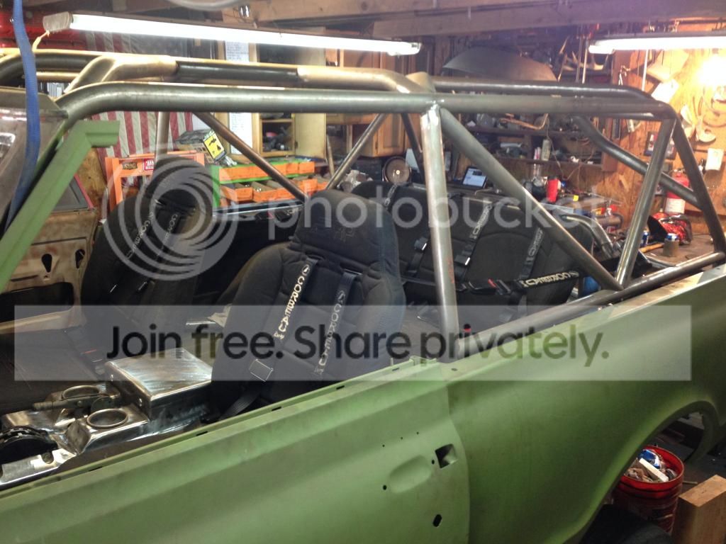

A little Sunday progress.
Mainly working on the center console and the seat belts. Finally by the end of the day, the console was pretty much finished and I moved onto the back seat.

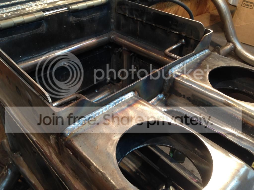

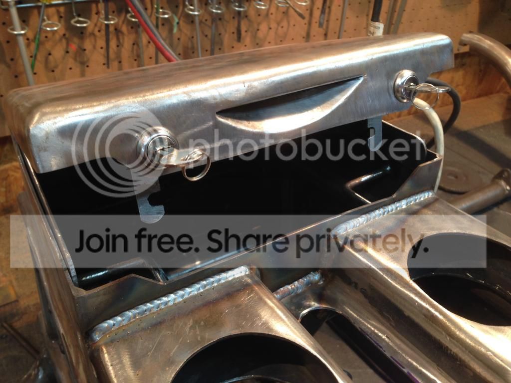

Finished welding up the top portion.
Added some locks. These don't work so good as of yet. I prolly need to figure out something else. Or a better catch.

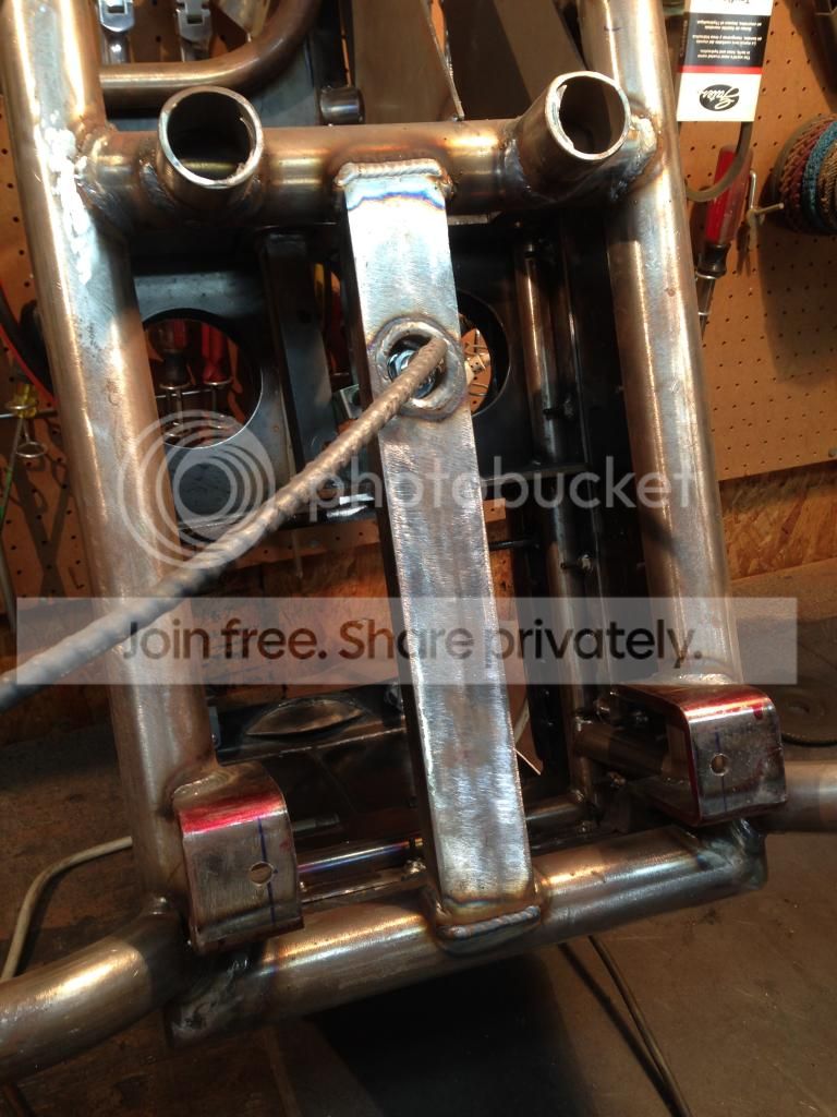

Finished welding up the bottom framing for the E-brake

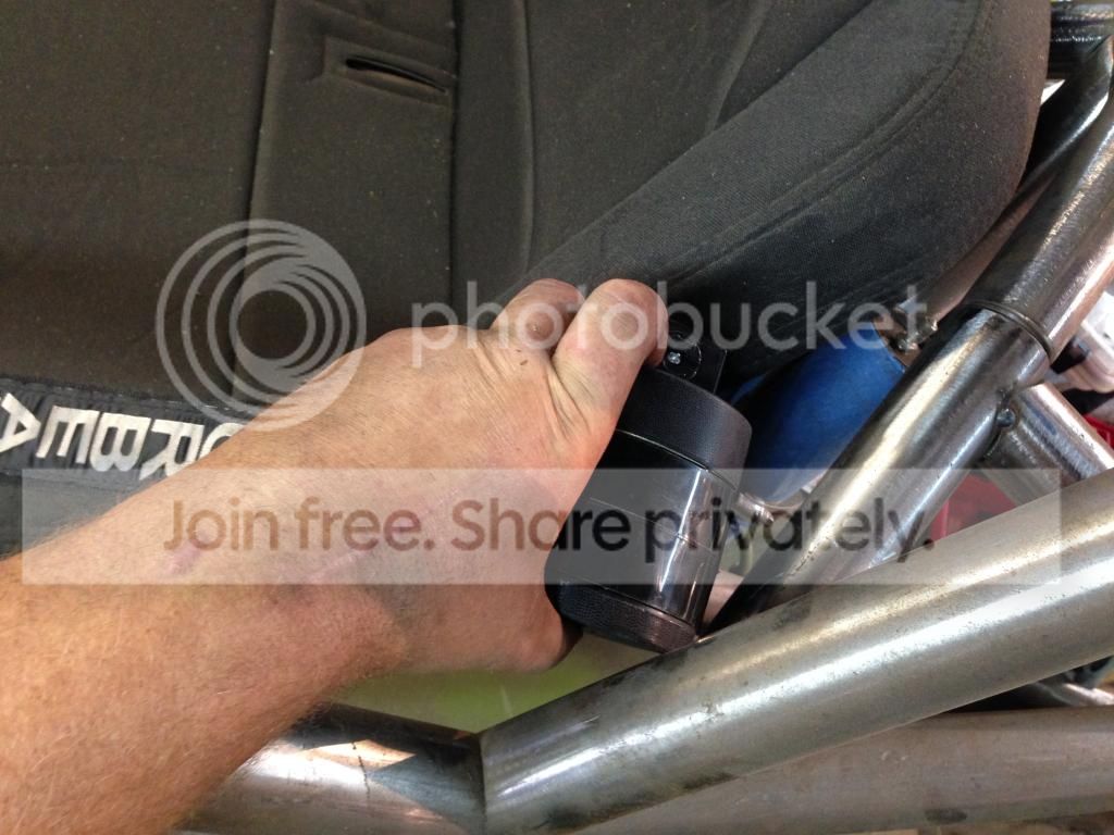

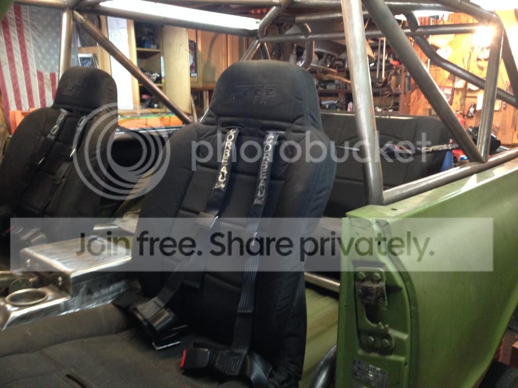

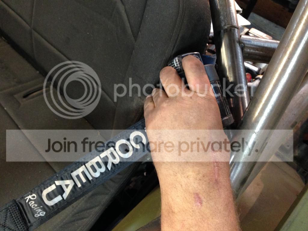

Moved onto seat belt tabs. I actually started a thread about going single or double tab. Single won over.
And back in the rig
And how they look
The three point
Will prolly mount in this area.
The look. :D
The locks do look cool in there tho.
And, that is all. I did clean up the garage too. Ashman might stop over on his way to the Redwoods tonight. I gave him an option, a mowed lawn, or work done on the rig.
I picked for him. :D

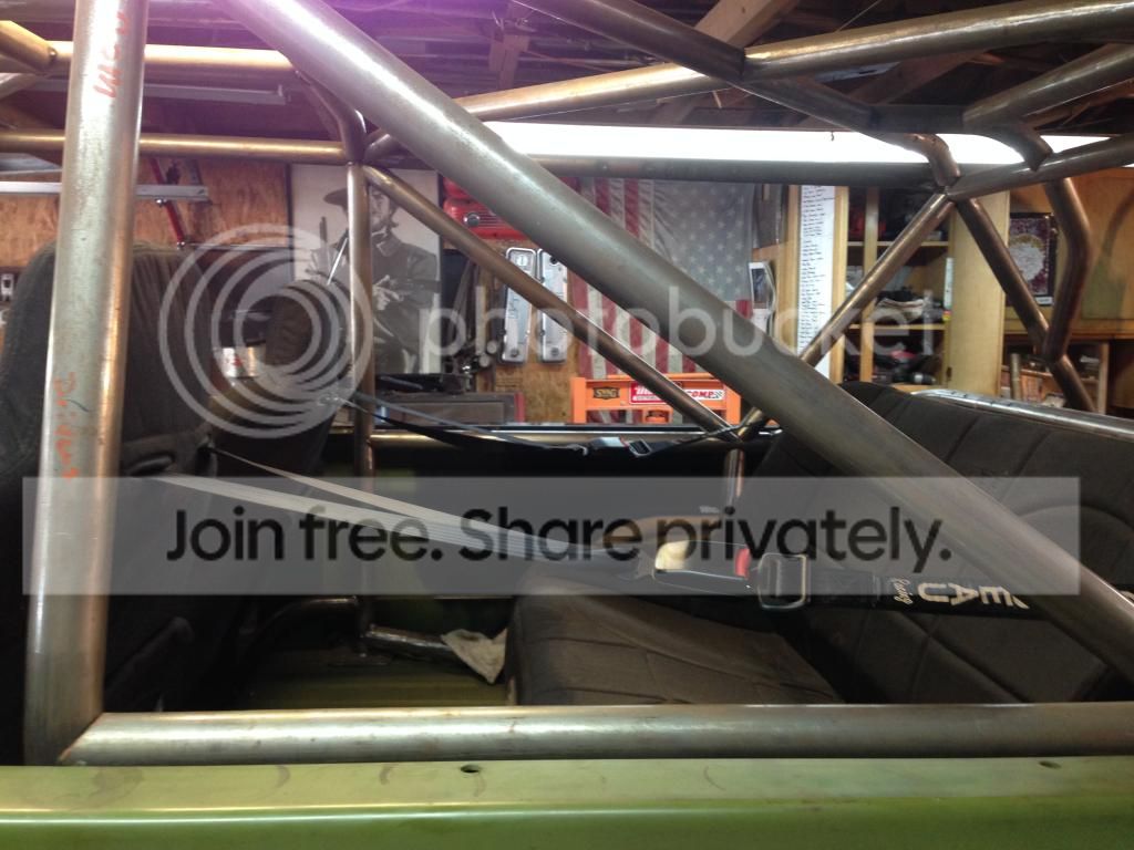

Any reason not to mount extending belt to the top of the cage? I mean there is a buckle. I know normally they would go on a cross bar but your cage is an open design(Which I like).
From reading the instructions, IIRC they wanted something like a 5 degree down on that end. This should really work out perfect. If needed, I can release that back strap fairly easy to let passengers in.
I sat back there......with a beer :waytogo: when I was done. You really don't even notice them.
And I'm with ya on the open cage. It's something that I've been fighting for a long time.
