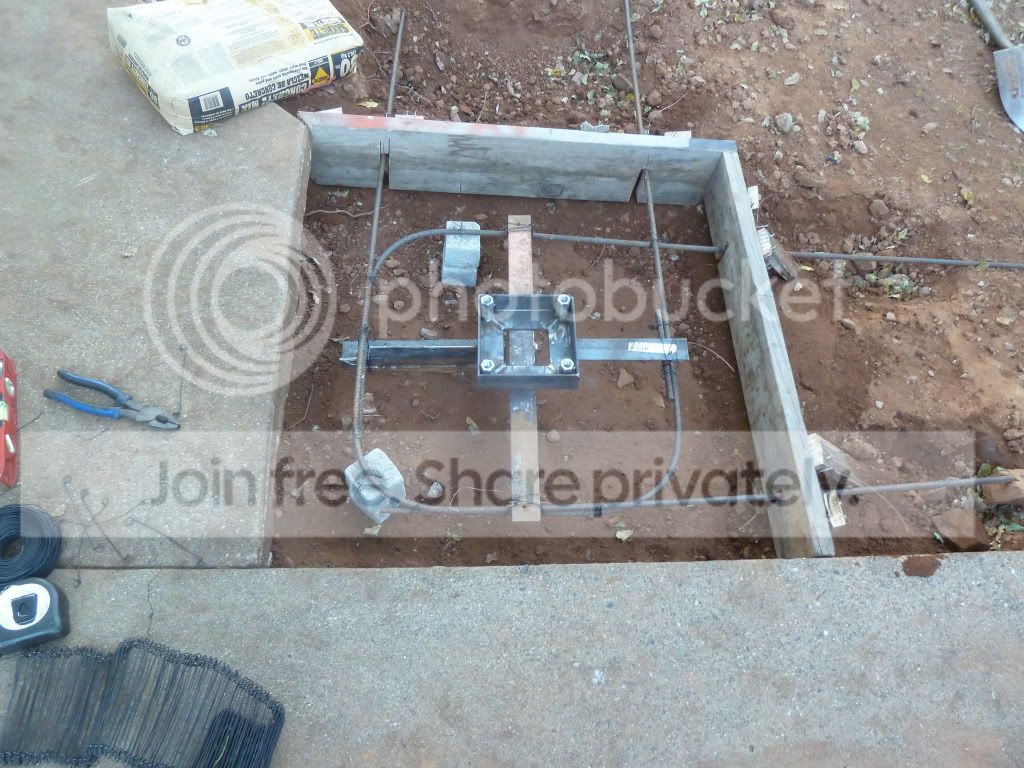

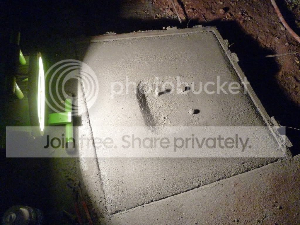

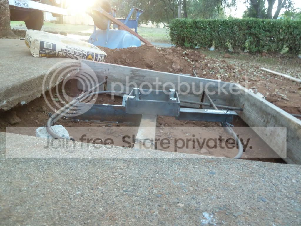

Got some concrete poured last night. Looking back, there is no way that I should have started at 6:00 last night, but it's done. I think that I finished about 10:30. It didn't turn out as nice as I'd hoped as I was just beat after work yesterday and waiting to do the final broom finish seemed to take fooooorever. I had to mix it wet enough so when I hit it with the vibrator it would fill in the undermining and around all of the metal I had in the hole, but dry enough to compensate for the slope of the driveway. Just glad it wasn't at a customers house, or I might have felt bad.
Anyways, there should be no holding back on bending some tube for the first time this weekend. :woot:
All tied up.
The slope I had to deal with. Leveling the platform was a lot of fun. :doah:
15 bags in a 3x3 area :rolleyes: should hold the bender down I think.. :haha:
And the final broom finish. A lot of the surface debris will come off the top today as it should be dried out when I get home.
Dang to anchor the one at work we just drilled 4 hole ad put 4 drop in anchors, no problem with it I know of. But a little over kill never hurt anybody I guess lol. Looks great though man. Now start bending some tube!!!
That oughta do it :thumb:
It better!!! :D
15 Bags for cryin out loud that thing could qualify for a small parking spot.:haha:
The hole in the pictures did not look like it could hold that much concrete.
I didn't think so either, but I bought 18 for this and another project. It's sad that I've been out of the field for so long that I actually feel sore after mixing 15 bags. I need to get back in shape. :doah:
It would have been done like that if I had any flat ground up by the garage. Everything has a very good slope and I didn't want one side to have 16 washers under it to plumb it up.

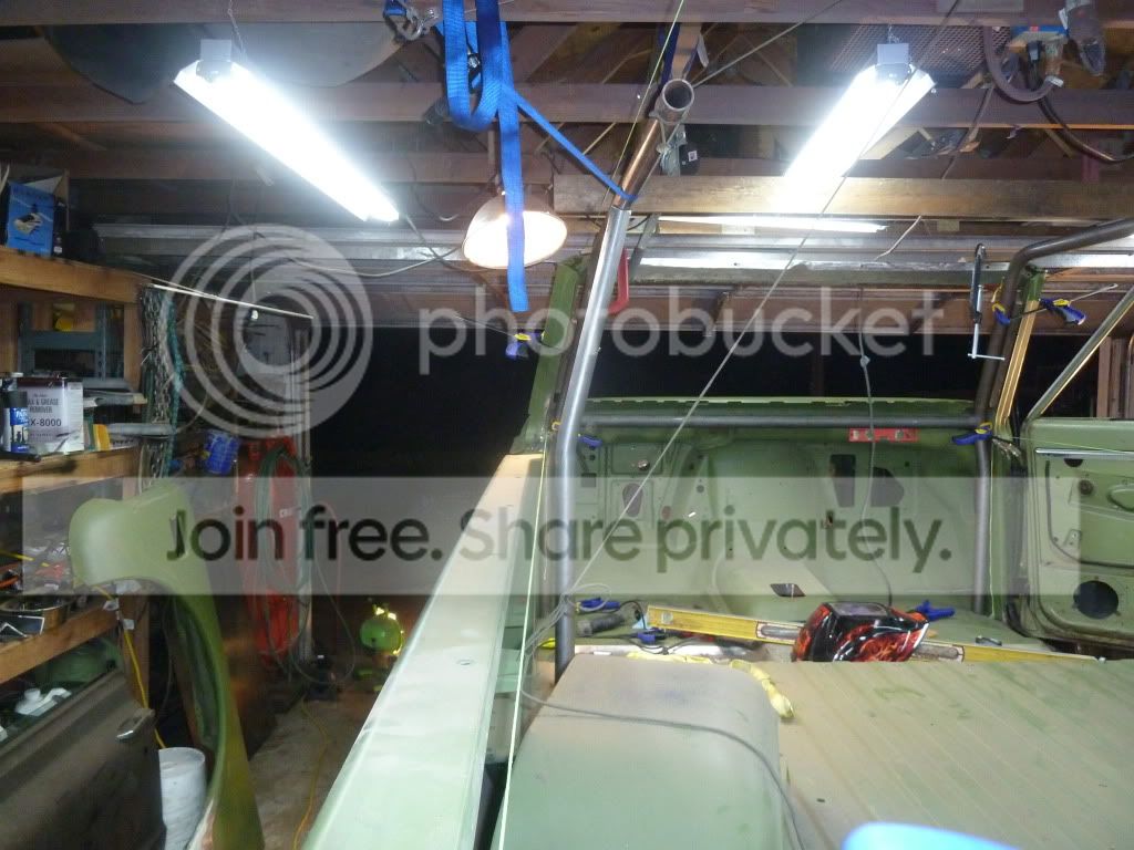

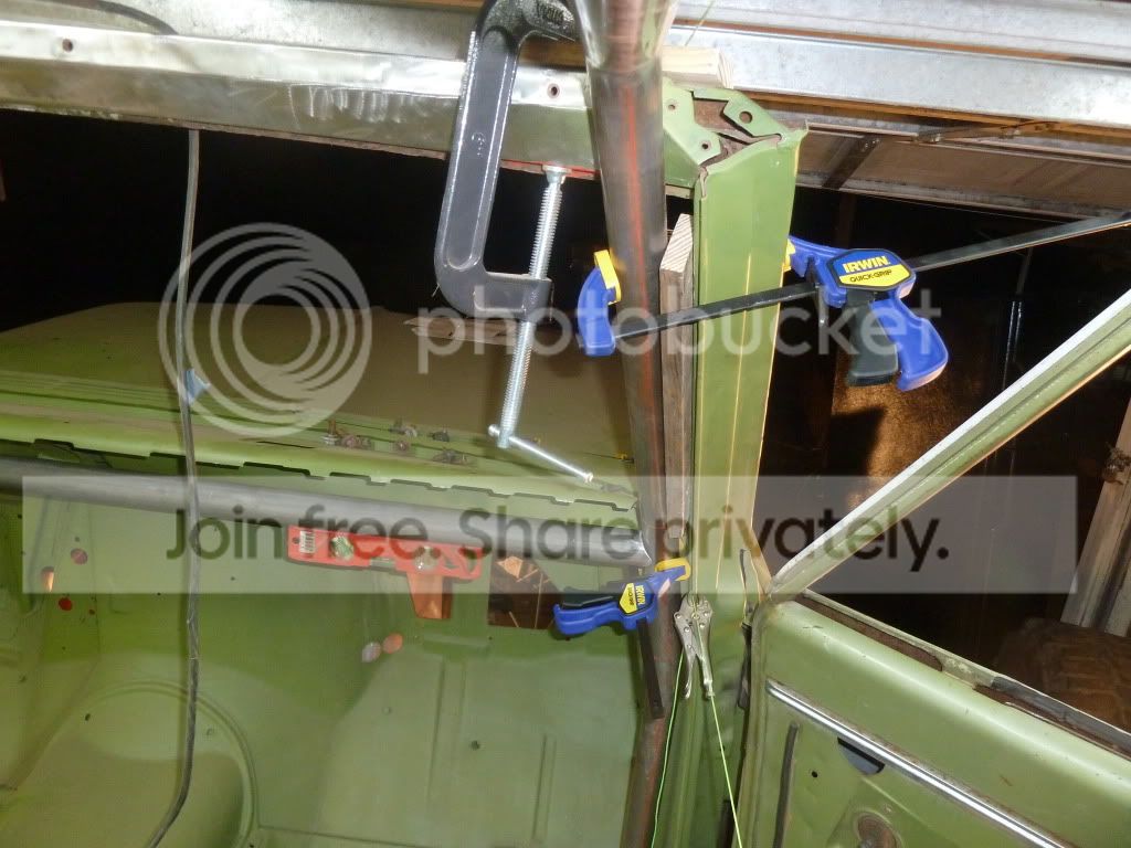

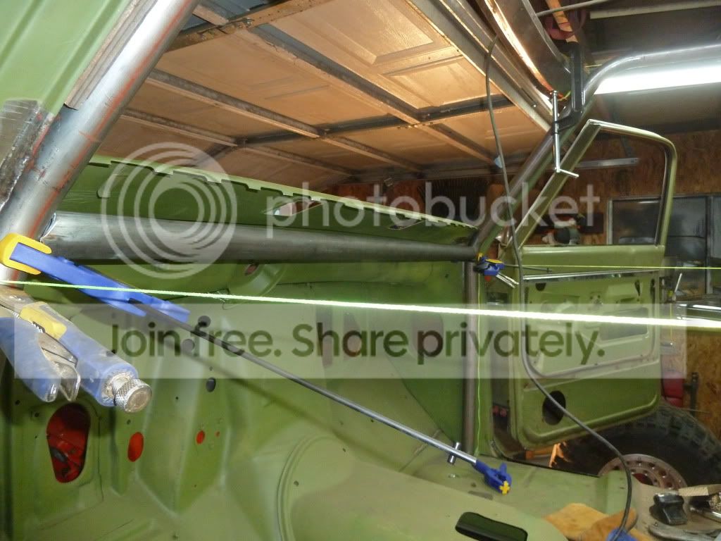

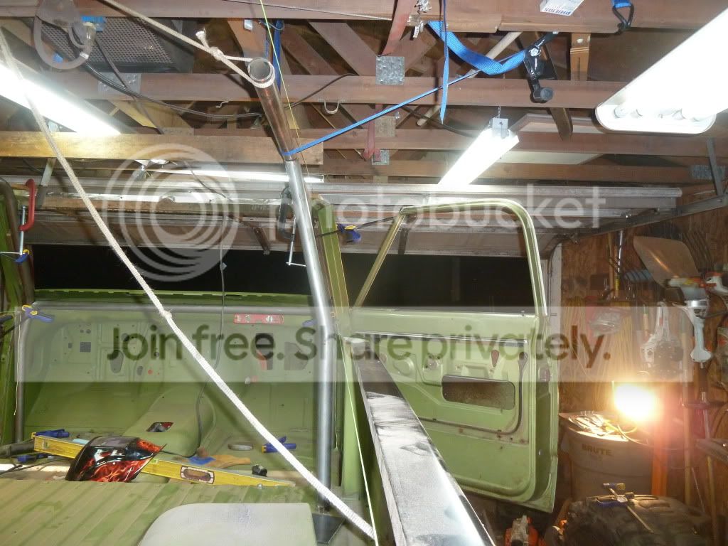

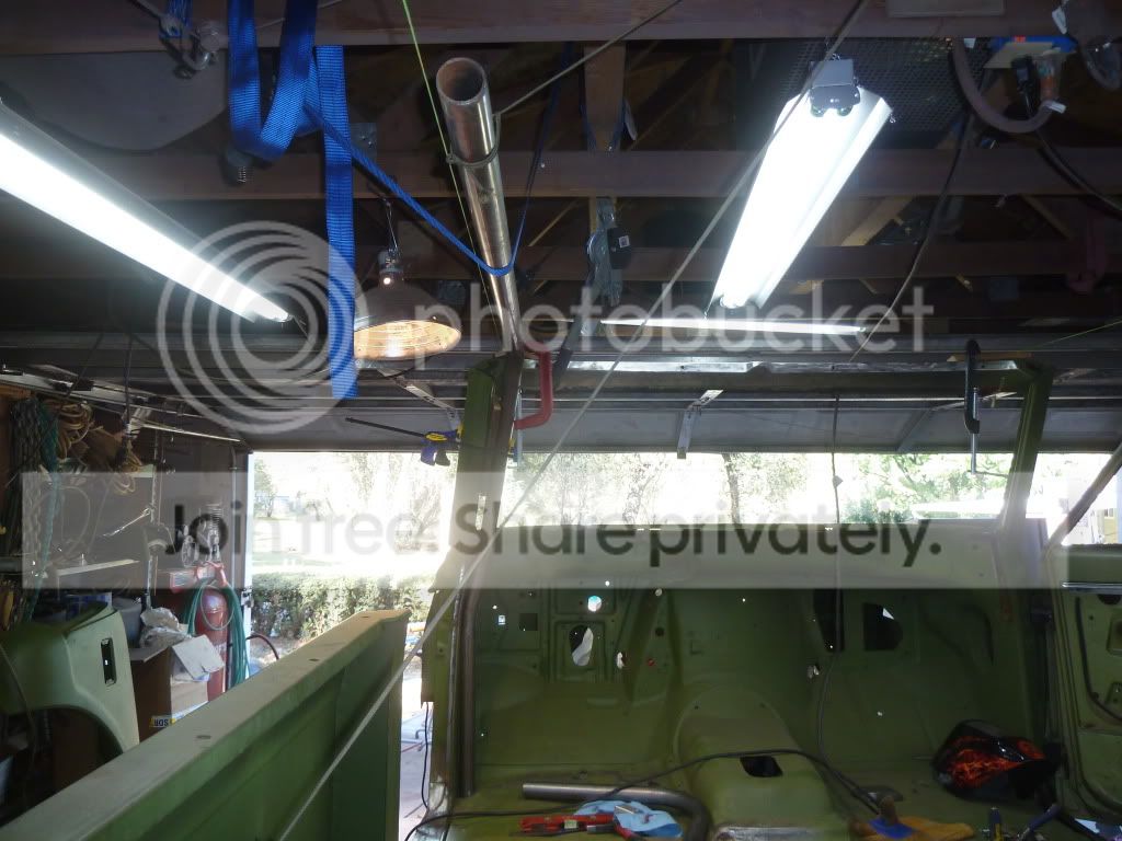

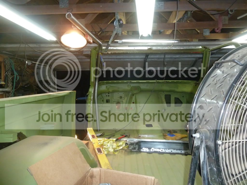

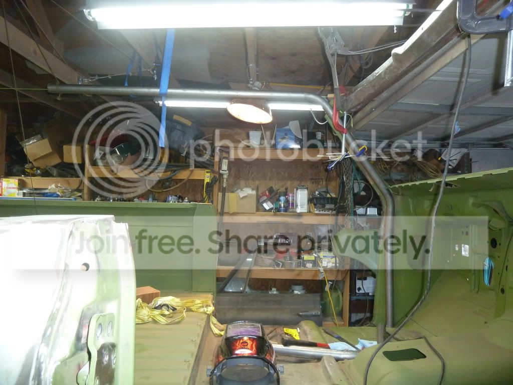

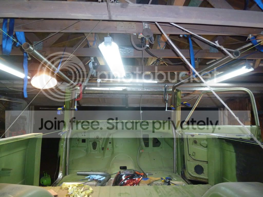

Couple of pics from yesterday.
A-Pillar's
Riding the string line
Behind the dash
The jig
Final shot for the night

very, very nice.. they look good... and I'm sure they drove ya a bit batty making em! ;)
Awesome. Looks like you could use some help holding the tube up so you wouldn't need the tape and wire lol
VERY NICE!!! I can't wait till I get to ruin, err bend some tube! Looks like it's gonna be a nice tight fit:thumb:
Mike, what are your plans for where the dash used to bolt to the inner A pillar? Just trying to visualize this and get some ideas for when I do mine.
looking good, are you welding to the A pillars?
If the word "batty" is the same thing as kicked my a$$ for a while, then yeah, it drove me batty..

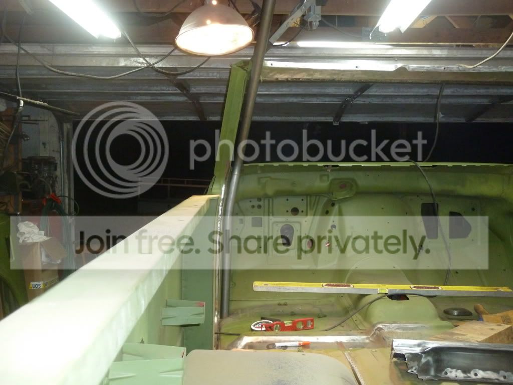

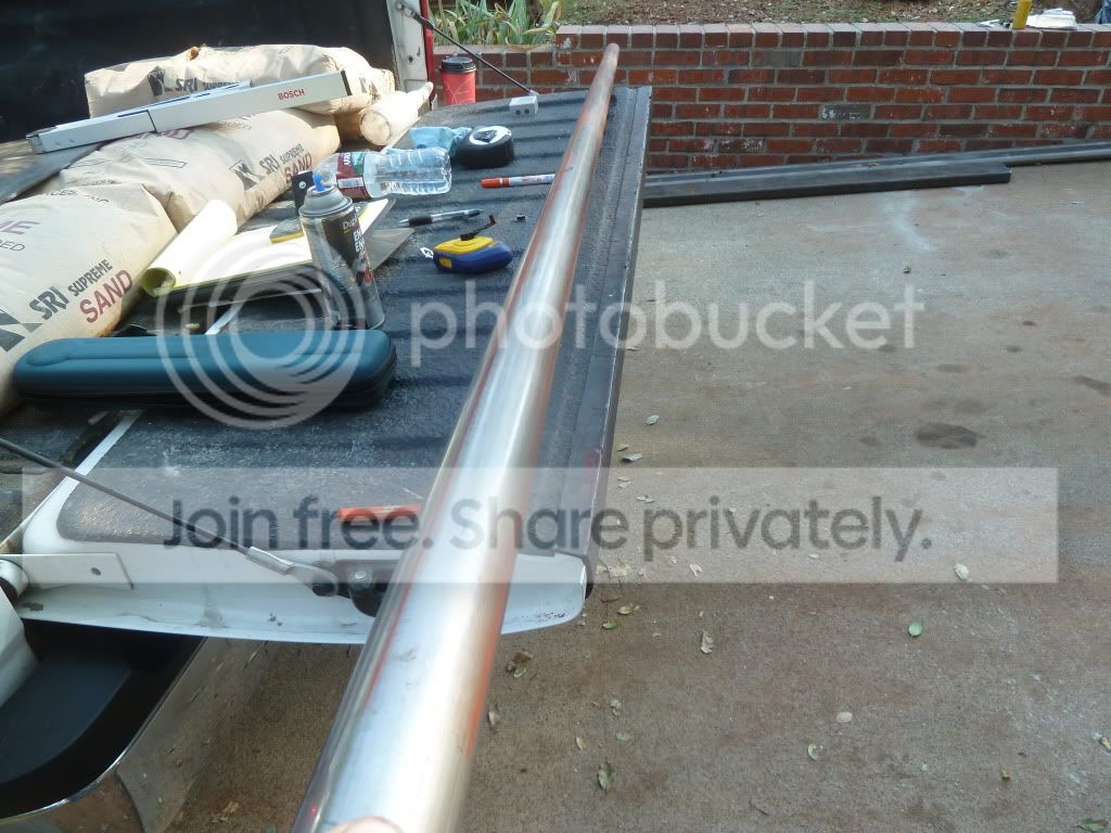

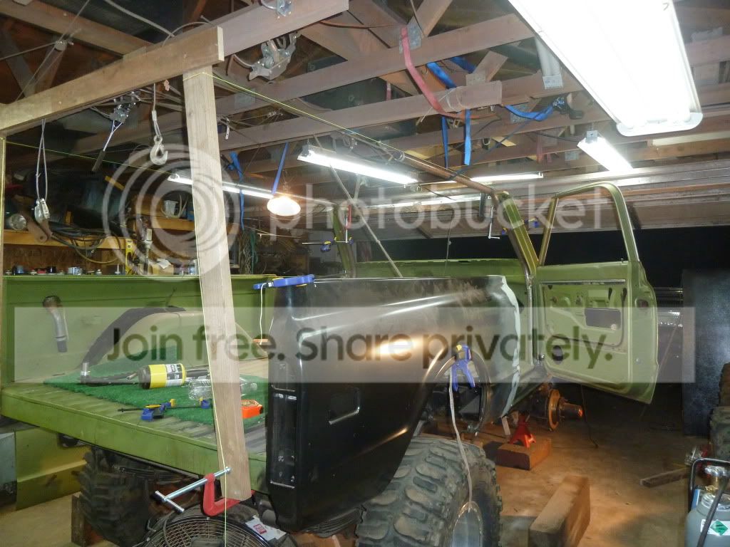

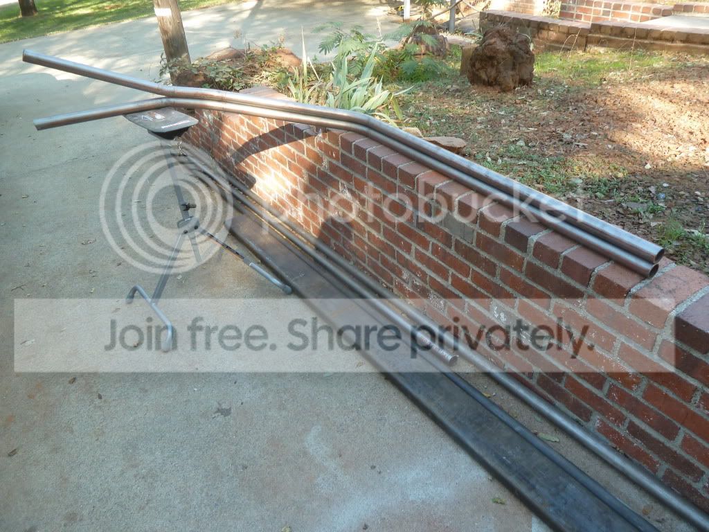

I made two bends last week. The first was a 90 and then I went strait for the drivers side a pillar. I started from the bottom and made it all the way up to the top of the windshield frame and it looked good. I then had 3+' sticking up into the rafters. Well, after a couple of beers with my friend that night, we decided that the top bend looked like it needed to go towards the beer fridge by about nine inches. A lot of math used that night..:rolleyes: Bent it the next morning and had the top rail pointing at the beer fridge. Yep, it was time to sit down and think about all of this again. I didn't touch another piece until this past Saturday. The one thing that I figured out is it is all on the same plane, if you will.
Couple of pics to show what I'm talking about for the next guy.
You can see in this pic that all is out of whack. Once I brought it in strait (from the beer fridge) things were not going to work out.

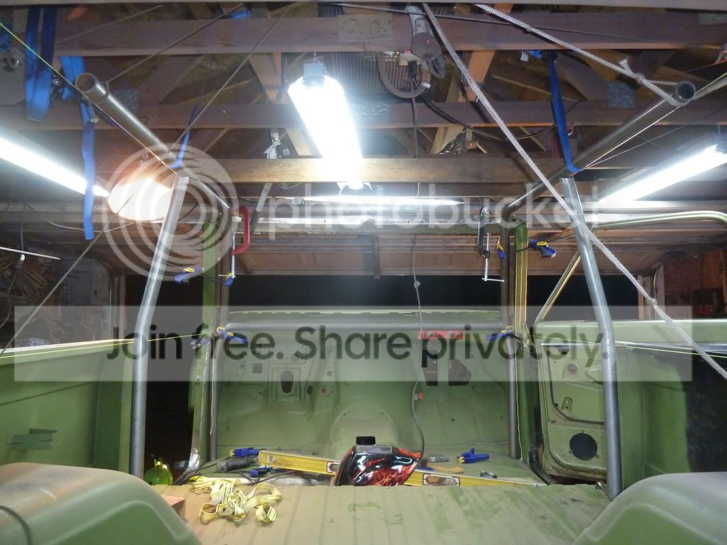

Saturday, when I bent these up again I started from the top and worked my way down. You can see from the pic of the two on top each other that everything is on the same plane except the bottom bend in of 10 degrees. I actually took mine to 12 degrees to give me a little more room between the bottom tube and the kick panel. Should give me a little more room to weld the tube to the center of the plate, instead of tight to one side.
Here is another thing that I did so I could have a better mental picture of the bends. I ended up snapping a couple of lines on the tube with the chalk line and shot some clear over them. It didn't do me much good, but was kinda neat to see the lines and how they flowed on the A pillars once in.

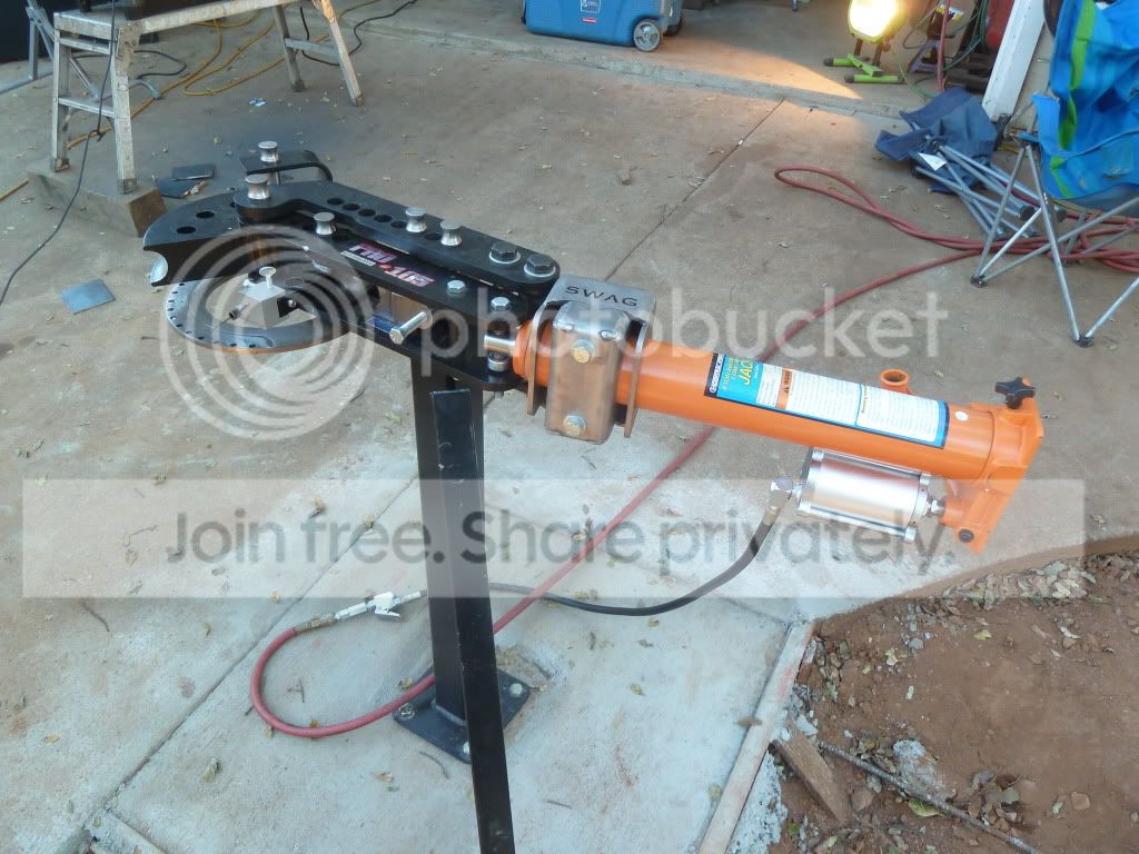

Wait a minute, no pics of the bender mounted in?? WTF!!!:eek1:
Here is the bender all mounted up. I went with the Swag Offroad mount and it worked awesome.
