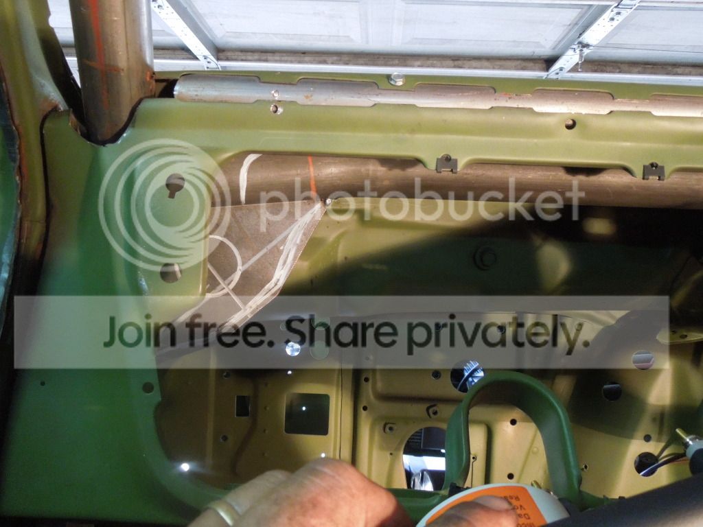

After that, not a lot happened. Spent the rest of the day figuring out how and where I'm going to push the bar through the cowl area and still keep everything 100% bolt on.

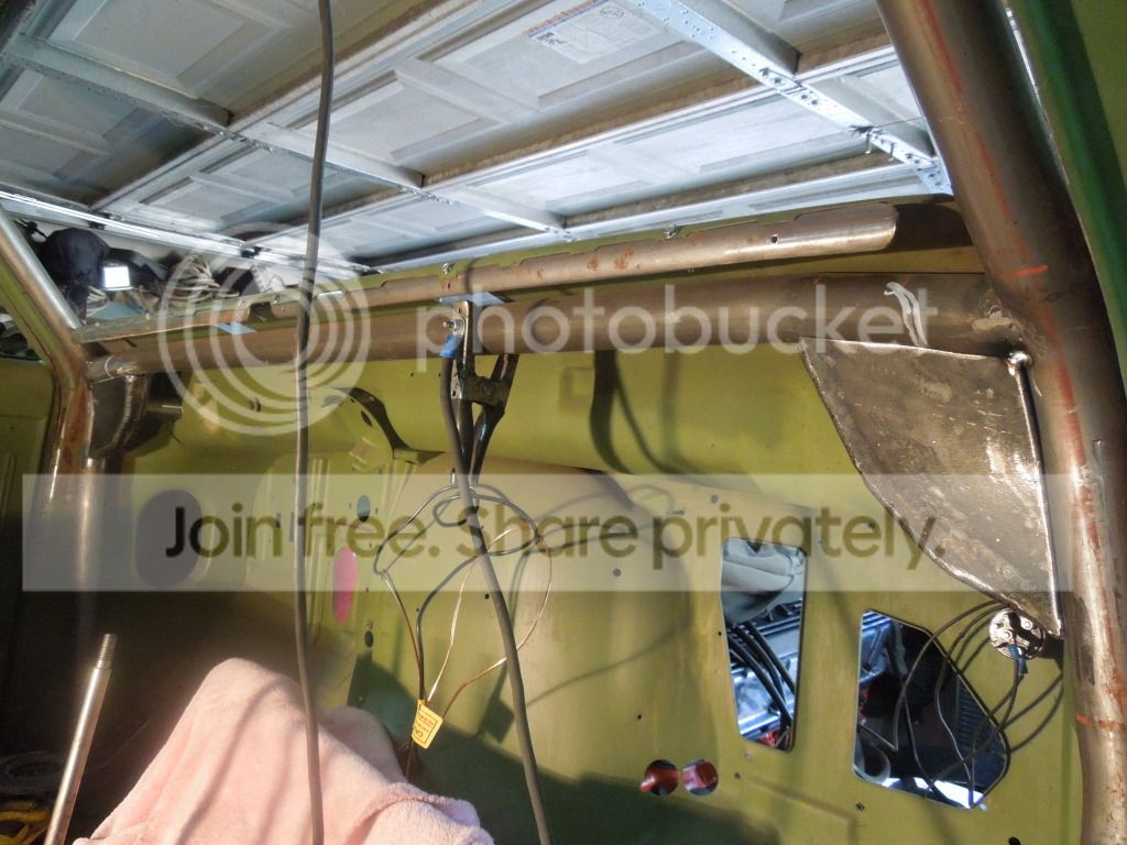

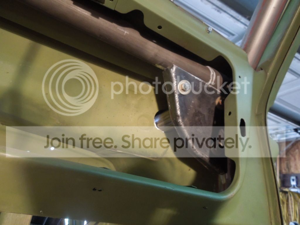

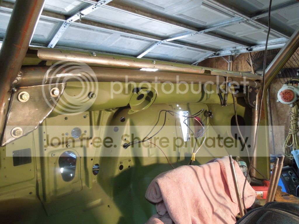

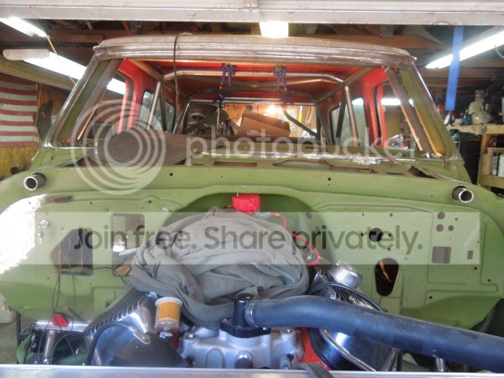

Well, finally made some progress that has nothing to do with crawling under the rig. Put some hours in on the dash bar to my through the cowl bar.

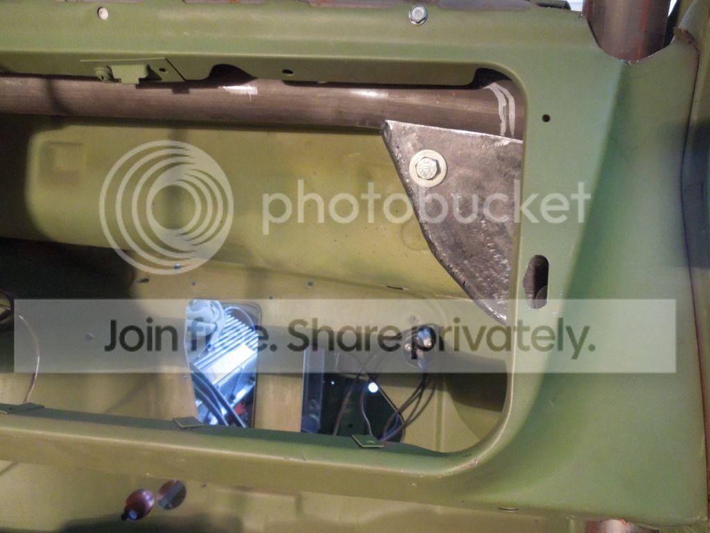

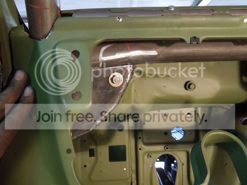

Spent a lot of time thinking of the entire system and pretty much have it all figured out. The first step was to build some gussets with a removable plate on the back side.
Everything came out pretty well. Had to take the dash out several times, just to make sure all would work out. As it turns out, I'll only need to build the glove box a little different. I didn't plan on using one of the cardboard boxes like they came, so that shouldn't be a big deal.
On with some pics.
Drilled some holes..

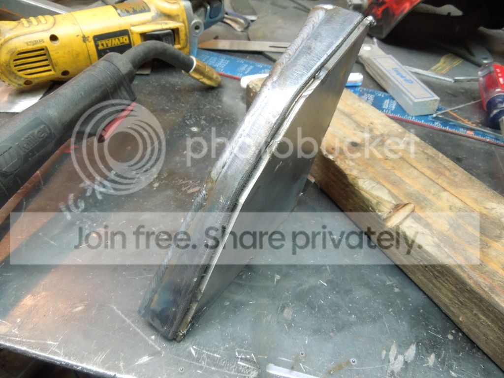

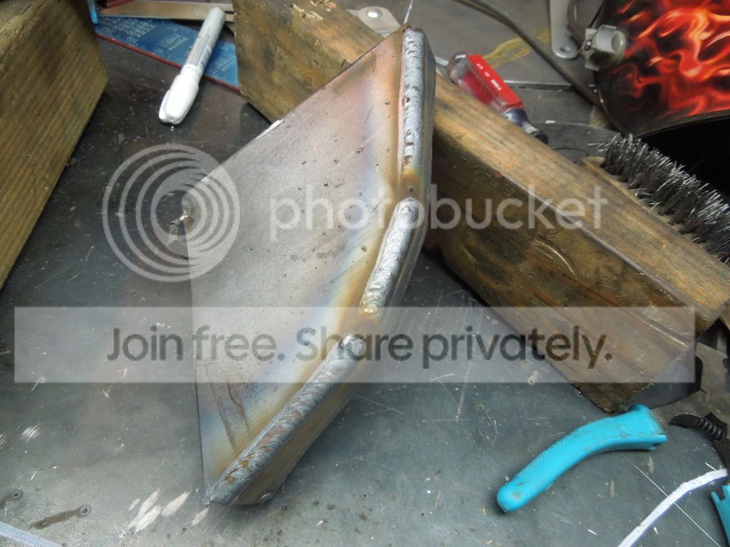

Started with one plate gusset. In the end, I had six of these cut up. Three for each side.

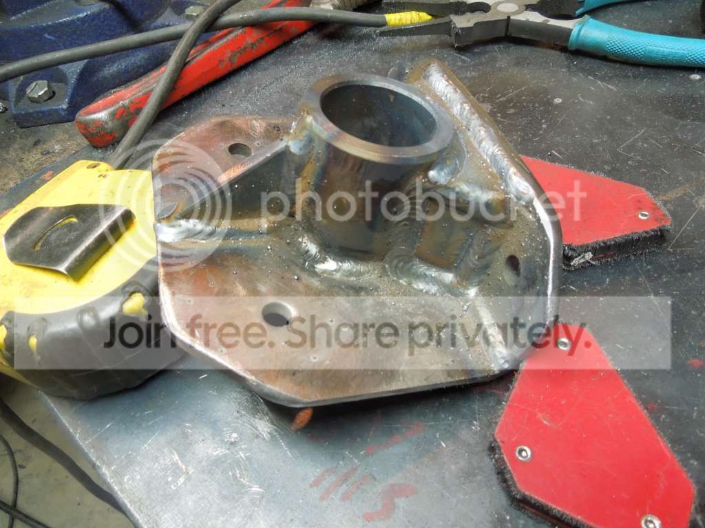

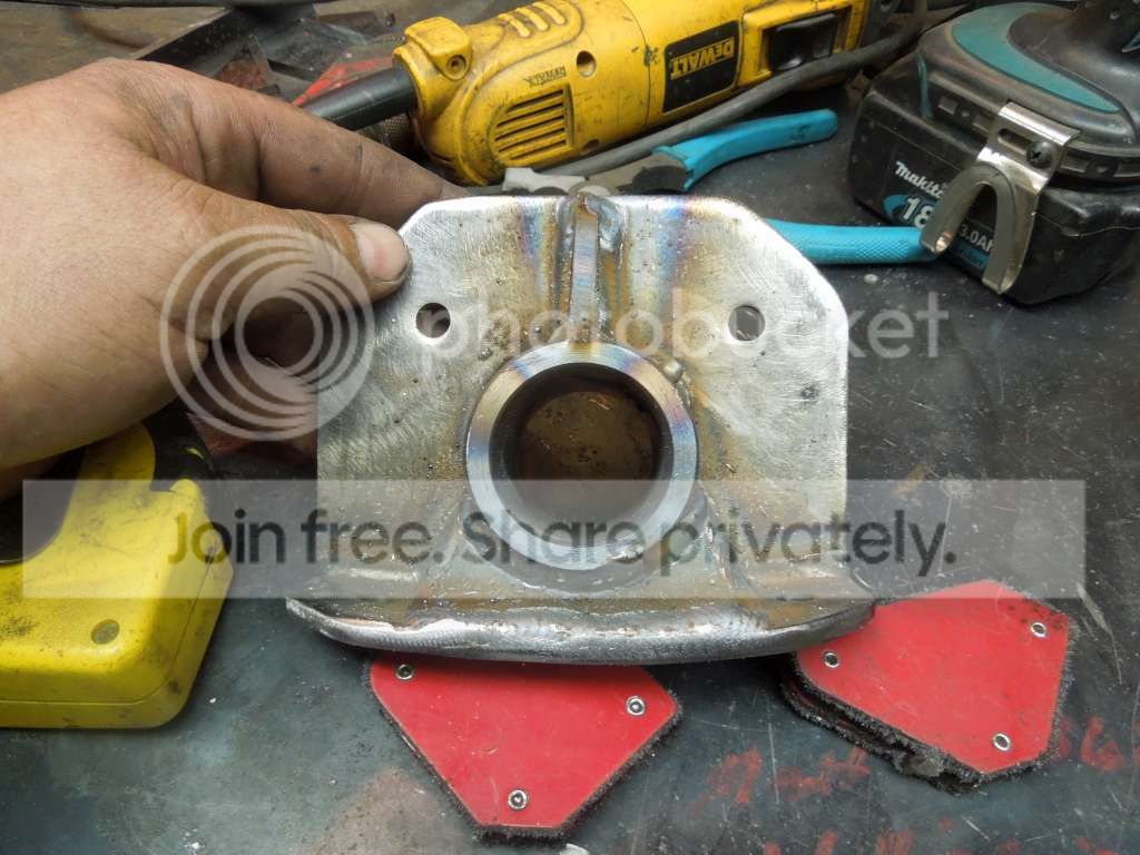

Once I figured out how the boxes were going to work, I started to weld everything together..
Did a little final grind on the insides so they fit nice and tight.
Took everything back out and drilled the holes through 3 pieces of 1/4" and tacked back in..

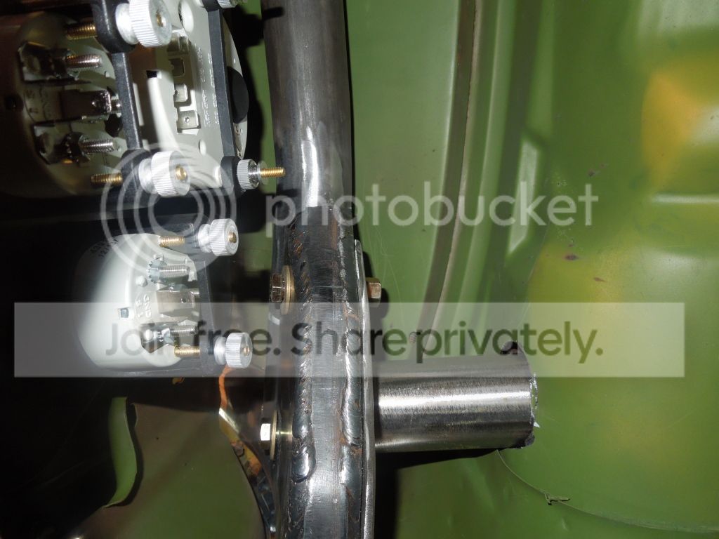

And a couple of pics of how far they ended up in the openings.

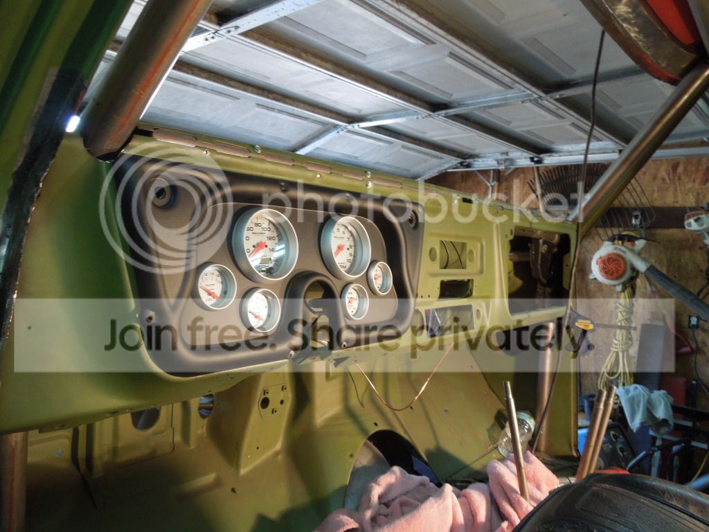

Installed the dash again and took a couple of pics of the clearance to the back of the gauges..
I see where you can bolt it on the inside, but were you making it removable? How will that bar come out with the plate on the back like it is (just curious)?
Also, are those bars going to interfere with your hood closure/cowl?

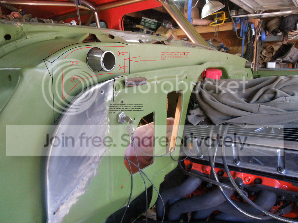

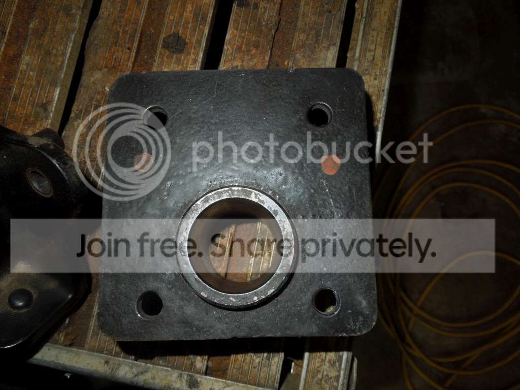

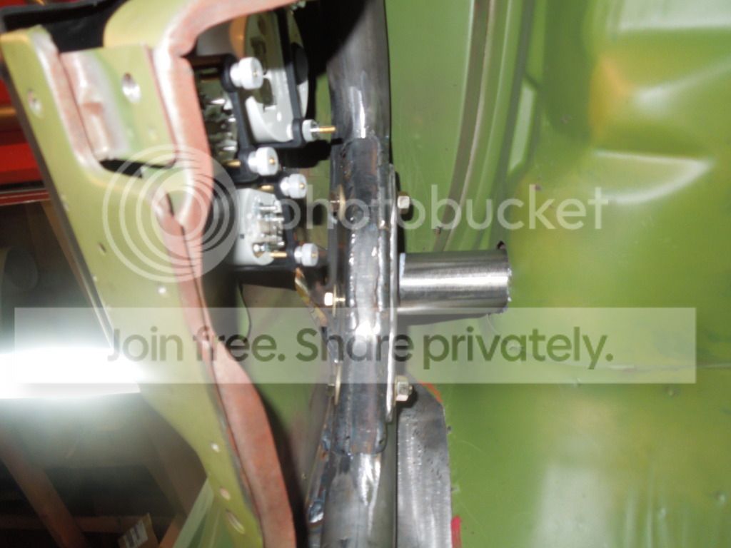

Good eye, my man. It's kinda tough to describe what is going on. I'll try to break it down a little.
With those gussets welded to the cage, it makes the entire cage 100% removable now. I'll need to unbolt the dash, but it all should slide right out to the back of the rig.
The through bars (sorry, don't now what else to call them) were a bit tricky. At this point I can go two ways.
1) Have them so they will always be part of the truck, but will never be seen as they are behind the dash.
2) Add two of the tube disconnect clamps behind where the through tube bolts up to the back of the gusset. Kinda like the two that I installed by the tranny pan. All though, these couldn't be the double locks like down below, they would need to be the singles so they could slide.
At this point it is very important that I get all the rest of the skins on the truck as if I was getting ready to paint the rig....perfect.. It's all going to be locked together soon.
As you remember, I cut out the boxes on the underside, so I really have nothing that will hold the firewall now. With these through tubes, they will go from the back of the bolted gussets.. (then maybe a tube disconnect) to a plate that will be attached to the inside of the cowl. That plate will have a hole in it that the "through tube" can slide through (no attachment to the tube).. then to another plate the will be bolted to the interior plate in the cowl. From there it's onto the engine cage..
Sorry, if it doesn't make a lot of sense yet. I think I got it figured out in my melon though.
Here is a pic that might help.

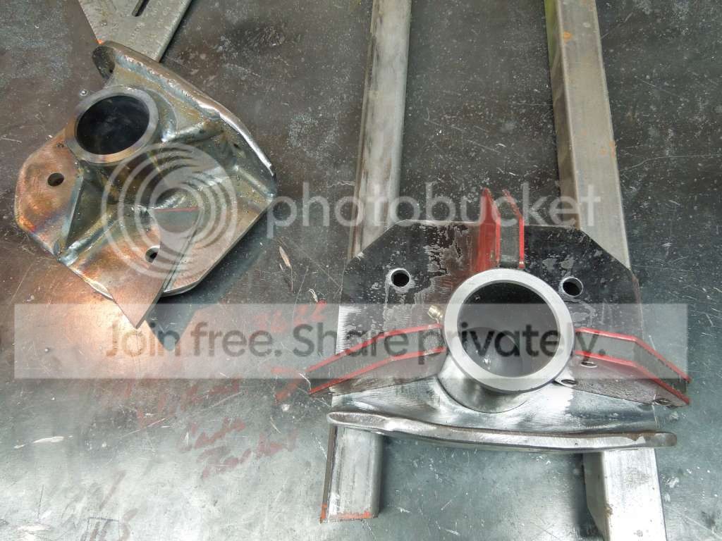

The last couple of weeks have been getting myself pretty familiar with the front of the rig. Someday my shocks will arrive and I want to have as much done as possible for the building of the engine cage/shock hoops.
So, I don't know if a lot of you guys seen the thread that Brandon started about clearing the shackle bolt with big ol' headers.
http://coloradok5.com/forums/showthread.php?t=300441

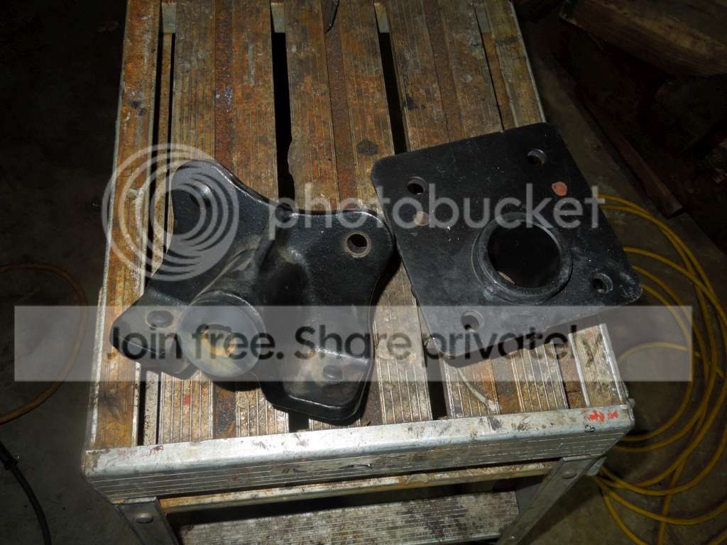

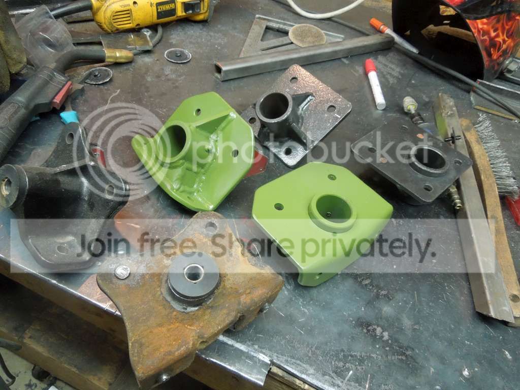

As it turns out, I was having the same problem that many of the other BB 1st gen guys were having. Just not enough clearance with the shackle. I know that the original shackle hanger was built for a 3" spring, with many of us running the 2.5" springs now, I was going to install a FUSH kit from Kert. Well, after I had taken the original off, I came to realize that the new one was just not going to work. After talking with Kert, the flat FUSH hangers that many sell are only for the 73+ rigs. He offered to make me a one-off, but by that time, I had already started on building some.
On with the pics..
Old and new..
Where the 73+ FUSH hit with the bolt holes.

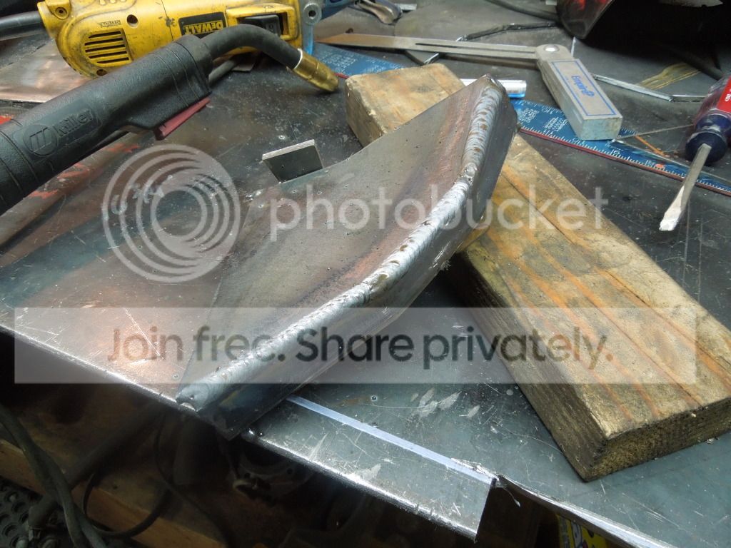

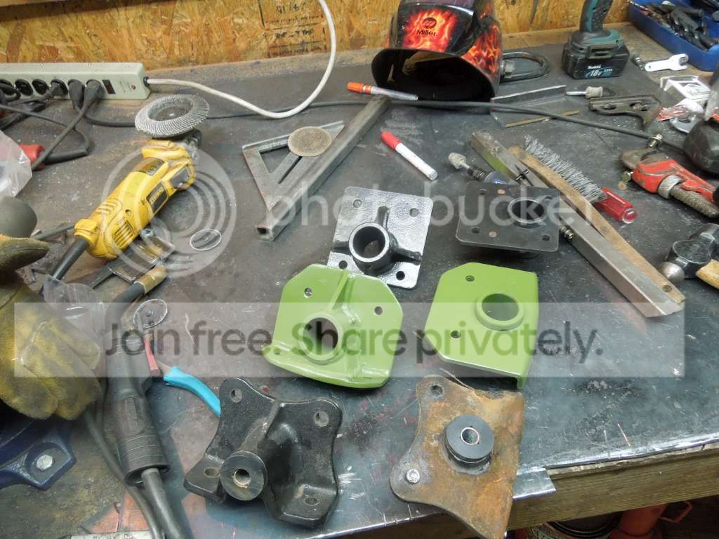

Curved bottom..
Starting to make some up
Blasted, painted and set between the original and the 73+
That's as far as I got last night. I know that they fit really nice, just want to shoot them with some black before I install them 100%. I'll get some clearance pics up, after the install.
