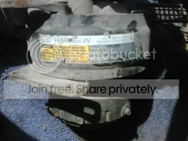

OK here are the pics of the one on my truck. Sorry the first ones are blurry but I shake a little at times now. I had a neighbor take the number ones. It has the plug for wires at 9 o'clock if you are standing in front looking at it.
Here are the numbers on it.

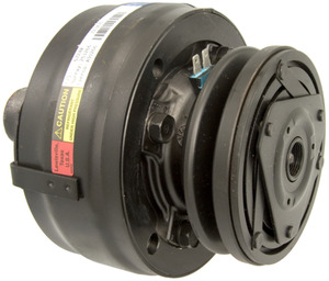

I just took pictures of my compressor. The A/c worked fine when I removed the system last year. There's still some oil in the unit.
The numbers are different, but the brackets & body look identical. The connector is the same 2-blade at 9 o'clock. Can you use it?

i got a similar one but again the numbers are diferent
Harrison
model no.1131198
A big 198 on the side of the model no.
OK here is what it takes type LT R4 compressor. Seems it is a bastard model only used on the 1987 model Blazer with the half v belt and serpentine belts. They used it on cars too.
