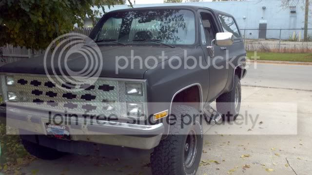

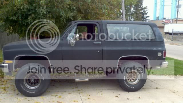

OK gents, I'm sitting here mapping out the build on my 87 blazer and came up with this shopping list. This is going to be a DD/Weekend Wheeler. Could you guys look it over and give me your thoughts. You'll have to bare with me on some of the info as I'm in Iraq and don't have the all the specs on my blazer right now.
The Blazer:
1987 K5
Crate/carbed 350
700r4 (unknown shift kit)
np208
10Bolts F/R (unknown gearing)
Unknown 4" lift with blocks in the rear
35" BFG/ATs
3" Dual Exhaust out the back
The Plan is to get 5" total lift and throw some 37" tires and H1s on with some fender trimming. Here's what I have......
