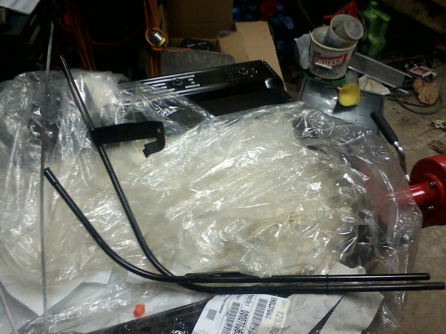

Aren't all the later ones a bolt in/no press fit deal? Here's the one I put in my L31 crate, I don't recall having to do any persuasion. IMO the long one in this pic is the one you want. The earlier versions, and car, are much shorter and harder to reach in a truck.

I went to a local wrecking yard, all their pulled engines had dipsticks, think I paid less than $10. Not sure I ever found the right one by GM part number, but did pay a pretty penny for the wrong one online.
