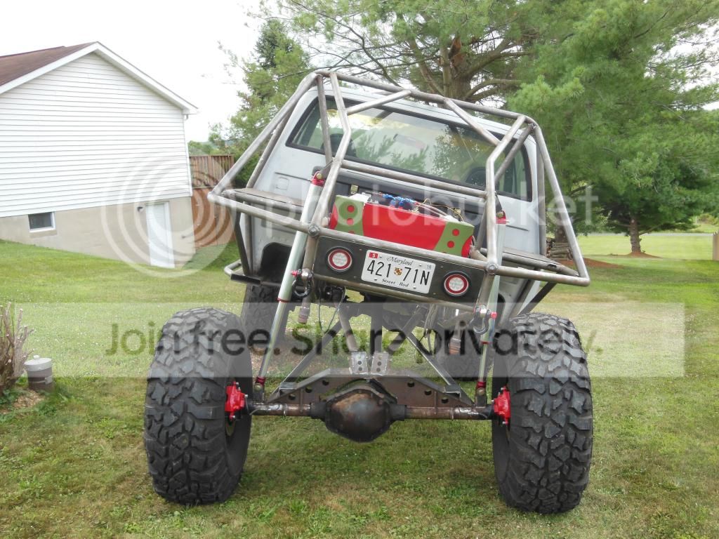

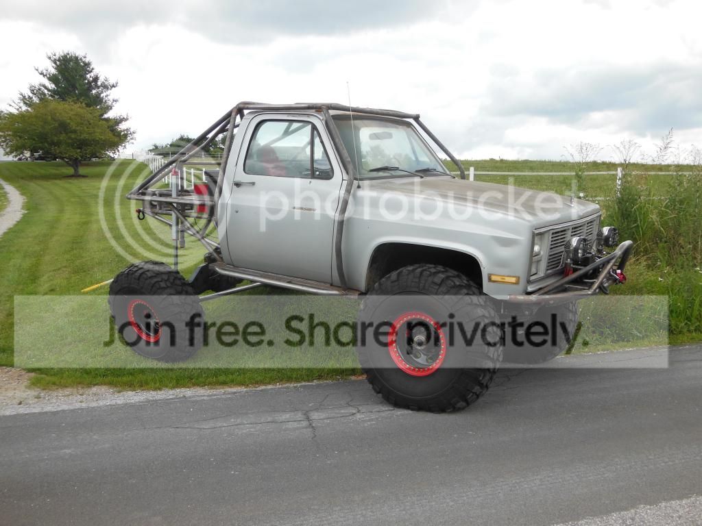

I have 2.5" 18" Profenders on my truck. If I had to do it over I would not use air shocks. When I flex the truck out the rear does all the work even with the custom Alcan leaf springs in the front. This is because the rear unloads so easily. I am waiting on a sway bar to help transfer some weight to the front of the truck so the leaves can flex.
As you can see about 18" of rear wheel travel and a measured 2 inches of front flex.
It is scary when the front tries to flex over something because the cab leans over due to the rear doing all the work.
I would like to note I am still building my truck and have not wheeled it yet. The "driveway" wheeling and flexing I have done shows they flex well and the ride is pretty good for a heavy truck. I run about 200 psi to get the truck level.
The air shocks can be made to work on a heavy truck but when working in tandem with leaves in the front you will most likely need a sway bar. Looking back I would drop the extra coin on ORIs or Coilovers.

My sway bar should be here next week and I am hoping this will cure the no front flex issue. You can tell the front springs want to flex (and do by strapping the rear down) but the rear just droops out with no resistance. If that does not work out I may look at selling and going to something different but I really don't want to have to rework shock mounts.
