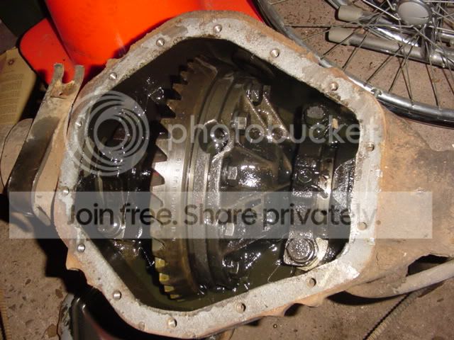

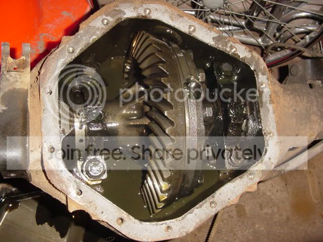

Alright what do i have?.. pics
stockk5
Apr 13, 2004
2,304
415
Cromwell, CT
I am new to this whole 1 ton deal so could someone fill me in on what i found after popping the dif. cover? anything special? gov lock? things i dont know?
Also it says 0 G1 3992484 11 41 8 78 on the ring. So does this mean i have 3.73 gears?
hey thanks for the info! i was hoping for atleast 4:10's but what can ya do.. time for a detroit and some 4:56's wooo... now if i can just find that tree with all that money on it. How much would all of that cost me? to re-gear and a detroit? about 2g right?
Gears around $200, Detroit Under $400, Install kit about $120. Goahead and do the disk brake swap around $150 to $250.
I always thought on an open diff., you could see the spider gears? Am I wrong or is just the 14 bolt different?
Eric M.
Eric M.
You can see the spiders on a 14 bolt, just not as much of them as a 10 or 12 bolt. In the red circle is part of the spider gear.
Ahh, I see them now.
Thanks!
Eric M.
That is not a spider gear, that is the side gear that the axles goes into. :thumb: The spider gears are between both the side gears.
