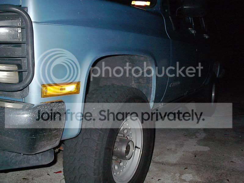

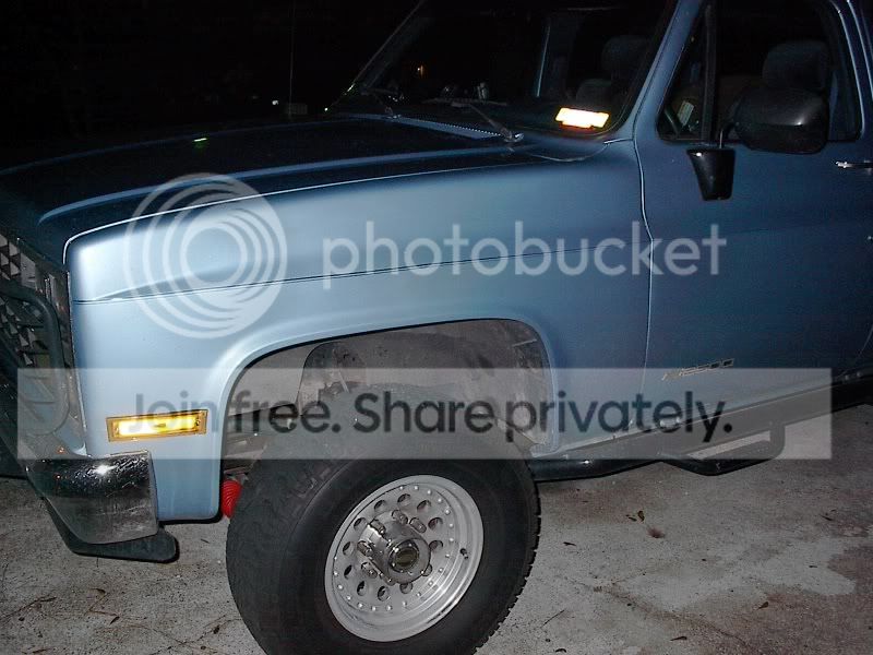

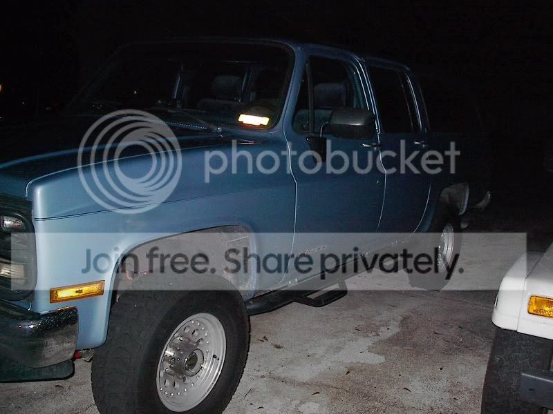

Hello All!! Bought my first Chevy. It's an '85 Burb in rather good shape.
The 350 has at least a blown headgasket. Instead of going into it I have a 454 on the way. It will be outfitted with an Accel MPFI kit. I will be keeping stock exhaust manifolds but true duals. Will be running a Be-Cool aluminum radiator and electric fans. The 700r4 will get replaced with another once this one blows.
This burb will be a pack mule. There are 6 of us and we want to pull a camper comfortably. Plans are for a 2.5" lift by way of ORDs Shackle Flip and not sure on the front springs. The tires of choice will be 245/75/16E BFG A/T.
It wont be set up for hard core wheeling but will have a winch front and rear to pull us where ever we would like to go need be.
There will be more to come I am sure.
