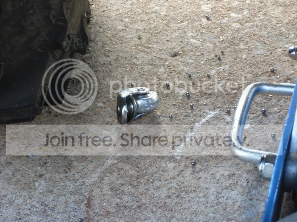

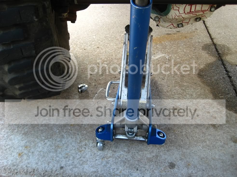

Well I was doin some wrenchin today. Replaced the radiator yesterday and the power steering pump today. I had a jack under the front diff to take some weight off the tires in order to bleed the power steering. It did fine for a few cycles with the engine off, but when I started the truck and started to turn, the jack broke! One of the casters simply gave way.
Of course this was just a HF lightweight, lo-pro cheapie, but it has given me about 4 years of reliable service. If you've got this jack, take a look at the casters now and again. I never trusted this jack as much as I had trusted others, but it seems my gut feeling has been confirmed.

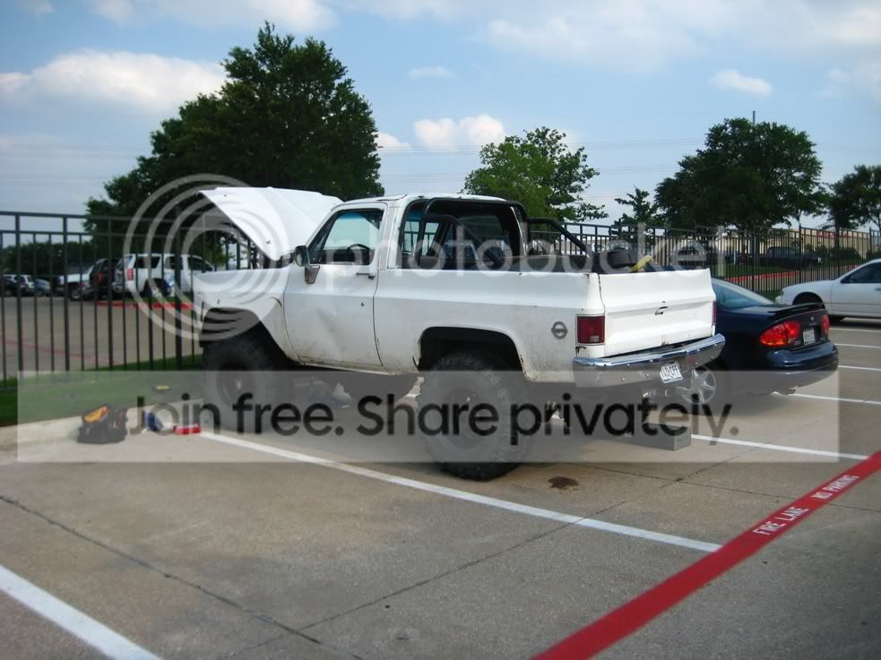

The rig. That's my DD next to it. It doubles as tool storage :haha:

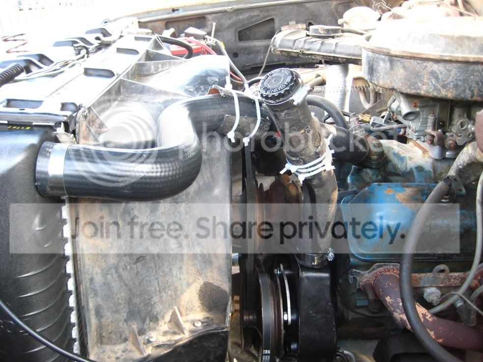

The work. Note the ziptie mania I got goin on. I also used some old radiator tube to extend the neck of my power steering pump. This increases fluid capacity which helps since I have hydro assist steering. More fluid should also help keep the system's fluid a little cooler.
Oh noes!

Good casters aren't cheap so unless you buy an expensive jack it will have some cheap junk casters on it. The jack itself on the other hand is nothing special or different from any other jack. Why not just find some good quality casters that will fit that jack and just replace the casters.
