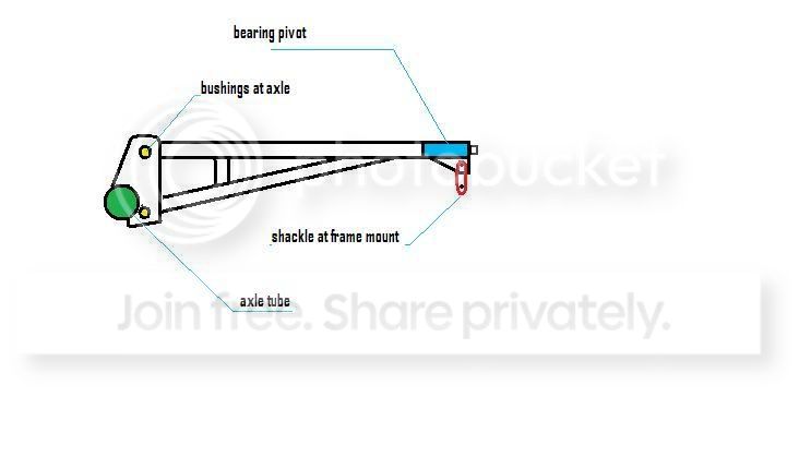

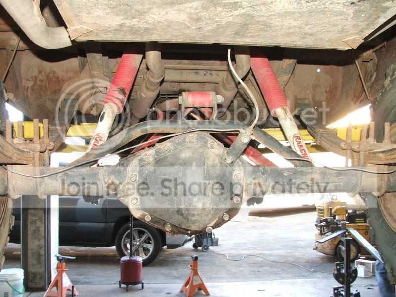

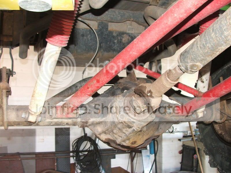

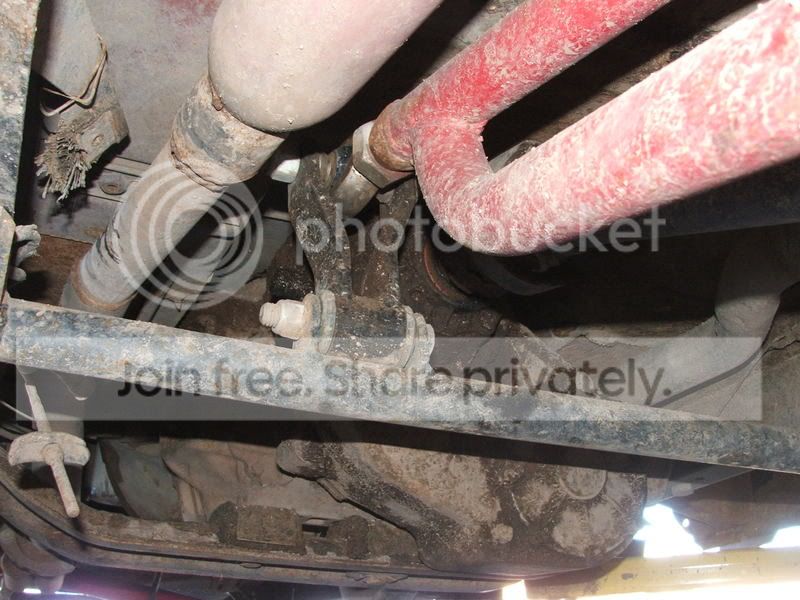

Diy wraptor parts along with my crossmember. Shackle design with a bearing built into the bar. I have made one with a heim joint and it worked well also.
just a quick note, you can build your own bushings pretty dang cheap. from ck5 vendor 4wheelingplus you can get a set of energy suspension bushings, then just get a piece of tube and chop it down to size and you're good to go. i'm ordering a set from them tomorrow to build hinges for a swing down bumper. i think it's the cheapest set of bushings i've found, so probably great for this purpose, but probably not so great for spring bushings. :dunno:
