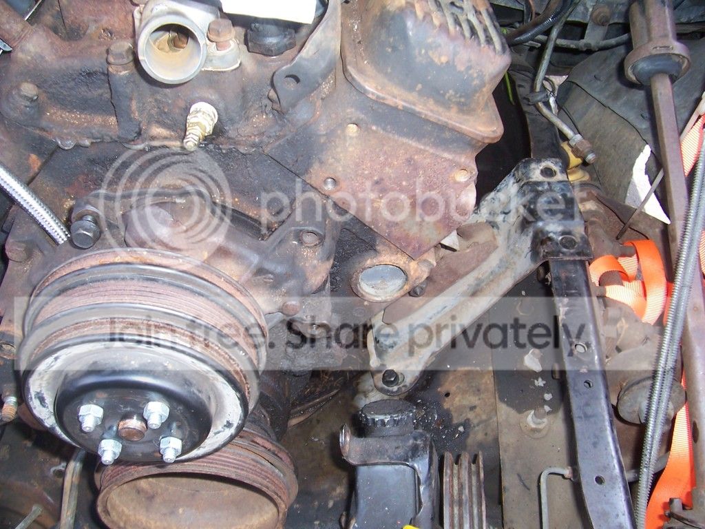

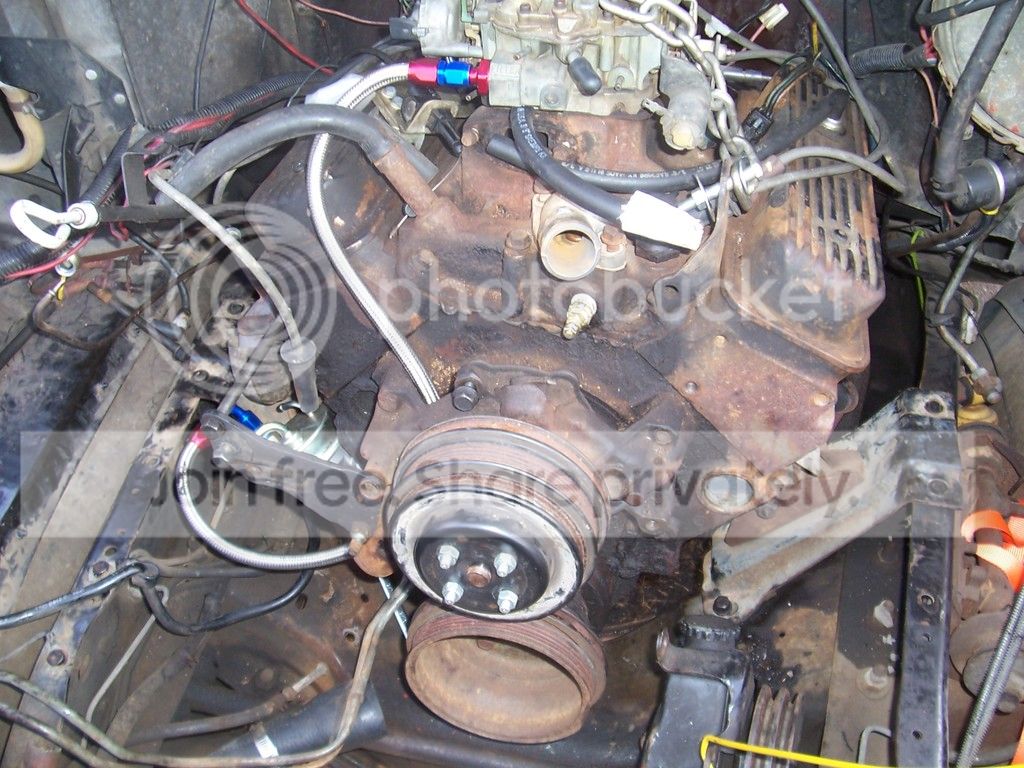

i have to drill 3 holes on each side/both left and right frame rails because my truck doesn't have the holes for the engine perches.
i'm going from v-8 to v-6. As you probably know, they didn't offer this engine until 85 and my truck is an 83---thus no holes. The position for the v-6 perches is different from the 8---as you may know the 4.3 is a shorter small block--and the engine mount point is 4.4 inches further back compared to the v-8.
These pictures should better illustrate where i need to drill:
You may notice that the rearmost holes on the crossmember DO exist and line up for the v-6 perches. So i have those plus i've connected the transmission the engine so i have those to work with to get everything centered which is more or less is. All i need to do now is drill.
Are there any tips? Should i drill a smaller hole, then slightly larger, and then larger and so forth?

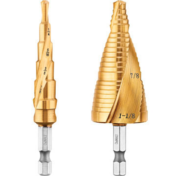

Ive drilled the frame, its pretty easy. Personally, id hit up Harbor Freight and buy one of those step bits. Drill your first hole with a smaller bit and then use the step bit.
Itll go a lot quicker.
Junk. It'll be burned up after hole 1. I was riding with someone once and they said "hey lets run over to Harbor Freight real quick." I said just pull over and let me out here. This is simple stuff. Drill the hole with a good 3/8" bit, done.

Actually I bought a few of those and they work great and have drilled alot of holes :haha:
I drilled 16 3/8" holes with one today in some 1/8" or so steel.
Drill speed is everything...too much rpm will dull a good bit before you finish the first hole. Those step bits work good, but same deal. Gotta keep the RPM's low.

FWIW I've been using the dewalt stepped bits and they seem to be pretty durable.
