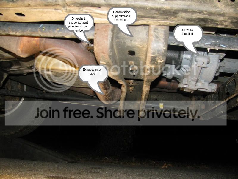

I built one in the middle East years ago.
Used a 10 bolt 8 lug front and d60 rear with a 203 I had laying around.
It was a 79 chevy van and I built everything from scratch from spring hangers to cross members to driveshaft.
I still have all the plans and sketches.
I am now working on a 97.
Trying to decide if I go with a IFS I got from a 93 suburban or sfa with the 10 bolt I have.
Either way I will have a 241 tcase and plans are 31" or no more than 33" tires
I have a buddy who has researched this quite a bit. He wants to build one but wants something newer than the 70's vans you usually see, and on a budget. He said that the reason all the late model 4x4 vans are fords is that the gm van crossmember is difficult to work with. Lots of fab work to make it all clear on the gm. The Quigley 4x4 vans are fords. It can all be done, just lots of fab.

70's chevy van which went all the way to 95 can work just fine with a sfa.
Remove front suspension, cut the bottom part of the crossmember which now is only supporting the engine and the pumpkin tucks right in the gap of the crossmember.
I am working on the 96 to present version.
I really would like to do the IFS but I am trying to use coilover instead of the torsion bar.
