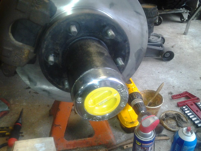

Hmm so this is what it is supposed to look like inside? So just the manual hub splined unit goes in with the large split ring around the inside diameter then the cap bolts onto that and that is all?
Looks good. :waytogo:

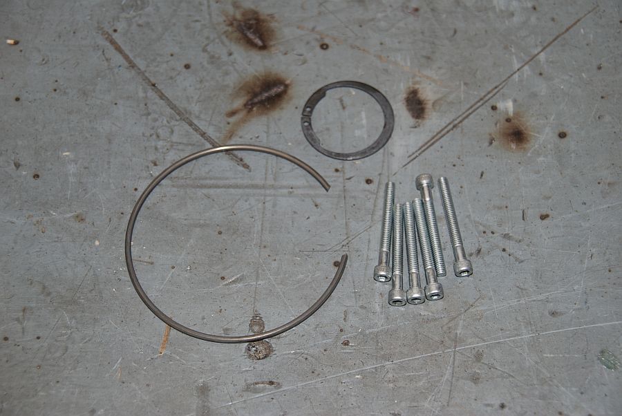

And if you put a slight inward bend on the ends of the large hub retainer ring you won’t need a dental pick to fight to get it out.
This is the one I’m referring to. You can see it installed outside the hub a few pics down in this thread if you look carefully.
