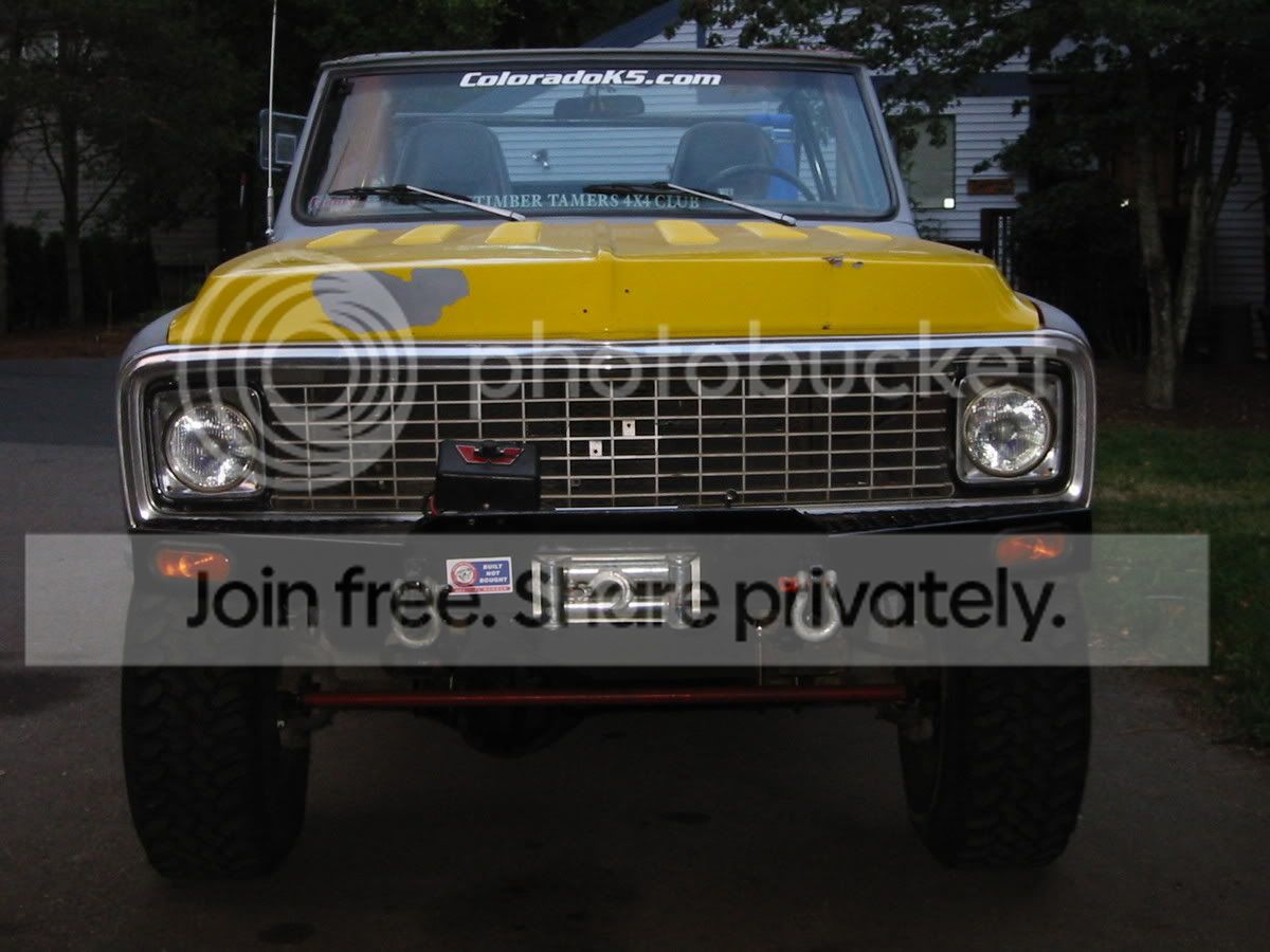

here is the front that i made.
can tuck a winch in behind and use the tubes as a fairlead, clevis tabs are 3/4" plate that is also the bumper mount, run right through for max streangh, little fender protection, light tabs just added a cb anntena mount, and of course the ck5 sticker adds at least 10 if not 15 HP!

looks great! but whats up with the headlights? that looks sick! Did you just take some from a 90 and fab them up sideways like that? lotta work? any extra wiring?

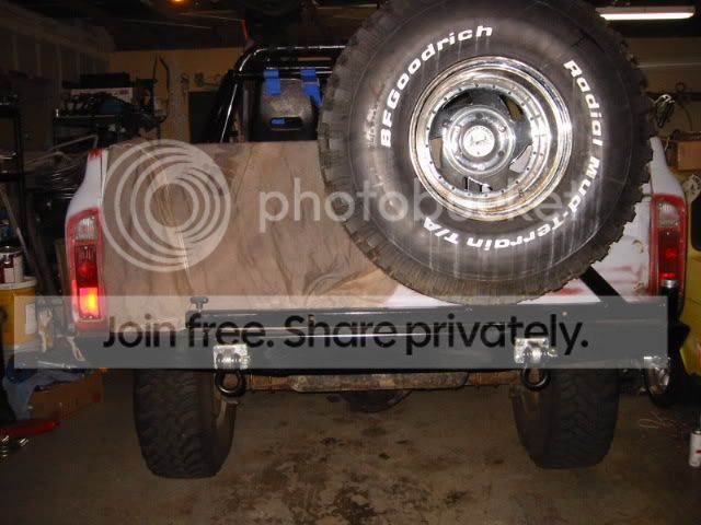

Rear is my own design.....
Front is a KMA bumper that I moved back and up so it would be closer to the body. Chopped and capped the ends for a cleaner look.
the "head lights" are flood lights with tw bulbs in each, two on each side, they are my low beams and i use the spot lights for highs, and the yellows for fog and snow (they really work)
i will be up gradeing to some name brand 8" spots for my new bumper.
all my lighting ( heads, spots, fogs, guages, and parking light) are all controled by this switch box I custom made, all 30amp relays.
