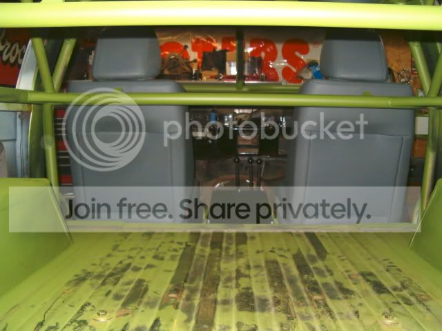

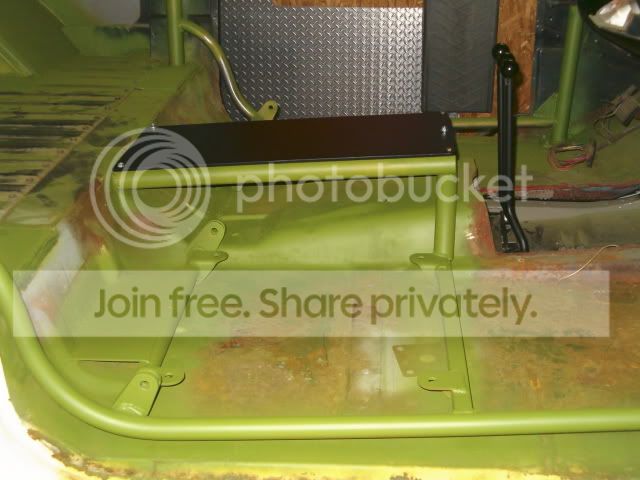

here are my mounts....
front lower mounts

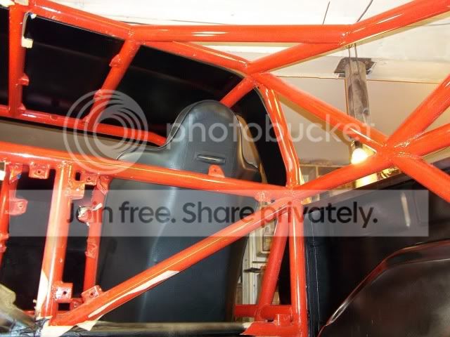

here you can see the shoulder mounts....should be about 4" below shoulder height.

Actually Eric figured all that lower mounting out when he was here for build week 2011!
I couldn't find any pics of mine but pretty much the same as Paul and Dave.

I have 2 seperate shoulder belts unlike Pauls and they would move a bit ( I don't have fancy seats just some stock grand cherokee seats) so I just used some solid rod barely enough off harness bar to keep them from moving around.
It worked really well

With the belts attached to the anchor point on the shoulder bar, it doesn't really endanger puncturing the seat back....the belts and hardware of the belts provide enough area to not puncture.
