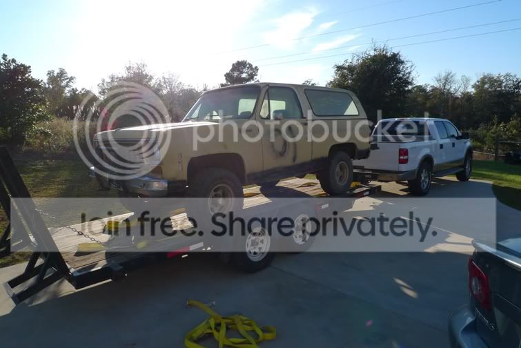

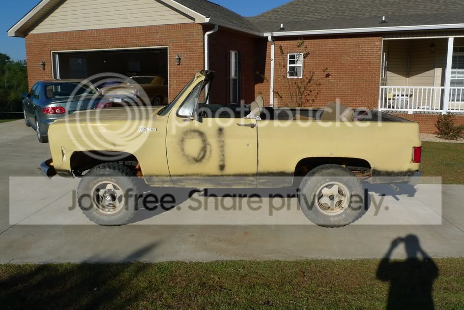

Here is the old girl as I brought her home back in November, it didn't run, and looked pretty solid. It had a 350, SM 465 and, np205 transfer case.
Bought it for $500.

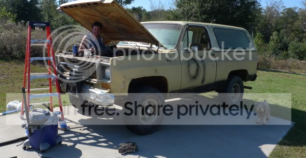

Soon found the not running problem was cause the distributor was shot, but I had an electronic one on a 283 I had, so I robbed that and the carb and intake, and threw it one. It fired right up!
She is alot more fun topless! How much you like the paint job? lol

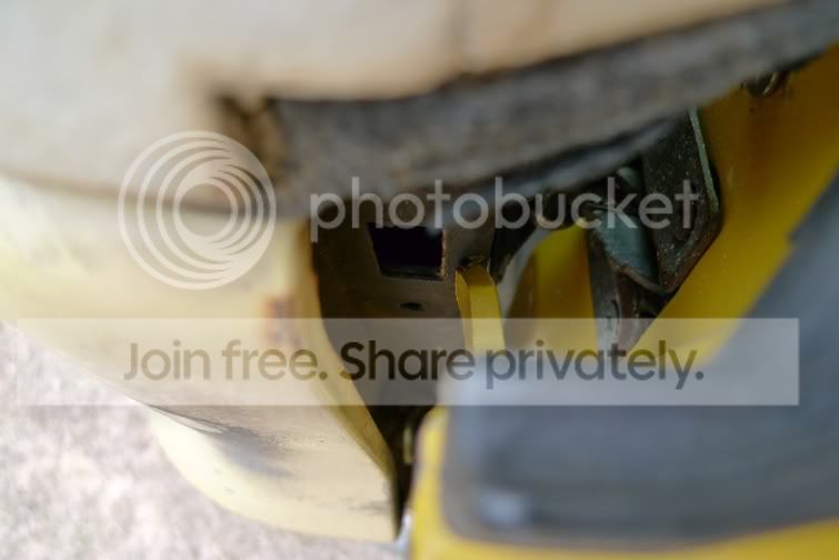

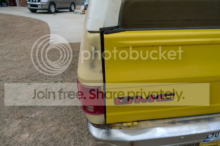

I drove it around like it was for a couple months, then in Feburary, started piddling with it. I was finally able to find a tail gate for it, the original was rusted out, and I had looked for one forever *thanks t89blazer!* But while putting it on, found out that the bed sides were spread apart, it wasn't even close to shutting correctly. Ughh, tried and tried to bring it in closer with rachet straps, no luck. :mad:
not even close on either side.

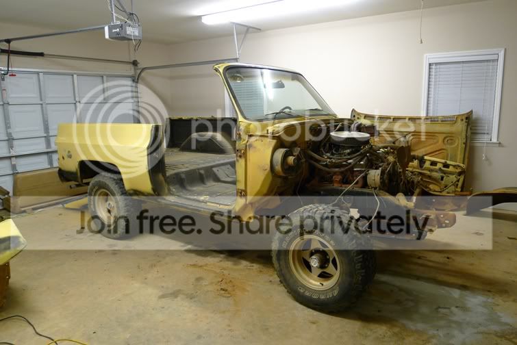

After the aggrivation of the tail gate, I said "Hell with it, today is a good a day as any to start restoring it." Which is what I had planned all along. But I had been waiting for my house to sell, still hasn't, so I would have a shop to work in at our new place when we get it. So I pulled it into the 2 car garage, and started to strip it down.
In a couple hours I had made good progress.

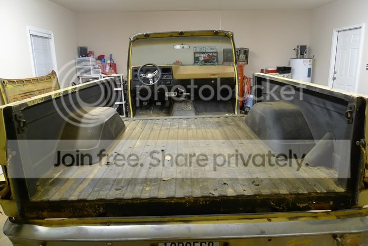

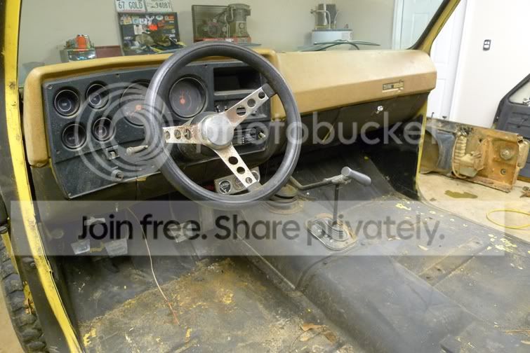

the interior, now I knew already the floor pans had rust in them, because they had riveted some sheet metal over them, but they didn't seem to bad. I was also aware of rust behind the rear tires, but other than that, the tub looked reall solid.
You can see the previous owner was kind enough to spray some bedliner crap all over everything. He even sprayed the dash, door panels, handles, etc.

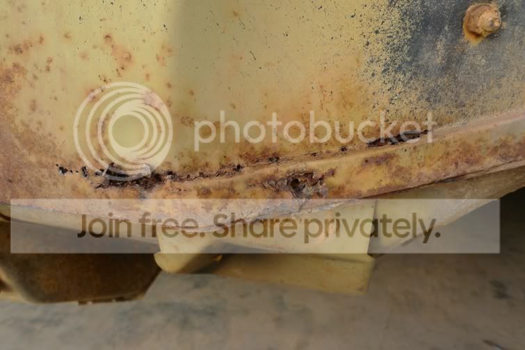

Oh oh, here is a little rust, no big deal.

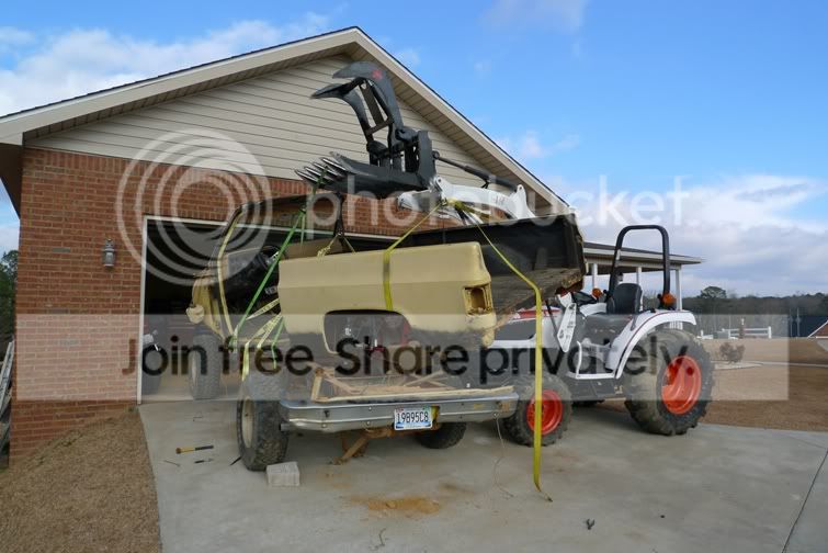

I worked all day the next day to get the body ready to be pulled off. This was made more difficult in that every bolt was rusted solid, resulting in many broken ones and busted knuckles, or quality time with the Sawzall.

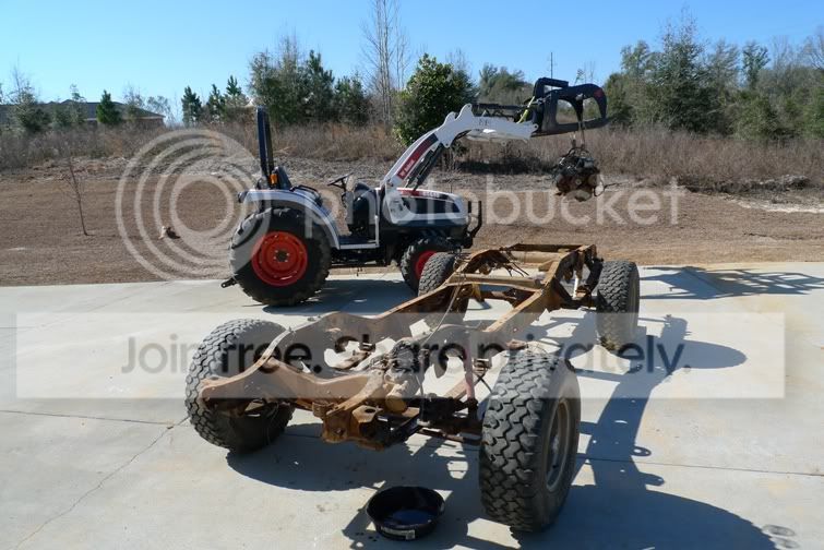

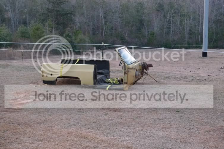

Pulling the body off. I don't know what I would do with my tractor loader. :D And man, this thing is tricky to balance.
We then had this
And this laying in the yard. Moving right along. The only problem is that while lowering it down, I was pulling it away from the tractor hood as the wife lowered it down, then she went a little to far down and bent the windshield frame with the loader. :doah:Luckily it didn't break the windshield.

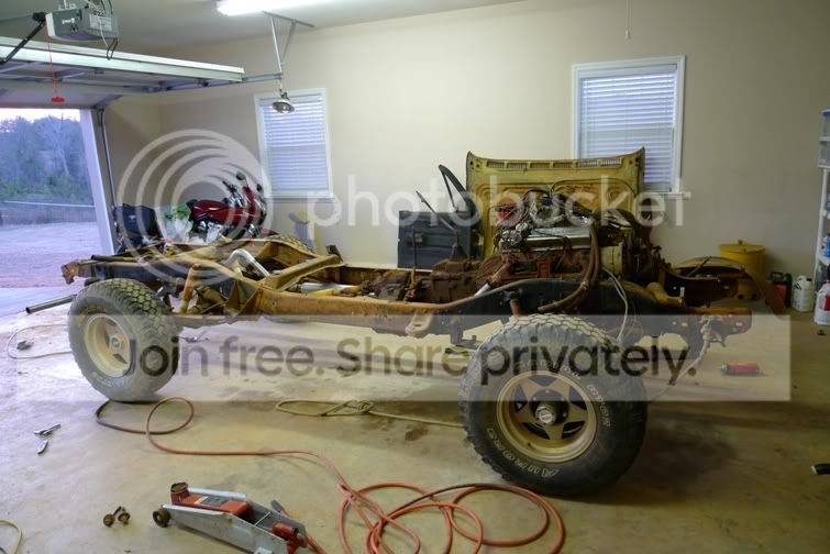

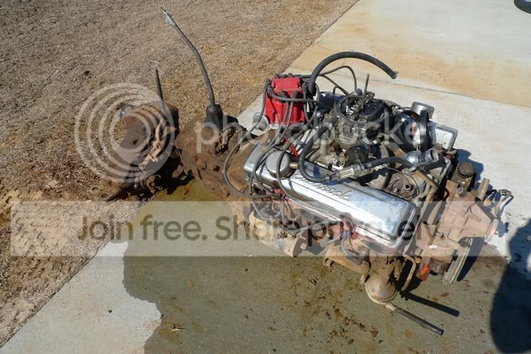

The 350 had been supposedly rebuilt a few years earlier, but wanted to pull it apart and check it out, and also new seals and stuff in the tranny and transfer case.
Did I mention I love my tractor?
Thats the old 350, and that hunk of grease and mud behind it is a SM 465 4 speed, and NP 205 transfer case.

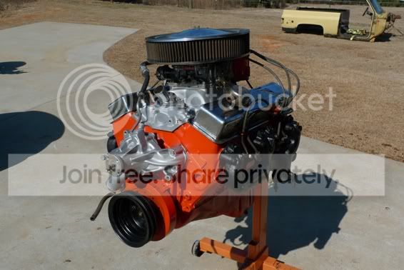

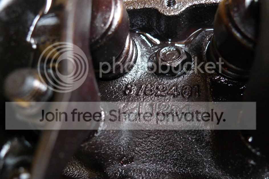

But I tore my engine down the next day, all looked great there, and was even suprised to find the true high-po camelhump heads.
I did a quick, mild rebuild and had it ready in a day or two. Nothing fancy, I plan at some point int he future to do an LS fuelie engine swap.

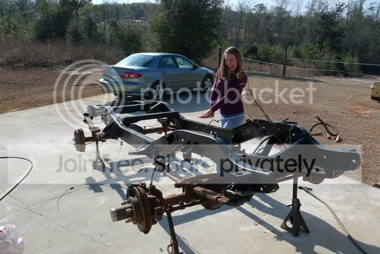

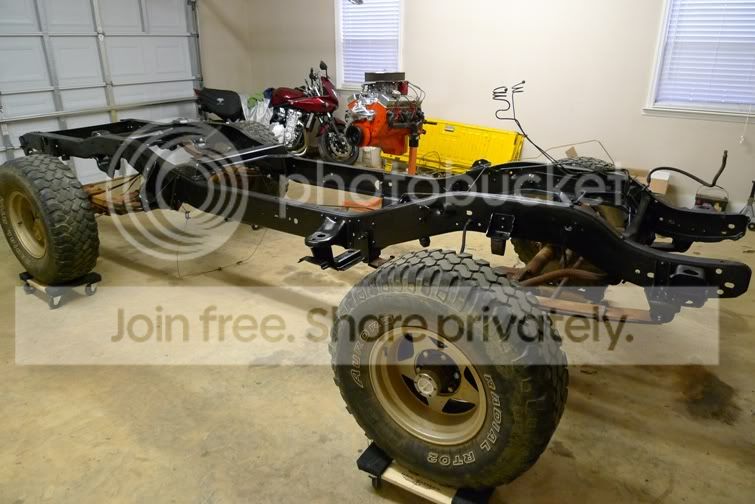

Next, I blasted the frame using my very crappy HF sandblaster. Then painted with a couple coats of Rustoleum primer and then a couple coats of paint. Nothing fancy here, but seems very durable. This won't be a show truck, nor a rock crawler.
My lovely wife posing with the completed frame. Notice I didn't do the axles. I will do them when I pull them when the suspension lift goes on. While prepping the frame, I found where the sway bar bushing mounts were both cracked. I welded them up, and while I was at it, I added the reinforcement plate for the steering gearbox area.

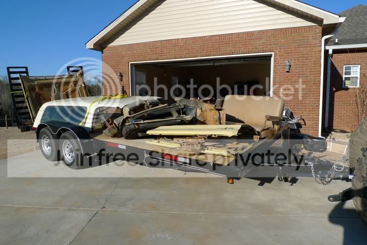

But before I could put anything else in the garage, I had to make some space, so I had to haul out the junk I stripped off so they could wait patiently in the bushes til I was ready for it.

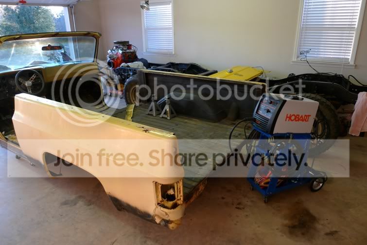

Well, I rolled the frame out of the way, and got the body back in the garage. Time to see what kinda work I had ahead of me. I knew the truck had a few rusty spots already.

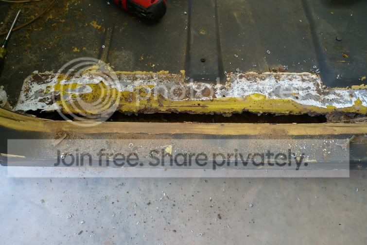

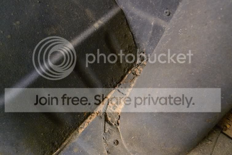

I pulled up the riveted metal on the floor. Drivers side. Turned out the rocker panel as all bondo as well.
It was in the process of working on pulling off the riveted piece that I stuck a peice of metal in my hand between my knuckles, and it went all most all the way thru. That isn't good! It didn't really bleed though, but anyway, off to the ER to get 7 stiches. My wife is a RN and needed a ride to work anyways. lol
if you were closer my dad designed a tool to pull the bedsides together, works really well. Good progress thus far.

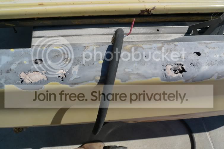

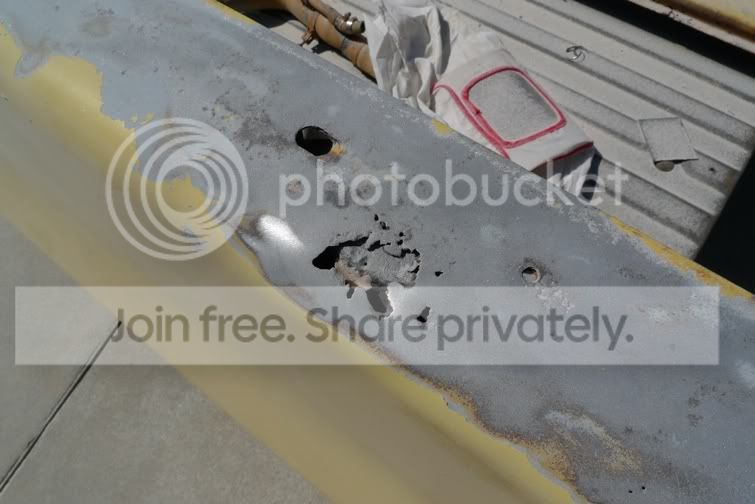

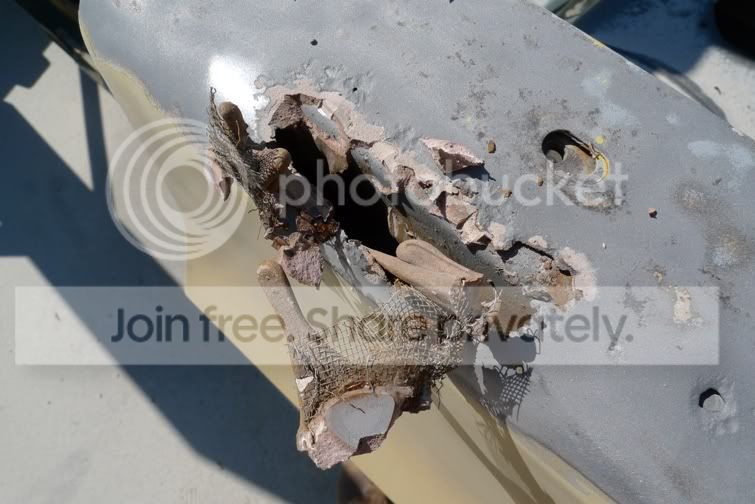

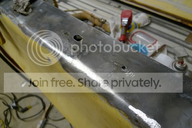

I found a some bubbles of rust all around the bed rails where the top normally sits, it was at this time that I broke the sand blaster out again and was soon horrified at what I found.
SEVERAL different places like this, giant holes stuffed with filler. This is just a few of them. :mad:
A lot of why the bedsides lean out is at the tailpan itself. Put a 4 foot level across the back and see if the tailpan has sagged at all...I'm gonna bet that's where the problem is.
You're in the perfect situation to replace the tailpan, it'll never be easier than it would be right now. Or...you could find a way to pull it back up to straight, which will also pull your bedsides in, and then weld a reinforcing tube in front of and attached to the tailpan. A couple of burly eye bolts through the top of the tailpan at each corner, a chain between the eye bolts and a bottle jack under the center of the chain would probably get most of it...
Normally having the tailgate in place is what helps hold everything together. If you wheel or drive without the tailgate for any length of time the tailpan will sag. If you intend to wheel or drive without a tailgate I'd consider a bolt in brace between the bedsides to help.

So with the Hobart 187 Mig welder I just bought, I started off small, welding in the smaller stuff like this.
to this.

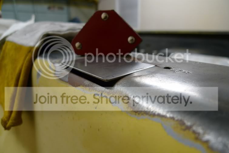

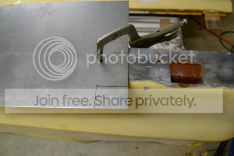

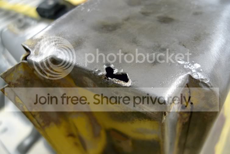

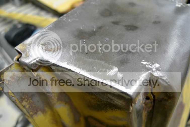

So after my first body weld job(without burning though) I was feeling good. So I just started cutting out the nearest rusty place, and traced out a patch from 18 ga steel I bought at Lowes.
You can see here, that all these rusty holes are on the bend that the bedsides make. That makes it alot more difficult, so I just went to town hammering it out on my 15 dollar Harbor Frieght body dolly set.
Welded in it doesn't look to bad for my first patch, nor for not having really used a welder since highschool ag class about 9 years ago. I don't think so anyways.
