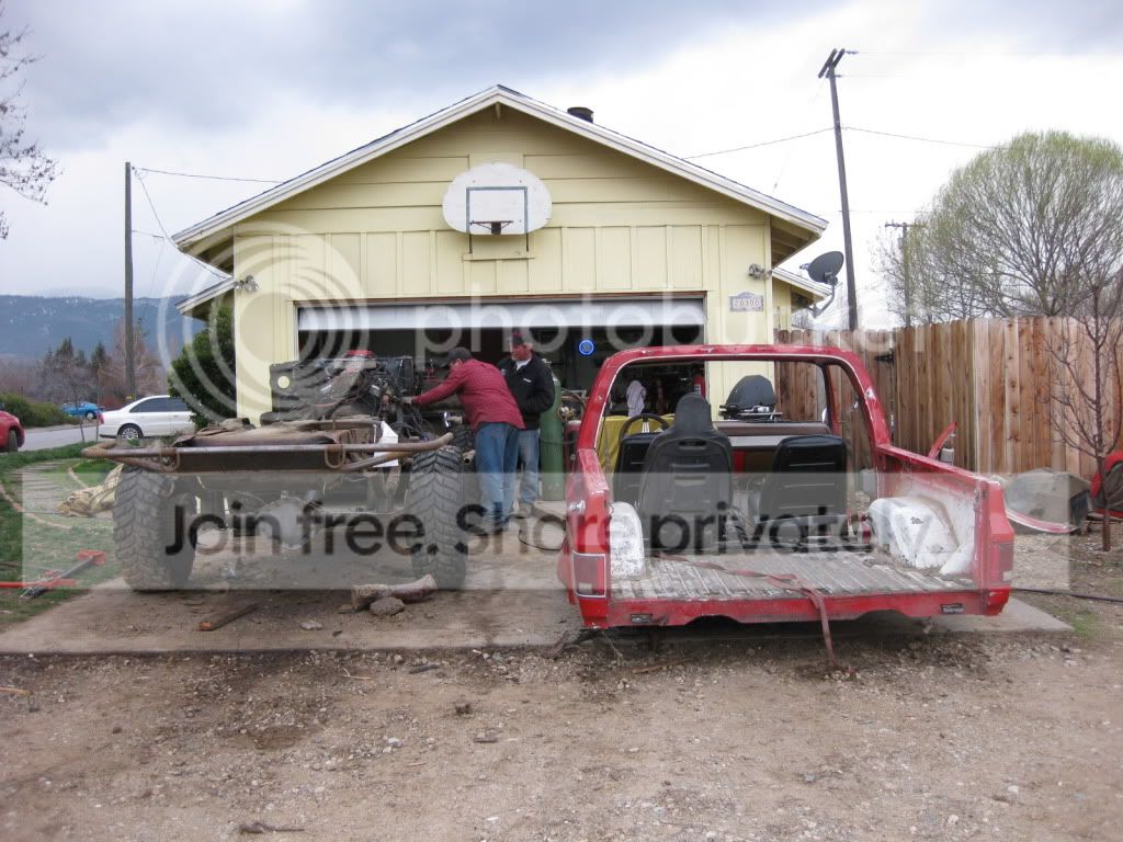

i just got done, well not done but i have the main part of the job done so far. i swaped an 82 blazer into a 77 truck.if any one has done this i would love to see some pics of the truck and of the fab work. i will start posting up pics of mine soon

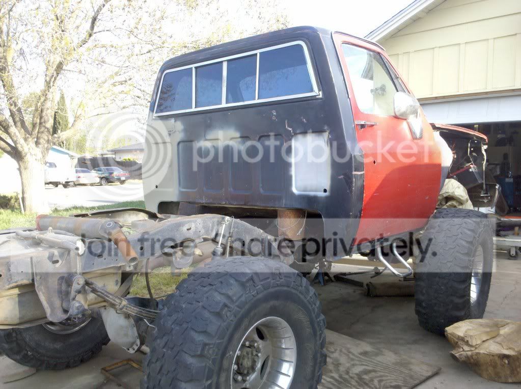

nice truck what did you do as far as suspension goes. im in the process of getting ready todo mine and looking for new ideas
Thanks.In that pic it had Pro Comp 4" springs with Rancho 9012s up front and Ford 57" springs with a DIY4X shackle flip and Pro Comp ES3000s in the rear.
To run the long springs without having to redrill the mounting holes,the shackle flip brackets are swapped side to side (right side bracket on the left and the left on the right) to off set the shackle mounting position to the rear a bit :D
It flexed nice and used to do pretty good on the RTI ramp :haha: (Springer shackle flip on the rear in this pic)

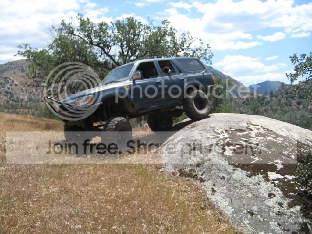

i have a 4 runner with all the mods duel cases locked frnt and rear,63" rear springs and so onhttp://www.youtube.com/watch?v=tkDAoFEjYMg. on my long nose chevy i have a 8'' super lift,i pulled a couple leafs out to help soften it up a bit. i just doesnt flex . what do i have todo to load pics. how many posts do i have to get,or do i just need to pay
You already have a built Toy,why you bothering messing with a full size :p: ?I would say you need different springs.

sorry i cant seem to find all the build pics so i will take new ones and post those later if i find them.
redneck rear cab supports hahaha
let me know andy of any pics in particular that you would like to see. i know i couldn't find hardly any fab pics when i started my build.
