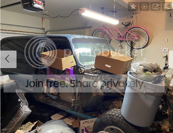

This is where I'm at:
I guess first order of business is to clean up!
