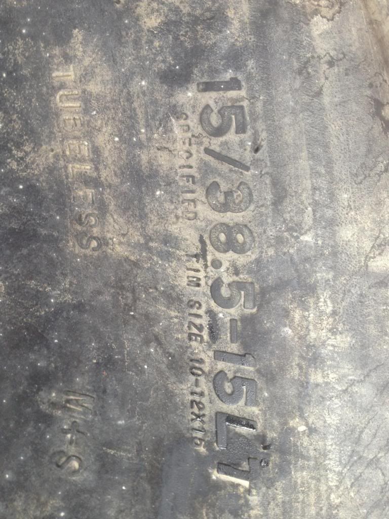

Why are they measured that way?

I never understood the random measurement order. Or the tire sizes with a single number, and the rim size???

Those are just the advertised measurements of the tire (not necessarily 100% accurate, like camshaft numbers).
15 (cross section width, at widest point of sidewall) / 38.5 (advertised height) - (dash is only separator) 15 (rim dia) LT (light truck tire)
There is no (nowadays) typical "R" because it's a bias ply tire, not a radial.
Does that answer the question or did I miss something?
No, I knew all of that. I was just curious why on some tires, such as these, they put the cross section then the height, instead of the other way around like my 38" TSL's.

I think he literally meant why is it in that order lol
Oh ok, the order of measurements. I believe that's a tire manufacturer thing, not an industry standard.
