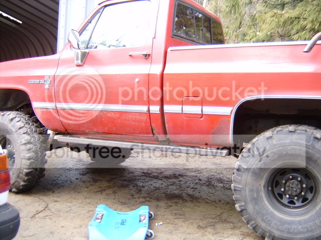

it can be done...
I stand corrected AND impressed! :bow::D
Man, those sliders look great! I was wondering if they could be mounted behind the forward rear spring hanger and over the spring or not. Looks like you did it! :crazy:
Nice job!:waytogo:

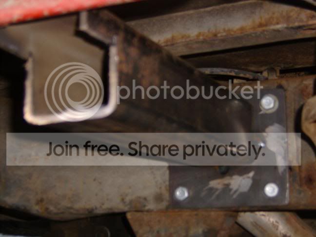

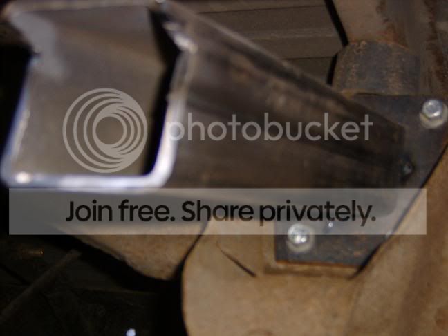

No I mounted the rear right in the middle of the front hanger bracket. Here's a pic of both mounts.
