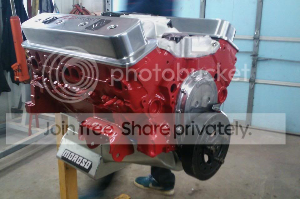

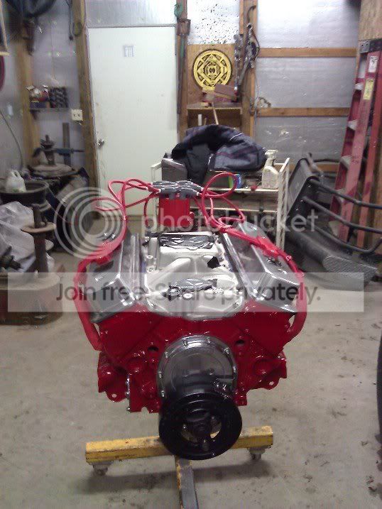

Buddies buildin a 383
I posted it on his fb page. Thanks man, hes a stubborn sob so we shall see lol
He is waiting on tbi from CFM technologies or something, then its break in time :woot:
I convinced him red would look nice :D
9:1 compression as well
with 64cc head and 12cc dished pistons 9.8:1 compression
Flat tops would be insane if you intend to run pump gas. I would say that with those Iron heads it's also going to be to high with dished pistons.
I have a very similiar build and you can even search and find mine.
I'm running a 54mm TBI with eldelbrok etec 200 heads and a lunati 60120 roller cam.
The motor is a beast and spins 35" tires with ease.
Brian at tbichips is good at tuning those motors. But I'm going to call it and say your going to have detonation problems with that motor. Going to lose major power potential by having to retard the timing a bunch.

All thats left now is to put the flywheel on and get the manifold and valve covers and such.
Another thing to watch out for because I have been there done that. That kit probably came with a 153 tooth flexplate. Your starter will not work and you will need to get a different one.
You saying the engine itself will have problems or the tbi?
And this is not for my truck, its a buddies motor for his rig, 91 GMC Sierra 2500 new body style.
I'm saying that motor with those iron tbi heads will have problems with 9.8:1 compression ratio. Will detonate on premium. I have "vortec" heads which are better with detonation and mine are aluminum which is supposed to be even better and I can get mine to detonate on premium. Mine has reasonable timing I cant imagine what crappy iron tbi heads will do.
If he wants to keep iron tbi heads I'd search for a set of 76cc heads will run a lot better.
Im pretty sure he got the pistons seperately, Keith Blacks I beleive.
What's important is how much they are dished. I think those eagle kits come with KB pistons also if you order them that way. Not much different other then the name. I'd do him a favor and call eagle and find out what he has. That motor will go boom in short order if he has 9.8:1 compression.
So its just a bad setup for the heads he is running is what your saying? Or is it just a bad setup in general?:dunno:
What he is getting at is with that piston/head combination the engine will have too much compression to run on pump gas with out retarding the timing. If you have to retard the timing to get it to run without pre-ignition problems it will run crappy. And thats retarded:D
You either need a different head or different pistons to lower compression.
