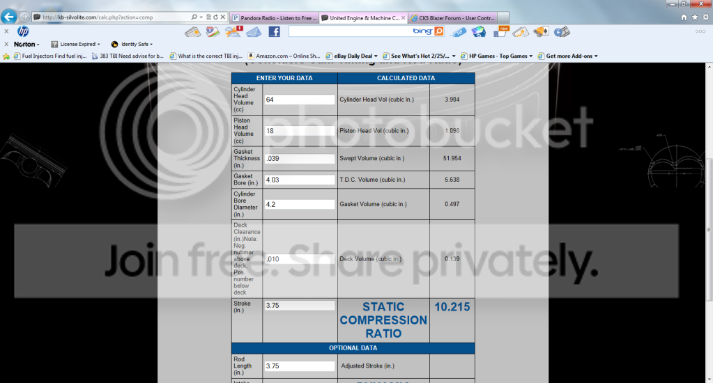

Next, with your numbers in my calculator I get 10.09 static, 7.79 dynamic (using 69 degrees advertised closing point)
With the KB page I get 10.09 static/8.17 dynamic. (using 63 degrees, which is closing point at .050" lift plus 15 degrees)
So if I go back to mine and put in 63 degrees closing point I get 8.17 dynamic. So everything matches up between the two.
So this goes back to my previous discussion, at what valve closing point does the piston actually make compression? It's not a fixed point, it depends on piston speed and leakdown rate how much the pressure will actually start to rise. If you notice, the difference between that 6 degrees of rotation is 0.38:1 dynamic compression difference.
There is 21 degrees of difference betwen the valve at .050" and the valve at .018". Assuming linear closing (its not linear, I am just making it simple for that .032" of valve travel to avoid looking up calculus I haven't done in years) that means its ~ .0015"/degree for that short peroid. Which means 6 degrees before that is .009", or the valve is open ~.027". I think if you open the valve .027", leakdown will be horrible, so in my opinion, the advertised duration is a better number to use.
Of course its more complicated than that depending on piston speed and and valve efficiency at the closing point. So I guess my point it, for what we have to work with, and all the other variables, I use the advertised duration and call it better then most.
Also, your engine may be fine with premium, depending on your timing, load, gear, temp, RPM, etc. My 489 has 8.2:1 dynamic and it runs fine on premium, although it does have aluminum heads.
Also, FYI, the Summit calculator says 10.14, becuase it assumes your gasket bore is the same as your cylinder bore (which is not usually the case). If you trick it and put in a gasket thickness that creates the same gasket volume as a larger diameter with the correct thickness, then the summit calculator matches as well. That just shows if you leave out info you get less accurate results.
