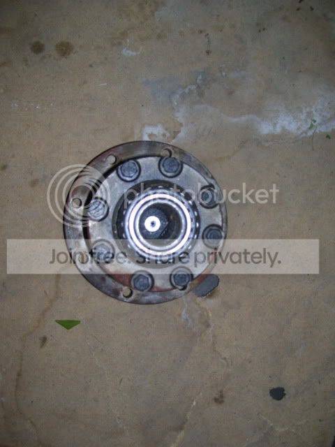

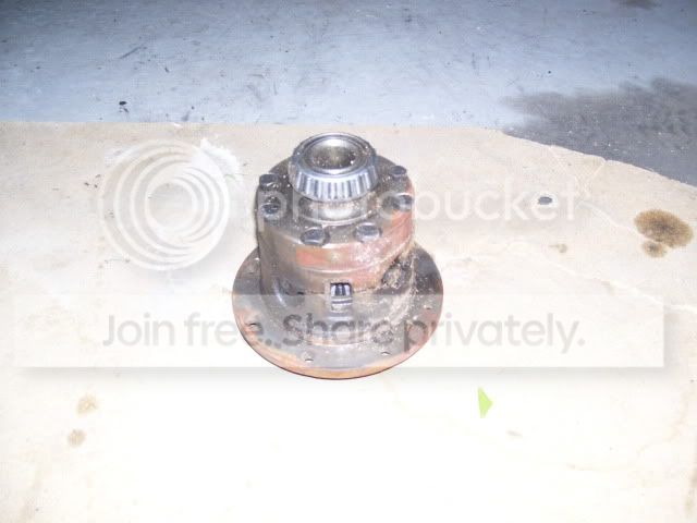

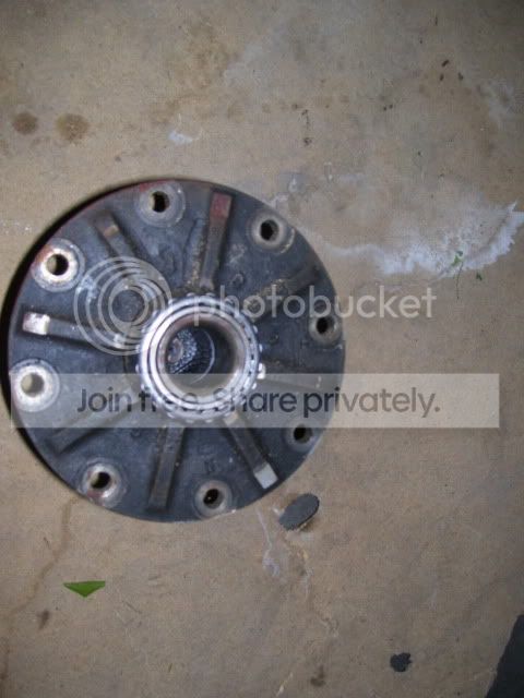

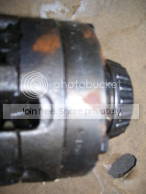

I have a power lok (precision gear) carrier and I have no idea what it is for, I looked on the precision gear website and they dont list much for part numbers and their tech support hasnt emailed me back yet. It has 3 30 68 c 26135 and 4031475N stamped on it but I dont see any other part number's anywhere?

So I take it they arent complete junk ha ha? I wonder what this thing is worth?
35 spline cores go for around 100.00 they are a very good unit to install in a front dana 60.
I don't think that is a power loc for a 60. It only have 8 ring gear bolts (Dana 44 and 60 have 10) and it looks wider than its height. There are power loc for Dana 25 up to the Dana 70 (or higher). It could a power loc for 25/28.
I'll bet that's for a Model 20. It should have 29 spline side gears.
There aren't very many of those around but I don't know if it's worth anything though. Some old boy with a Jeep might give you a few bucks for it.
