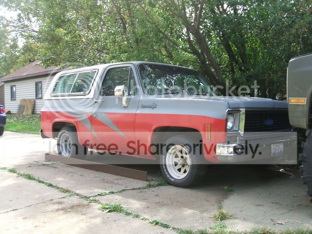

what the hell? I just sold mine for $550 last week. Anyway, get a donor 2wd truck (or burb) then you can swap the 2wd suspension (crossmember, a-arms, etc.) over to the k-5. For lowering, I would recommend drop spindles. I had 2.5" drop spindles on the truck I sold. You can also get 3" drop spindles but they wont work with 15" wheels unless you do some clearencing to the arm. Here's what mine looked like:

hey Wayne, I'm in the process of doing this to my 68. but mine is gonna be SLAMMED.
using a 81 crossmember and a arms, but 72 spindles so I can run the 88 to 98 6 lug light 3/4 rotors so I dont have to swap the rear axle.
Muddytazz mod'd the crossmember for me so it sits 2" higher in the frame. you can see my lowered front spring hangers still on the frame from it's K series past,LOL. also the front crossmember has since been removed. My crossmember in the pic is about 4" forward. I had to remeasure as I had the 4x4 stuff forward to clear the HEI on the firewall, it has since been moved back properly.
