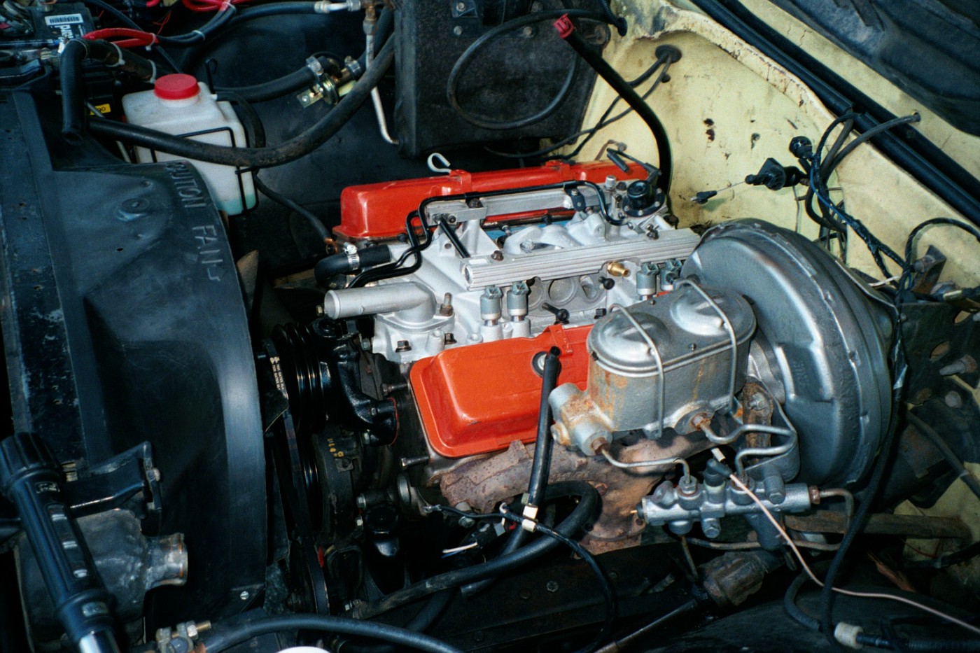

T/C is in the stock postion.
I moved the Eng. forward.Just redrilled the holes for the eng. crossmember.
Actually I think a few of the existingg I-6 mount holes lined up.I remember only drilling 2 or 3 new holes.
One thing to consider when moving the eng forward is the fan.
If you run the orig. mechanical fan the move forward will place the fan "deeper" into the shroud and may effect your cooling capability.
Before I swapped in my electric fans I found a 2 piece fan shroud from a 70's-80's Chevy truck.It was a bit thinner than the orig. Blazer shroud.
The new shroud allowed the fan blades to be approx. 1/2 in and 1/2 out of the shroud...which it what it should be.
In this pic you can see the shroud I used.
Good tip. My radiator is already very small so a bigger one with electric fans would be nice. It's always hot here.
