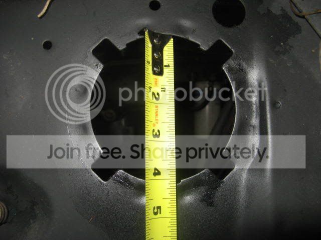

Okay, finally got around to this. Looks like it's 4" wide. Rene, happen to know if yours would fit? Expect a PM in a moment.
The little one I have will almost drop right through the hole so it's a definite no. Anyone want it for the cost of shipping?
The big one is a bit more oblong in shape but I think I could make it work in there by just drilling a few holes. Not really wanting to do that though.
Looks like I need the bigger one dude...
