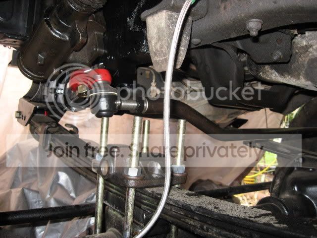

Cross-over steering hitting U-bolts... suggestions
ClevelandCruiser
Registered Member
Mar 8, 2006
87
Portland, OR
Well my crossover steering is hitting my u-bolts when it flexs' i was wondering if you guy had any suggestions on getting around this. And yes i have already cut the tops off since that pic was taken
hmm, need to read the hole post. You shouldn't have any issues with only 5/8" or so of the remaining u-bolt above the nut. How short did you cut them?
I do this all day long on aircraft stuff. all you need is at least three full threads showing above the nut, after you torque them. full compliance, good to go!
Will i be the only one to ask, purely in the interest of public safety, what kind of nuts those are? They obviously aren't the normal extra length nuts usually run, and they dont appear to have yellow chromate like most grade 8 bolts.
I hope those are at least grade 5, which would be marginal in this application. If they are gr2 or ungraded, change those before you kill yourself. Please.
They are grade 8 i wouldn't buy anyhing else. Those are stock 52 inch springs but i think i only got about 4 inches including the zero rate
I just recieved my crossover kit from NWF, the pitman arm is from Rough Country, might be able to get you a part number if you need.
call wfo and get shorted pitman arm. I broke a box with the ord/ ford arm because it hit spring. I now use jeep wagoneer arm reemed to 1-ton end from WFO
Im not sure exactly i did the 52 swap with B52 brackets in the forward most position and zero rates forward 1.5 inches. If anybody has any numbers on how far this would move it forward that would be great if not i will try to get some sort of measurment tomorrow
That explains why you are hitting, your using the zero-rates to move the axle more. Another guy on this board, Trucknutzdude, tried using zero-rates with his 52" springs and ended up leaving the zero-rates in the stock location because of this same problem.
I've got the b-52s in the forward most position and the axle is 2.5"s forward, so you are probably ~4"s forward
Ya i think im going to try a flatter pitman arm and bump stops and if its still not goin to let me flex very far i will move the axle back a little bit, im just trying to keep the best approach angle.
