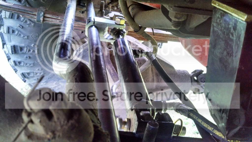

Pretty simple, how exactly are you all mounting the ram? Im assuming the u-bolt plate but I am unsure. Pictures would be great.

I have it. The cylinder is pretty close to my oil pan and I am not excited about it. I keep looking for better ways to mount it.

Can you post a pic of it? Im just trying to get an idea of how much headache I have heading my way. You have a BB correct? Im also going with the ORD crossmember to make oil pan removal easier and I want to swap in this cam I have in my bedroom and cant remove the oilpan the way it sits. Avalanche is on the way I fear.
Oh, my cylinder is mounted on the outside (toward the wheel) top of driverside spring plate. It is better than when it was mounted on the inside but still close.
This is before I moved the mount to the far side of the spring plate. The mount was low and because I have offset tierods (axle moved 1.5 ahead so the cross over and high steer rubbed) it pushed up and down on the tie rod. Now the cylinder is laying across the top of the spring plate. so it is moved over about 4".
That was my next question. I only wanted to move mine up 1in as to minimize what your going through.

80 427, where did you get that clamp on the tie rod (for the ram end)?

I had a buddy make it for me. He was going to school as a metal butcher and had time for home projects. I told him he should start making them too sell.

If he's not going to make them you should show that to Kert, the double sheer mount is way cool.
I would make a dedicated ram tower to mount it to over doing it on the ubolt plate. Ubolts like to loosen up enough as it is.
You can show who ever. It is more or less just what everyone does with a clamp and welding ears to it. My buddy has not way to mass them and in fact is selling his CUCV.

I thought about it. I may go way outboard to allow more oil pan clearance.
I need one either way so ill see what he says, thanks.
