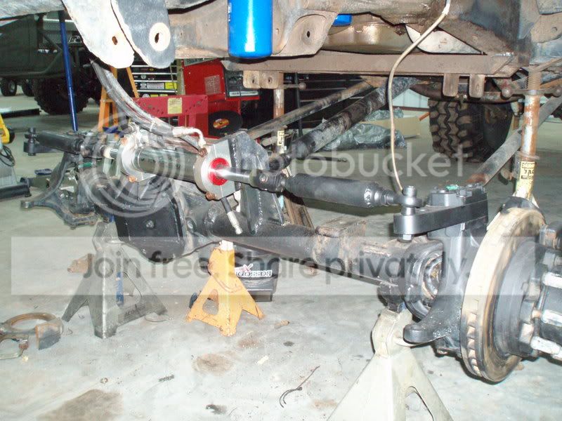

Moving it behind the axle does protect it, but the bend(s) is/are not ideal. Is it possible in your set-up to make one that is straight by moving it on the steering arms? Still on leaf springs, right?
Where'd he go?
He's not running that set up any more, he changed the knuckles and is running a double ended ram.

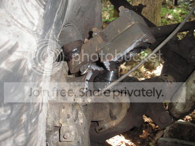

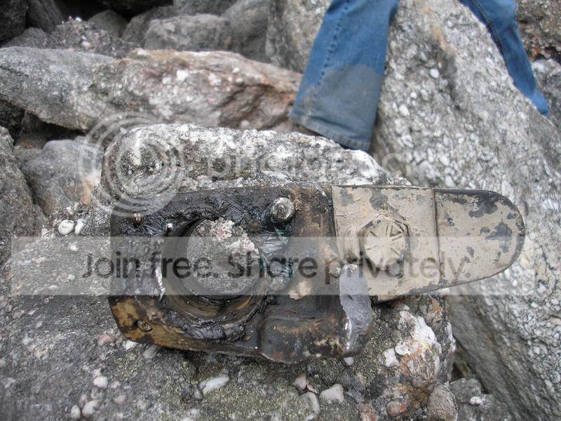

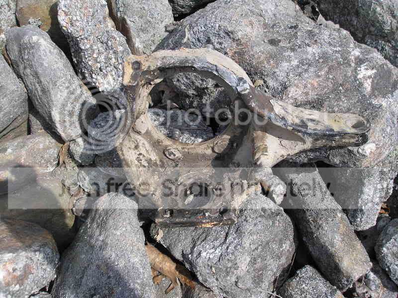

how do you explain this then. Ford knuckles are known for being the weakest of all 60 knuckles. These pics are of a Dodge knuckle. I was there for the one FOR MUD posted and this one. high steer and hydro assist puts a ton of stress on the top of the knuckle. you should be checking for cracks after every ride. its not bad castings, its using the part in a way it was not designed for.
