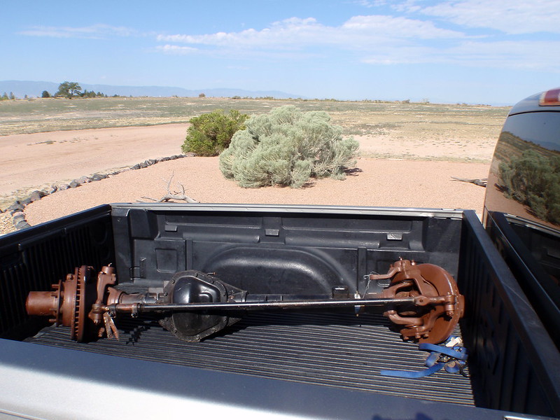

Not that Dana 60 swap threads are anything new around here but this D60 swap thread is my favorite as it is finally mine!:haha: Hell, it only took 16 years of the K10 ownership to finally join the front Dana 60 club and I probably still wouldn’t be a member if it wasn’t for Mosesburb and his well-tuned nose that tends to sniff out good deals of the metal variety. I never even noticed this axle on in the classified section or on Craigslist. For years I searched for a Dana 60 but refused to pay ~$1000 for a ragged out used axle that would have probably had the wrong gear ratio and probably would have had dual wheel hubs. But for $1200 it was too good to pass up being it was a brand NOS single wheel axle with the correct gear ratio (4:56) to match the rear. Good job birddog Nick! I guess you can say that I have joined the “74” club now (14 bolt rear/D60 front = 74) :haha:
I have to say this Dana 60 was the easiest swap for such an upgrade in brute strength. Unfortunately, this upgrade in strength also means a downgrade in traction for the K10 as the outgoing Dana 44 was fitted with a Detroit TruTrac. The D60 is currently open but hope to add an ARB to the front and rear in the near future.
Fresh out of the box
This wax paper tag was wire tied to steering arm

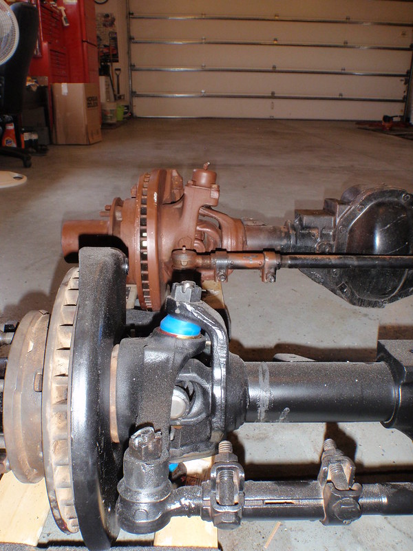

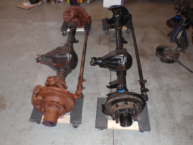

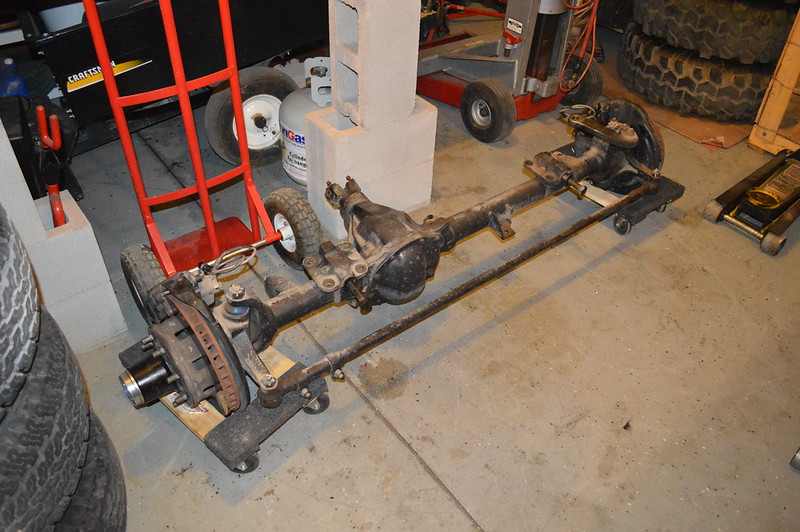

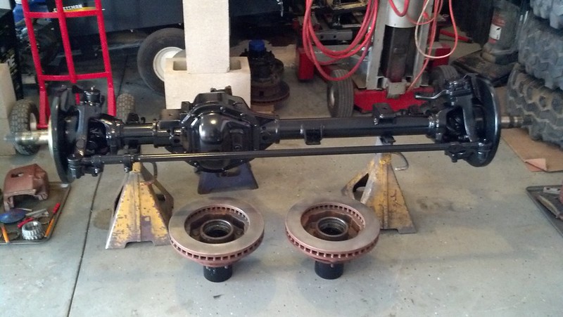

Nothing new to you guys but still a neat comparo of the D60 next to the D44 that I had just refreshed to go into the Polar Bear. The D60 is huge…and heavy!
Neat comparison picture of the D60 next to the D44. King pins vs. ball joints, different tie-rod mounting, etc. Its not everyday you find two clean axles next to each other for a family portrait

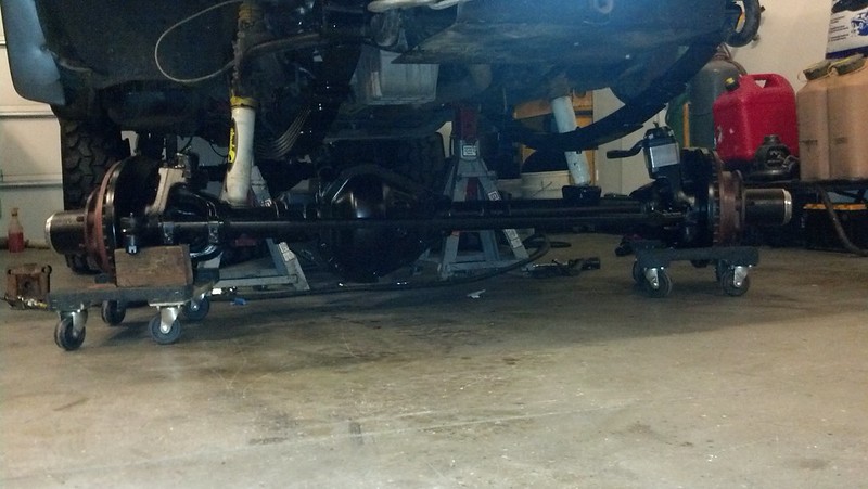

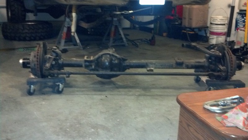

Out with the Dana 44

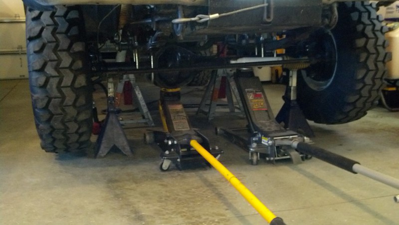

Crappy cell picture

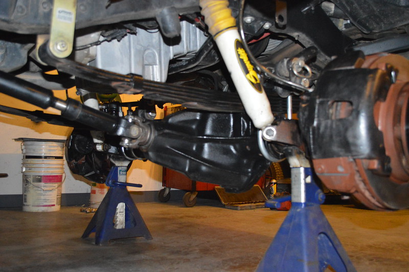

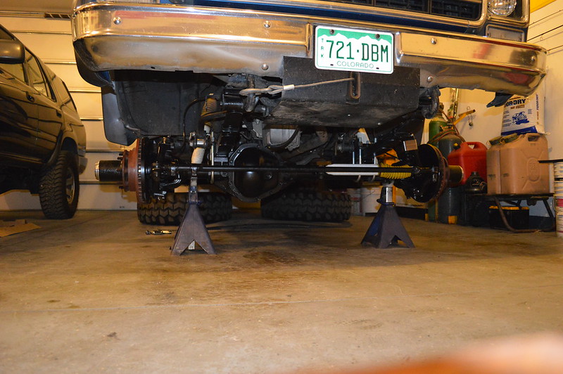

After spraying some fresh paint on the leaf springs the D60 was rolled under
Used a real camera for the rest of the picture take’n
Even the driveshaft was a direct fit. I did have to score a different set of U-joint straps as the D44 uses the flat strap while the D60 uses the Ubolt type strap.

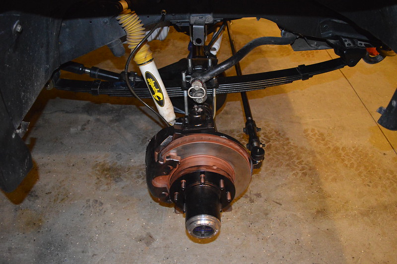

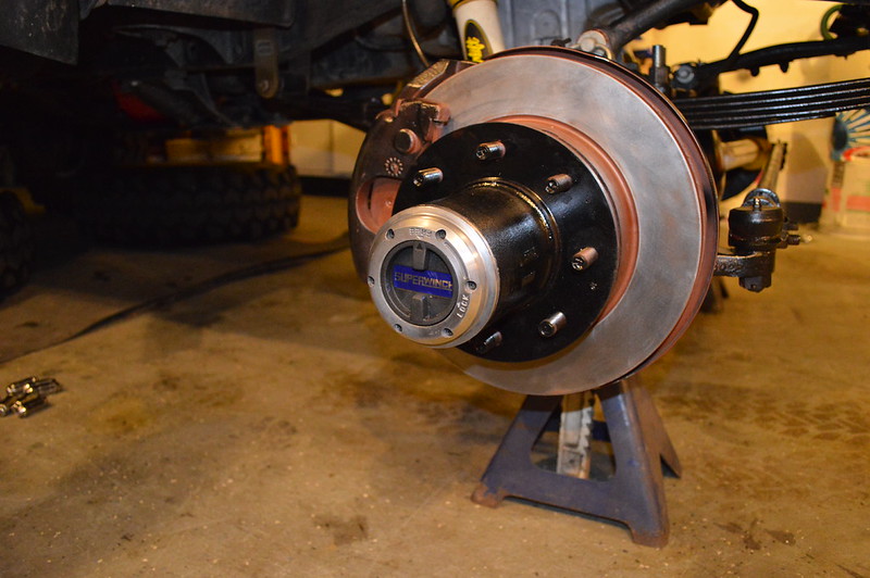

Superwinch hubs. I love these… ¼ turn to lock or unlock, durable and cost much less than Warn hubs.

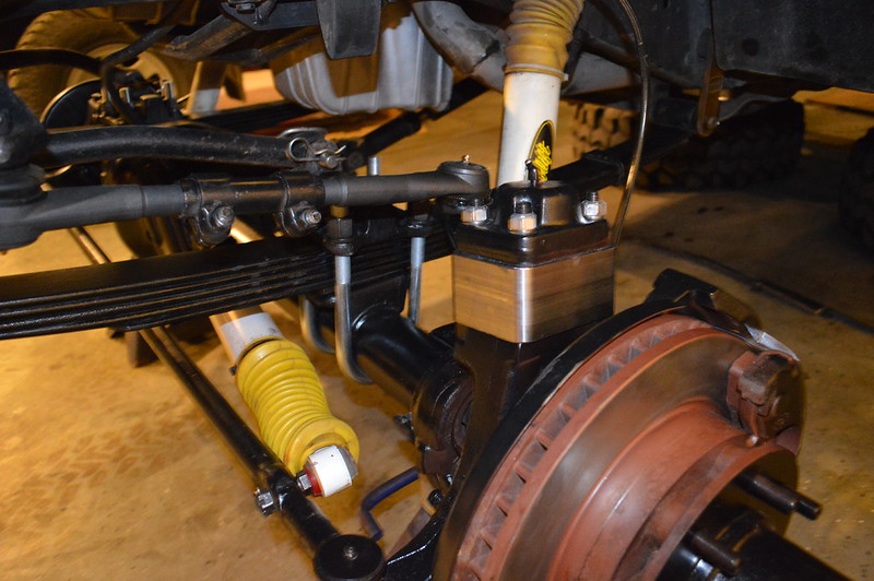

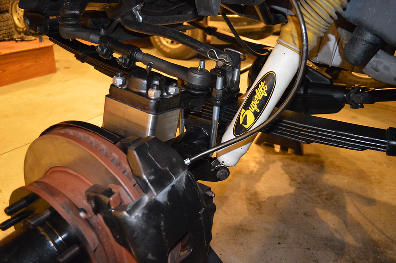

ORD raise steering arm block and brake lines. I love their brake lines!
Poor ole D44 in the corner. Anybody need a good used D44? 4:56, TruTrac’d, 2 year old ball joints and all new bearings. Actually, I am thinking of pulling the TruTrac out and stuffing it in the Polar Bear Burb now that it has a D44 in the front. I would have just used this entire axle for the Burb but the 14 FF that went into the Burb was 4:10 and I didn’t feel like spending $400 to regear yet another 14 bolt to 4:56.
All that is left is to bleed the brakes, bolt on tires, drive it up and down the street to set the steering wheel then ready for the trail. Ah, wait....will probably have to add a zero rate to the rear spring packs next as the D60 will make it sit a bit taller.

Thanks guys! I forgot to mention that I tore it down and repacked bearings and replaced seals before stuffing it in the truck. Glad I did too as that 22 year old grease was pretty stiff. The stuff even smelled weird. If anybody else scores one of these NOS axles I highly recommend tearing it down to do the same. It would be a tragedy to destroy a brand new axle stub and hub over old grease.

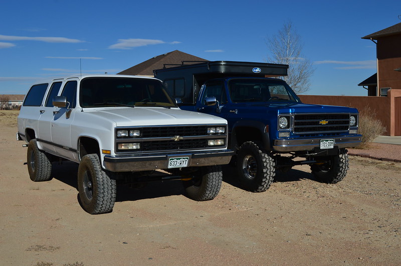

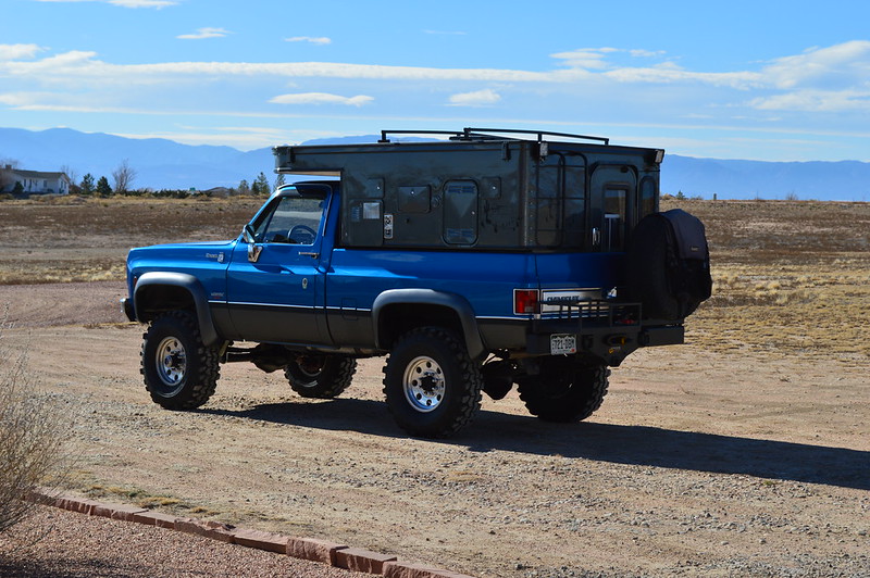

Got the brakes bleed last night and steering wheel all set then ran it to the car wash today. I swear it steers and has better road manors now with the added unsprung weight. :dunno:

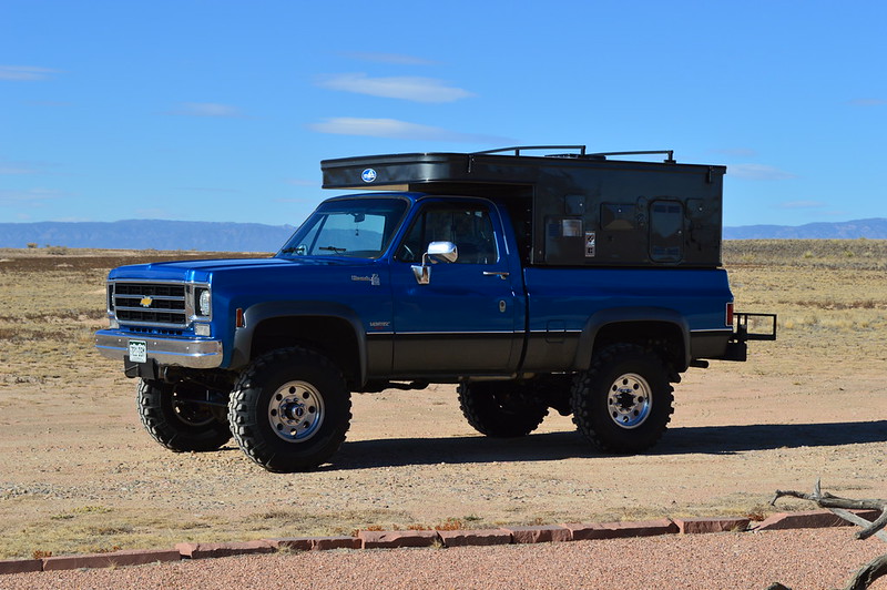

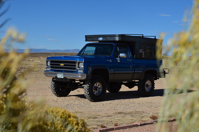

The ole dog never got a good bathing and rub down after the last fishing/trail riding trip in early October. Because I am a picture wh0re and the fact the wife got a new camera plus it was such a beautiful day it was a good excuse to snap some new beauty shots today.

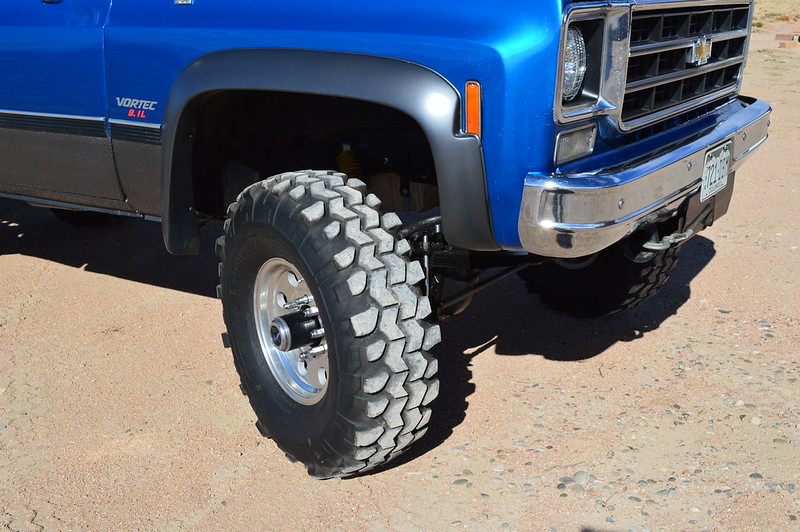

Now don’t be getting the notion just because it has shinny paint that it is just a mall crawler. Those that know me from here and other forums know this truck gets used and abused but overly maintained. What you can’t see in these pictures is the desert pin-striping in the paint (this color of blue really hides a lot), gouges in the fender flares and chunks missing out of the tires. In the pictures above you can see how the bumper is pretty beat up along the bottom :haha:

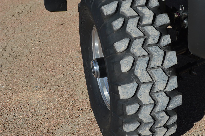

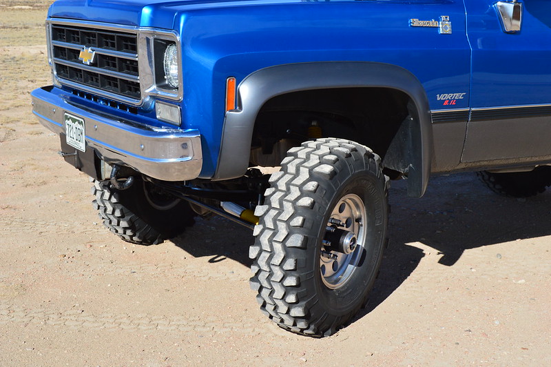

The D60 hub do stick out much further than a D44, especially with the tall skinny meats bolted on.
Looks like the next project is to get the zero rate installed in the rear as it is a bit low in the rear. Once the tanks and fridge are loaded it will really be on its ass. I picked up a set of leaf spring center pin bolts yesterday so installing the zero rates is this weekends project.

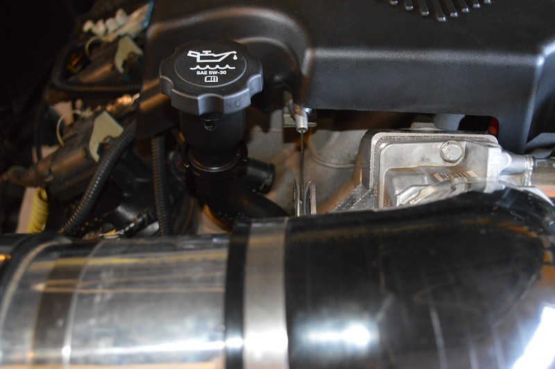

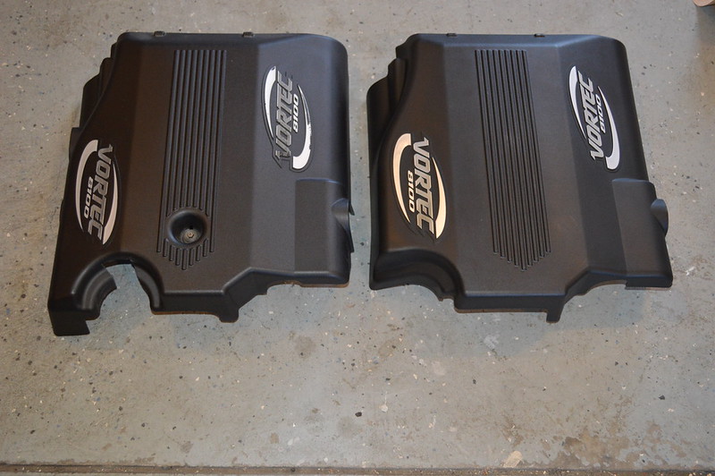

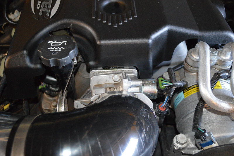

Funny how the simplest of things can make such a big difference. When I installed this 8.1L almost 5 years ago I bought an engine cover for an early 8.1L. I also did not want to run electronic throttle on this truck (I am not a big fan of unnecessary electrical BS) so I used a L29 7.4L mechanical throttle body instead of the electric 8.1L TB. Unfortunately, the clearance for the cable to bend round the oil fill tube was pretty sketchy resulting in a stiff gas pedal. In helping guy on a different forum with an 8.1L swap into his project he mentioned the later 8.1L had a different cover and oil fill tube with a bend in it which should help with the mechanical TB cable routing. I never knew that as vehicles my company builds do not use engine covers on any of the chassis we built with 8.1L engines. Man it made a huge difference! The gas pedal is much easier to step on now! Sure I could have run it without a cover all these years but 8.1L engines are horribly ugly without them. :rolleyes:
BEFORE: 2001-2003 Engine cover and oil fill tube. The cable working angle wasn’t desirable but worked fine for 15,000 miles. It looks like the cable is rubbing on the tube but it wasn’t although you couldn’t side a hair between the cable and tube.
AFTER: 2004-2010 Engine cover and oil fill tube.
Early cover on the left. Late design on the right.
Best $60 spent and 10 minutes of labor used in a while. I am sure it will be much more capable off-road now. :haha:
