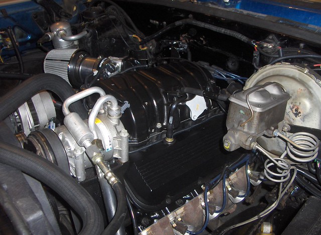

RamJet 454… Basically a 454HO with a Marine L29 intake running on a RamJet 502 ECM with tweaked calibrations. Ran like poop
