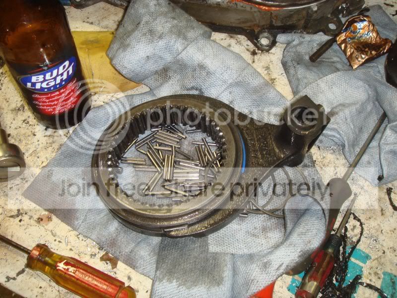

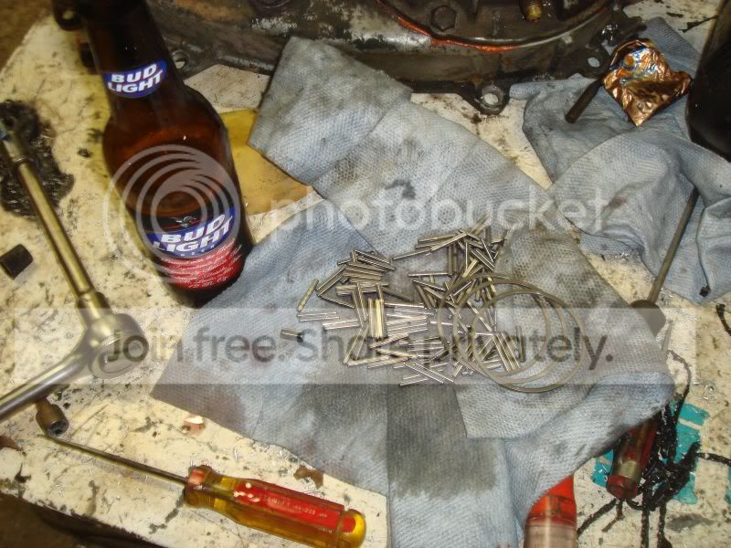

this was pretty easy. the hardest part was the frikkin needle bearings. two rows of those suckers end to end with a spacer ring.

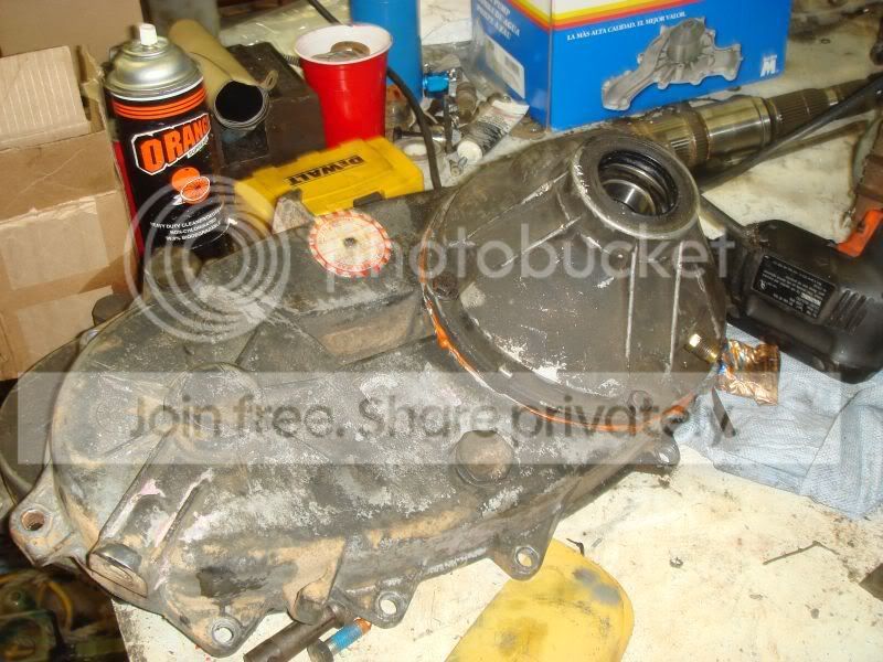

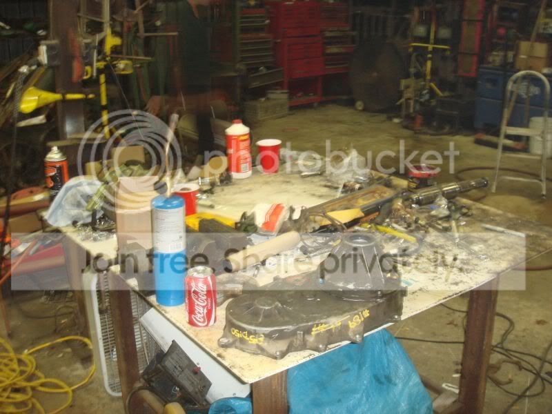

Started by making Jay clean off the bench. Then we assessed what we were dealing with.

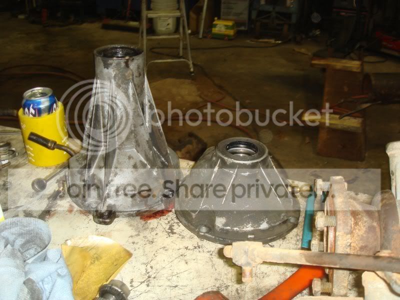

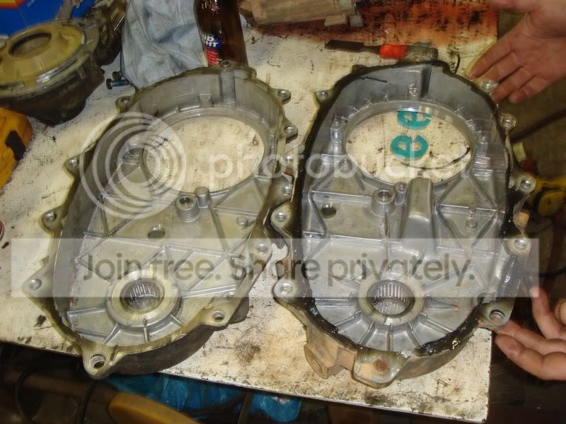

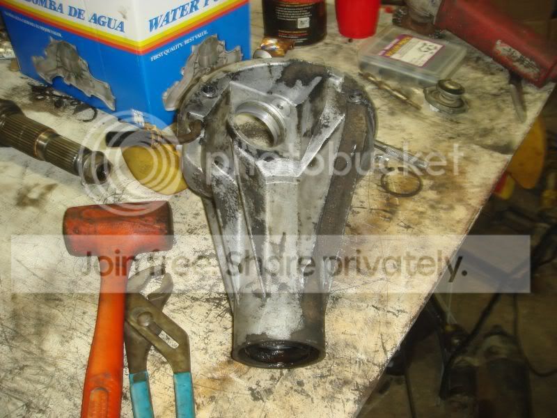

dodge back half

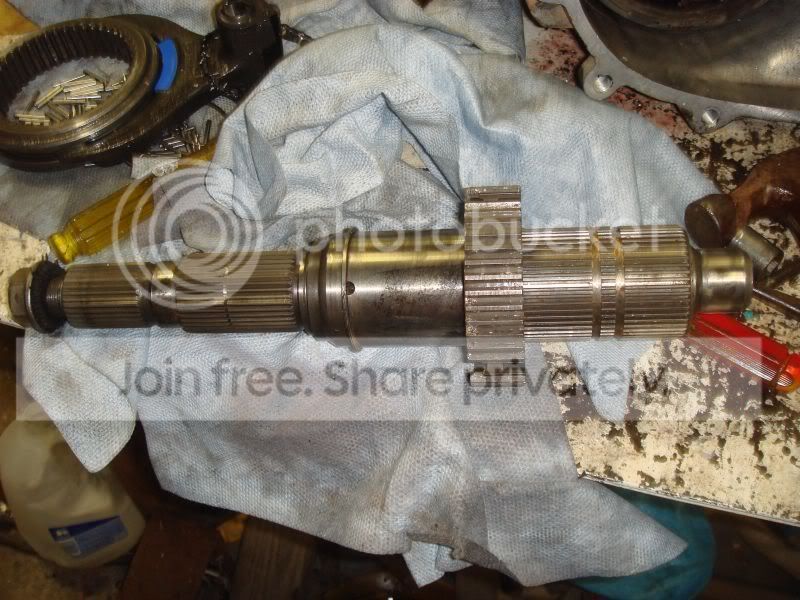

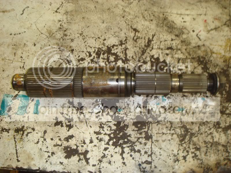

dodge output shaft

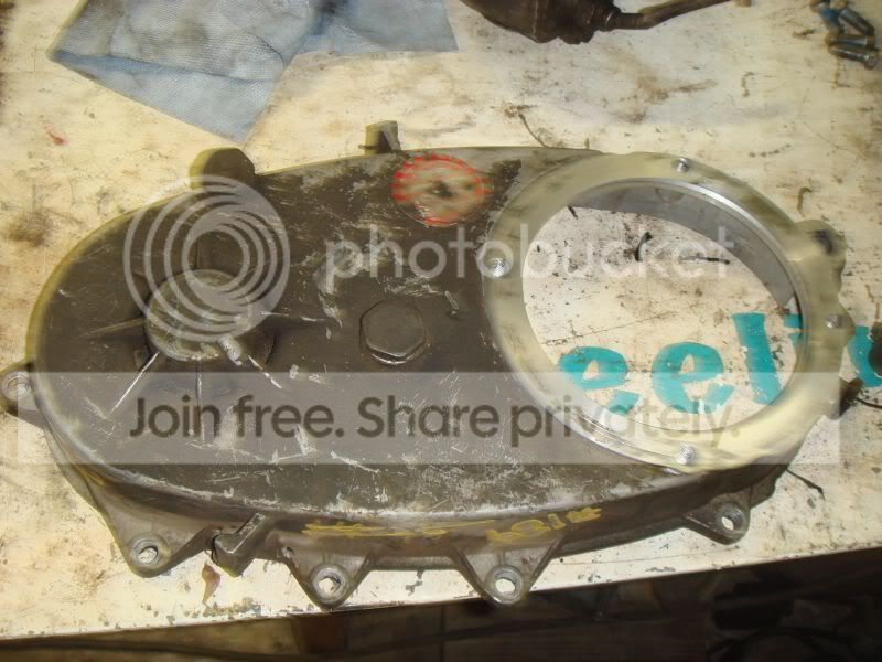

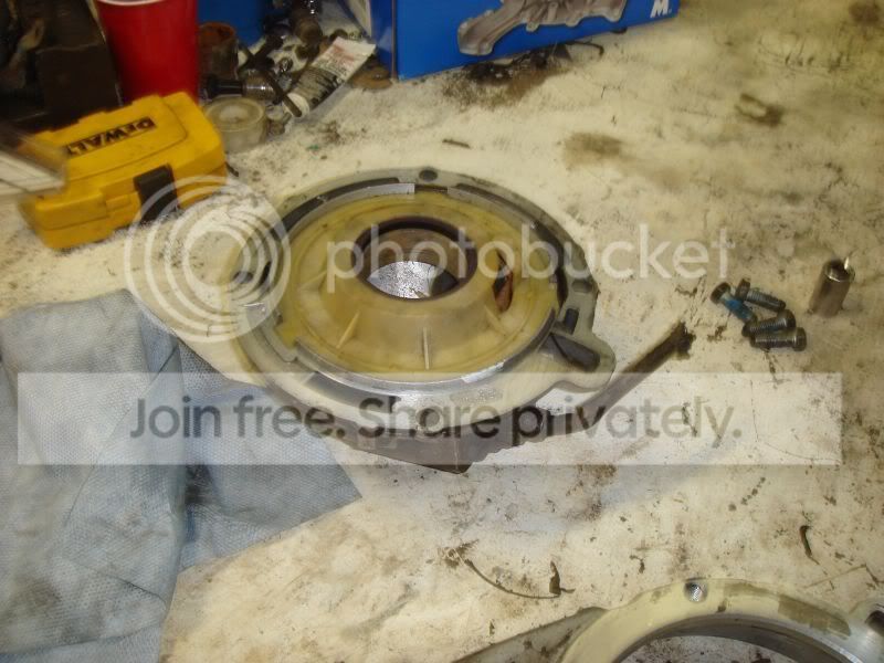

removed the cone

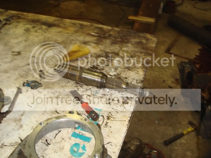

cleaned up the cover. and Jay polished the shaft. he he

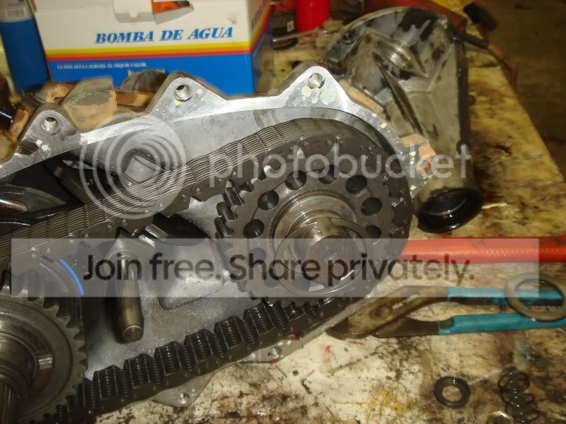

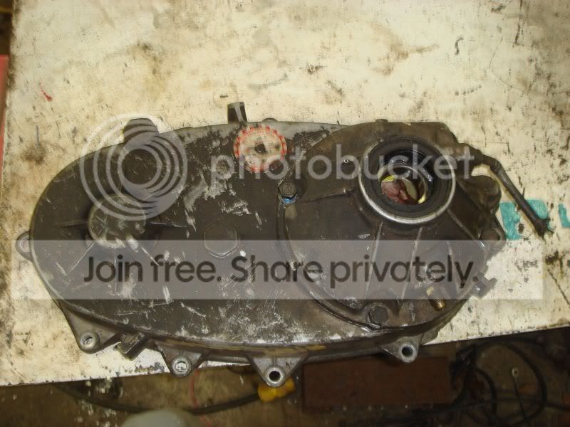

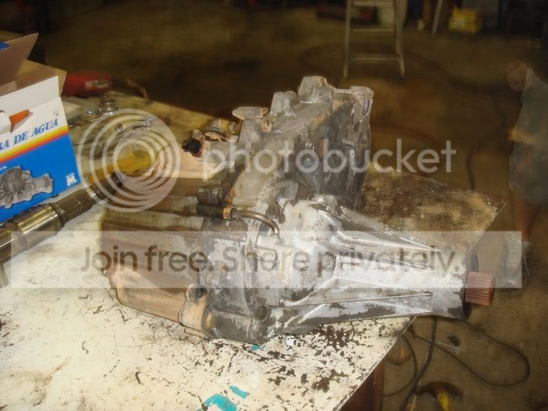

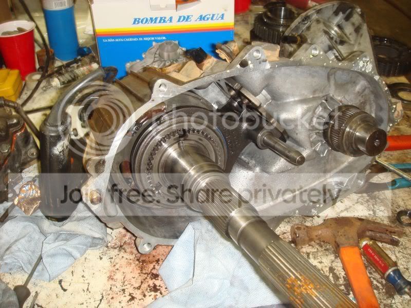

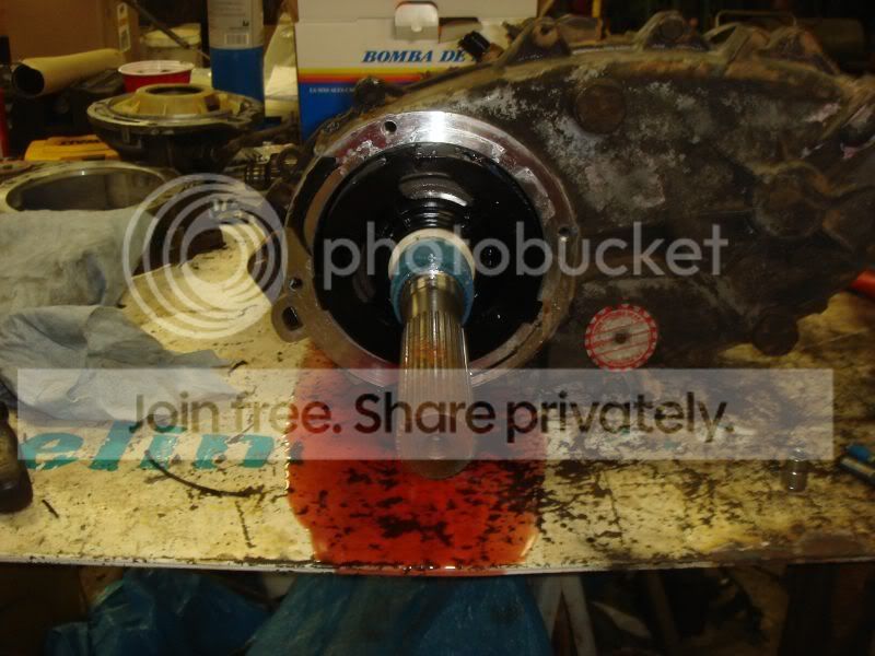

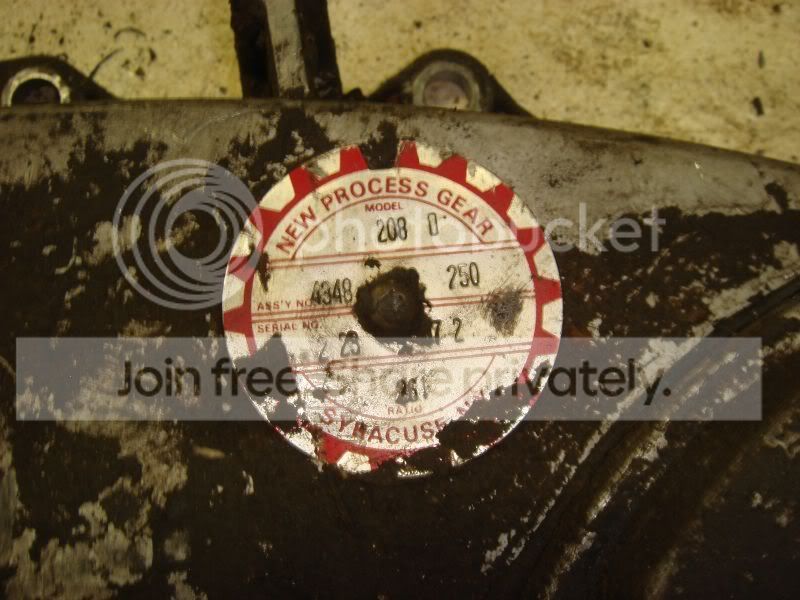

then we put the chevy 208 on the bench

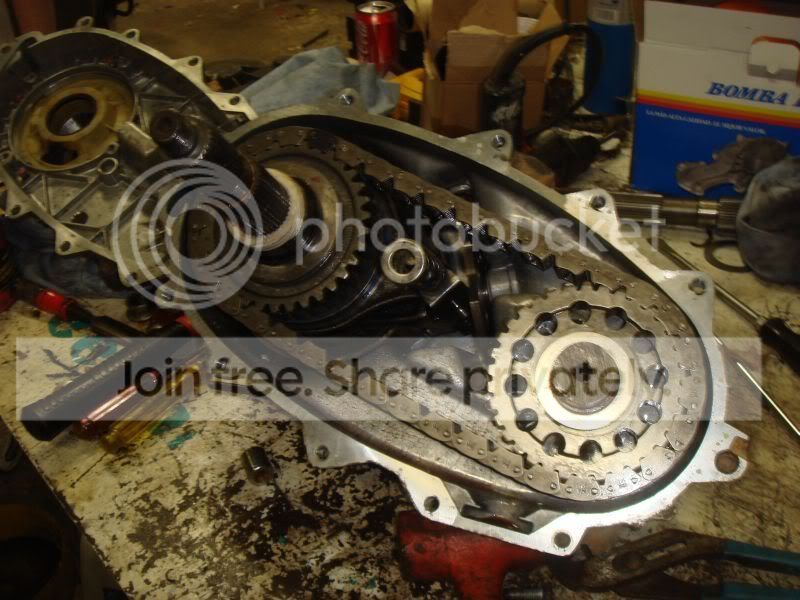

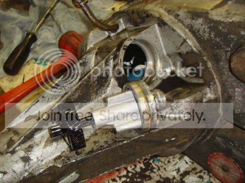

removed the spedo gear
then the cone

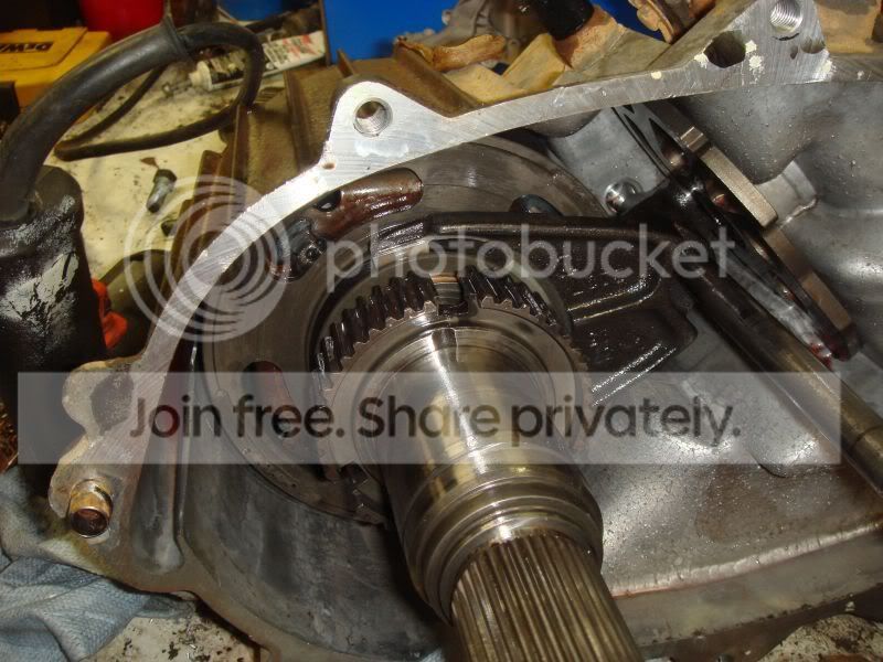

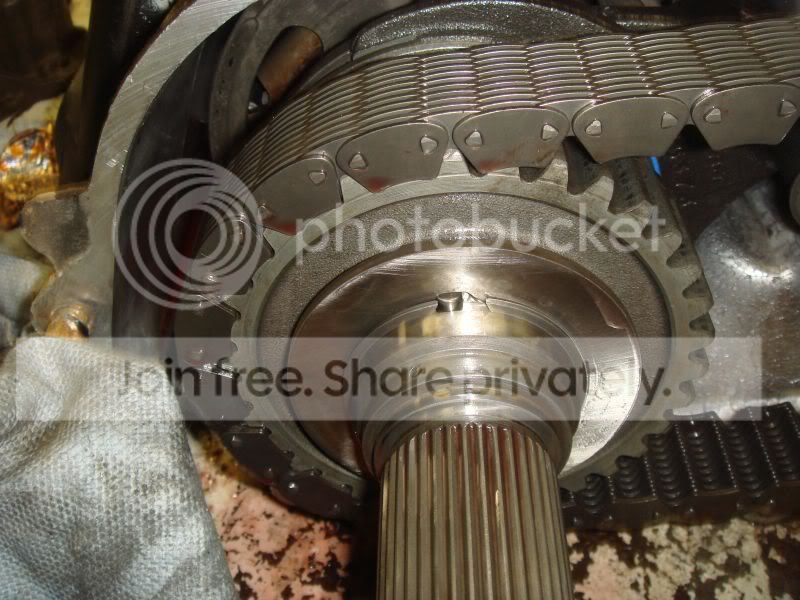

to expose the shaft

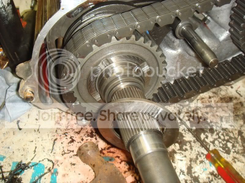

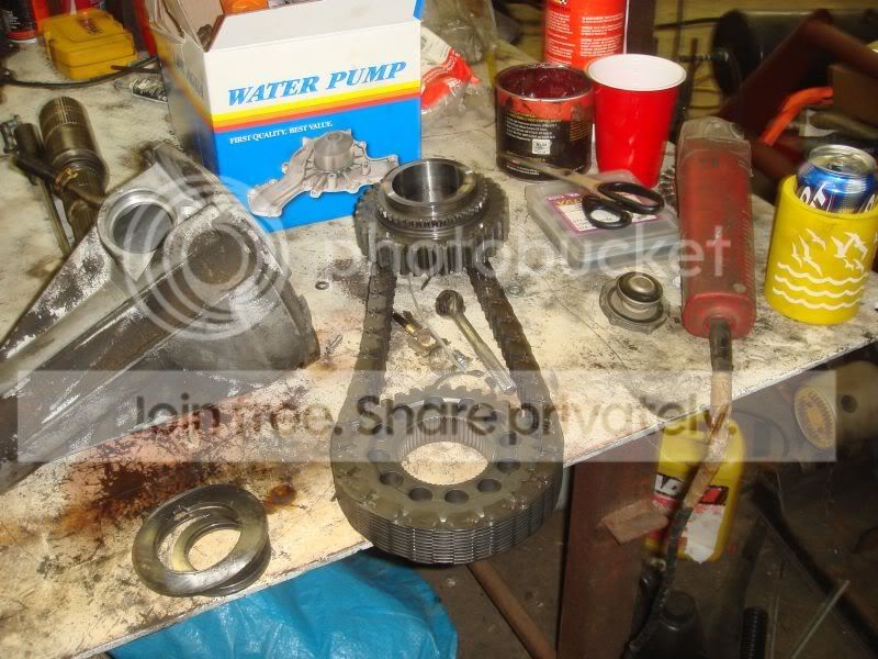

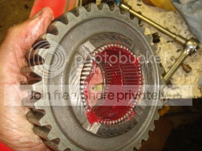

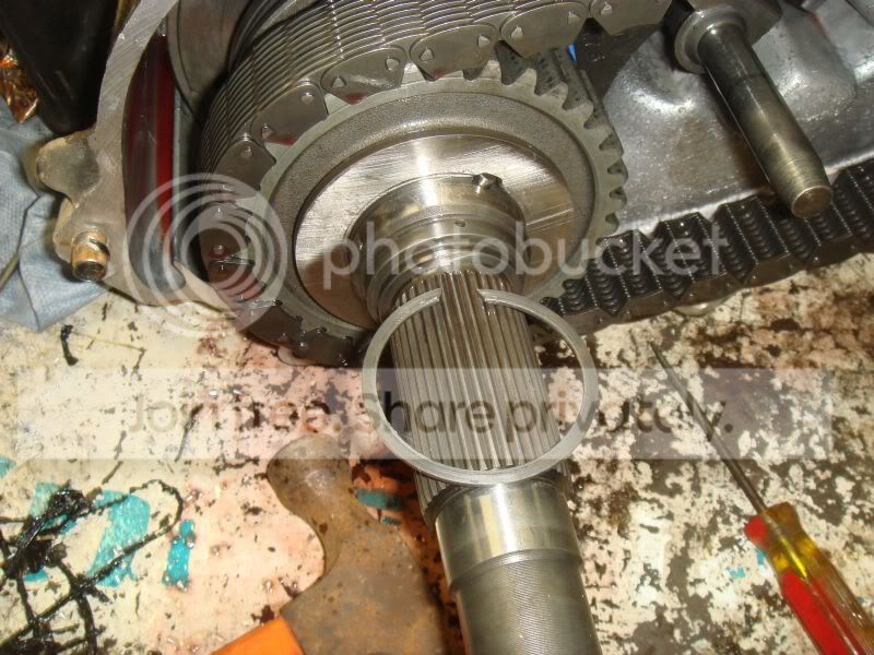

started removing the plastic gears. remember how this all came off!!
at this point things become very critical. so I needed a BL

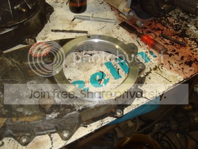

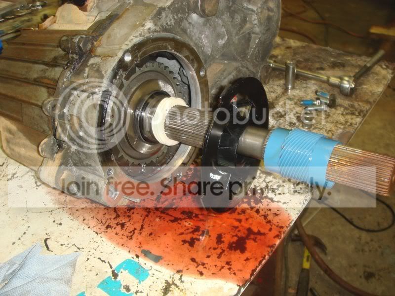

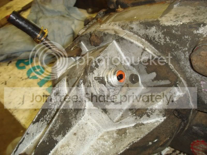

now when doing this they say you have to move one of the bungs in the dodge case for the shift rail. that means cutting it of and rewelding. the case is aluminum. so this is where we decided to try something else

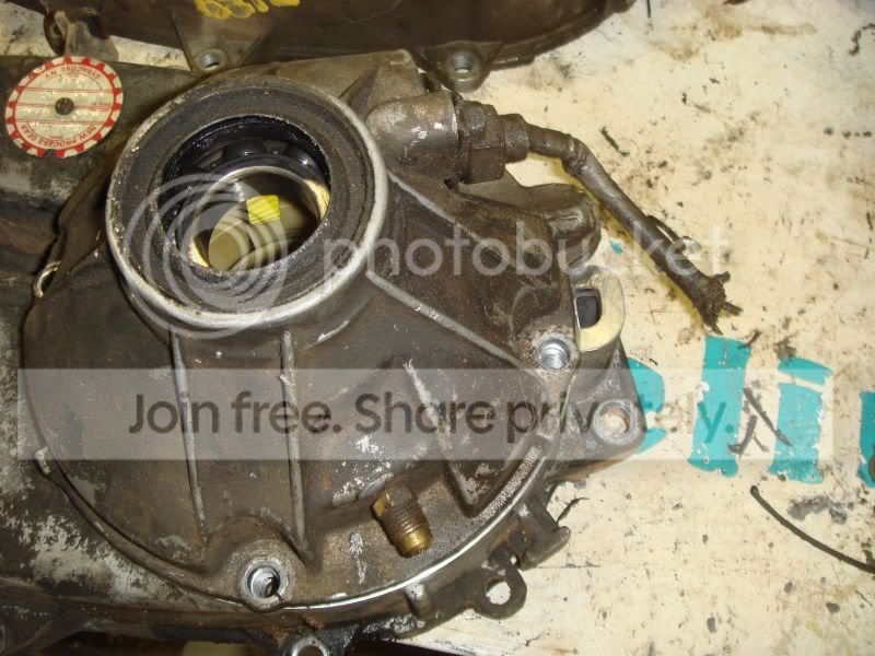

this is the dodge cone on the chevy case with the holes lined up you can see on the right side the oiling ports dont line up correctly
dodge back half
dodge output shaft
removed the cone
then the cone
to expose the shaft
