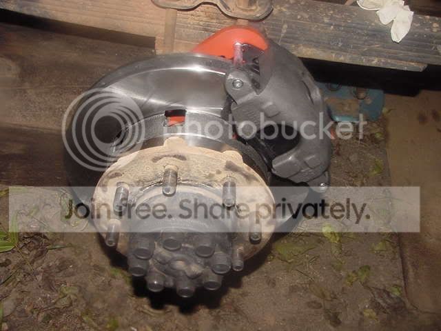

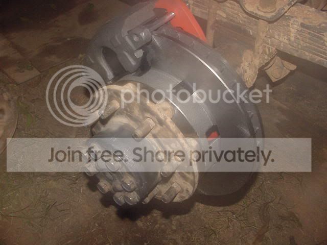

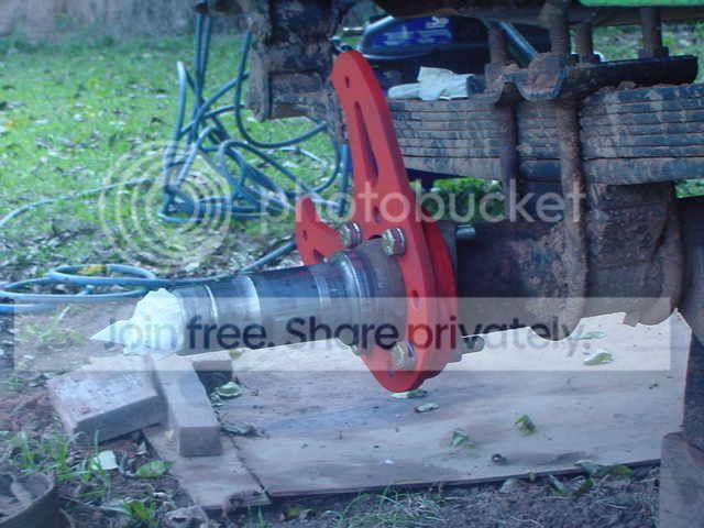

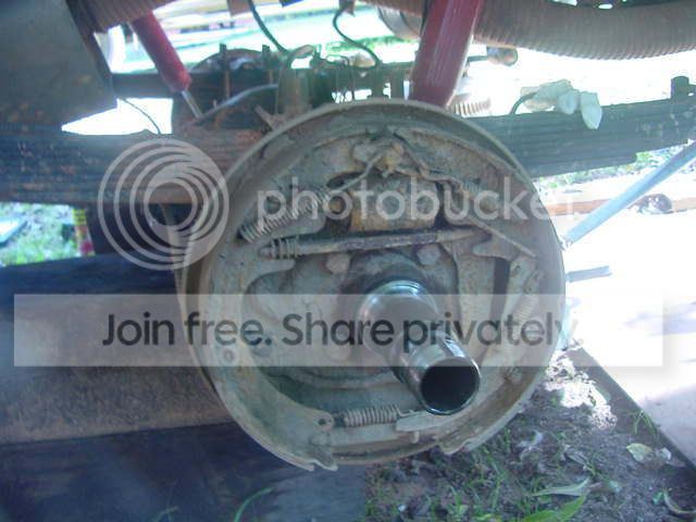

Well, this was about the first day college hasn't been making life suck with too much work, so I had a little bit of wrenching time.. My burb should be ALOT better lincoln locked and disked... I might even have time to shave a bit before the weekend is over.. I haven't hooked up my chevette lines yet, they're sitting right here in my room though.. Here's my little bit of progress for today..

that is awsome!! where did you get all of those things to do the swap??? me and my dad are thinking of doing that to his 74. hey are those the edlebrock shocks you got??

My axle is a 14 bolt full floater, www.diy4x.com makes the brackets to do the swap. I got all my junk to do it with from advanced auto, autozone, and a few other places like that.. Note, I'm using dana 44 calipers, so I won't have an emergency/parking brake.
I have around 5 inces of lift and the shocks I got were on a clearance sell at summit, I think they may still be. They're actually for another application, but with a little bit of bushing swapping around, they work just fine. their part number is EDL-20160
It'll make a big difference, mainly due to the fact that he didn't have any brakes on the rear to begin with:eek1:
