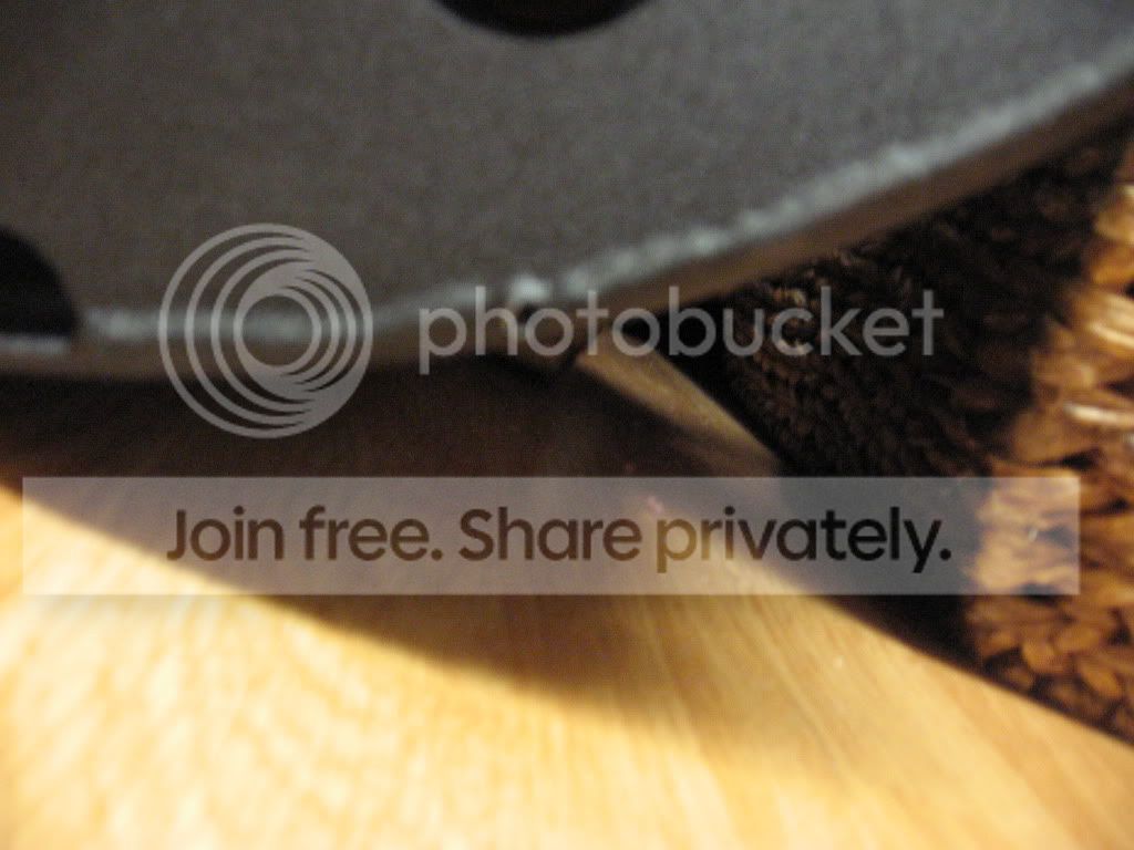

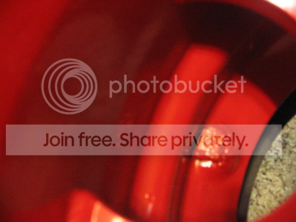

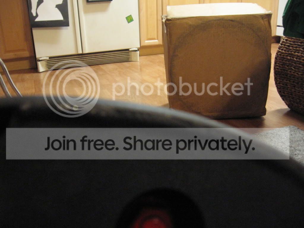

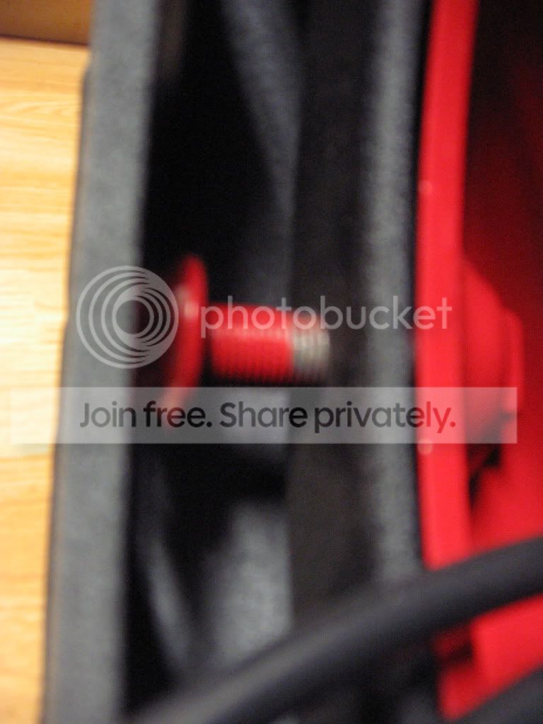

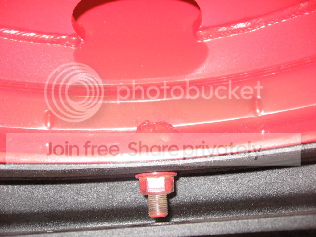

I couldn't get a good shot of the stripped out threads but here's some of the other stuff...please guys tell me if this isn't that big of a deal or not, I'm just pissed cause a 1000 bucks to me is a lot of dough
heres a stud that is welded
another one
powder coated stud unchased
bubble pop in weld...has me questioning the integrity of the rest of the welds
powder coat rubbed away. not too big of a deal... or is it?

I feel the same on the powder coat, I could be wrong but most wheels even new ones i have seen shipped in simple carboard boxes. Imagine he might have his own oven and its not a production quality set up/and or cheaper material. I know this to be true for a local shop I get parts from as I have personally got to use the machine while helping out for a sema project.

If the rim was correctly baked, should it rub off that easily in the box ?
Why wouldnt the company wrap them atleast ?

My guess is that your vendor didn't weld the studs in - someone in the armed forces did. Stud problems are a fact of life with used Hummer wheels. Sometimes they break or strip. Did the vendor give any indication of whether or not studs would be inspected and/or replaced? If that stud goes bad later, it seems like a hassle to grind off the weld to replace it, but you are going to break the finish even with a non-welded stud. It's always a good idea to have spare studs and nuts on hand.

As far as the stud being welded, it was probably done by the military, I have seen it before on stock wheels with the tires still on em.
As far as the powercoating, I would certainly be perturbed about that one. The rubbed off stuff. I have gotten other parts that were powercoated and I have almost always had to chase the threads.
The welds look pretty good overall other than just that one spot, so I wouldn't be worried about the integrity of the wheels
