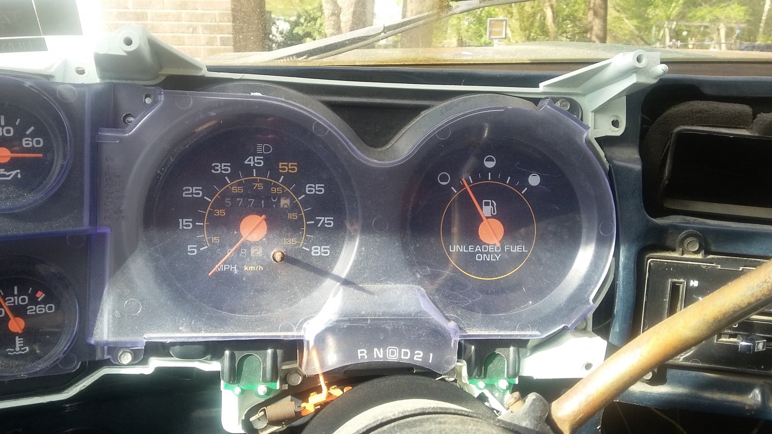

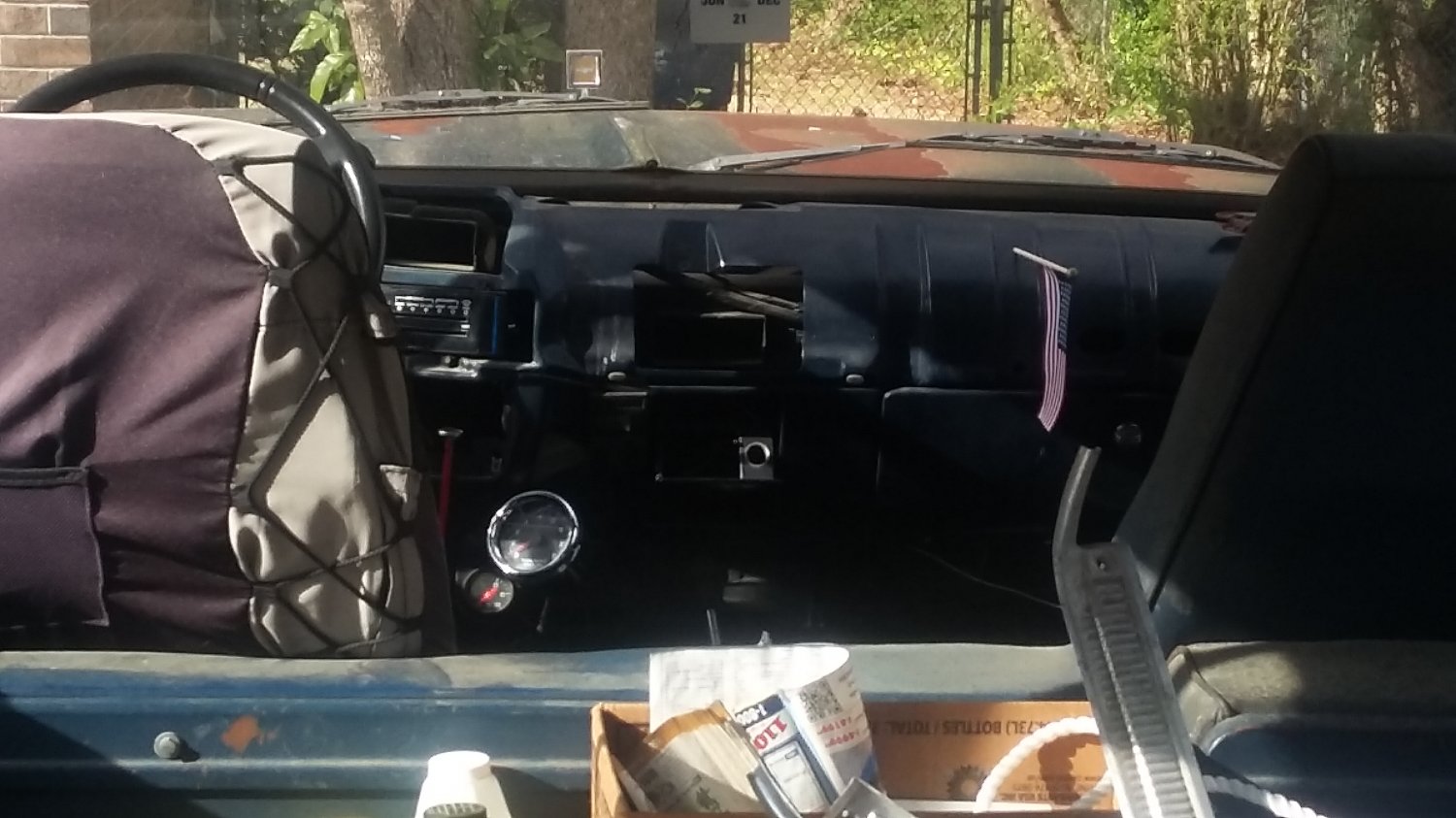

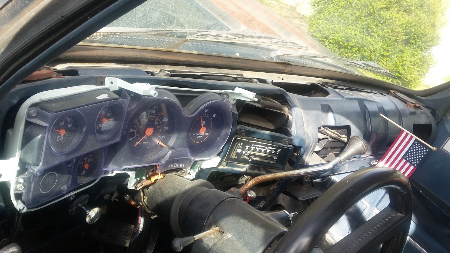

I've been dashless for 2 years. Still have the gauge panel in. No problemo...
some pics...
full
full
full
I drove around the last few days with my dash just like Bigrays, I had just tossed in a new (used) windshield and ran short on time before I got the dash back on. Turns out you can put a windshield in these trucks without removing anything at all and I would have been wasting my time if I wasn't switching dashes anyway
