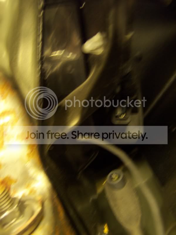

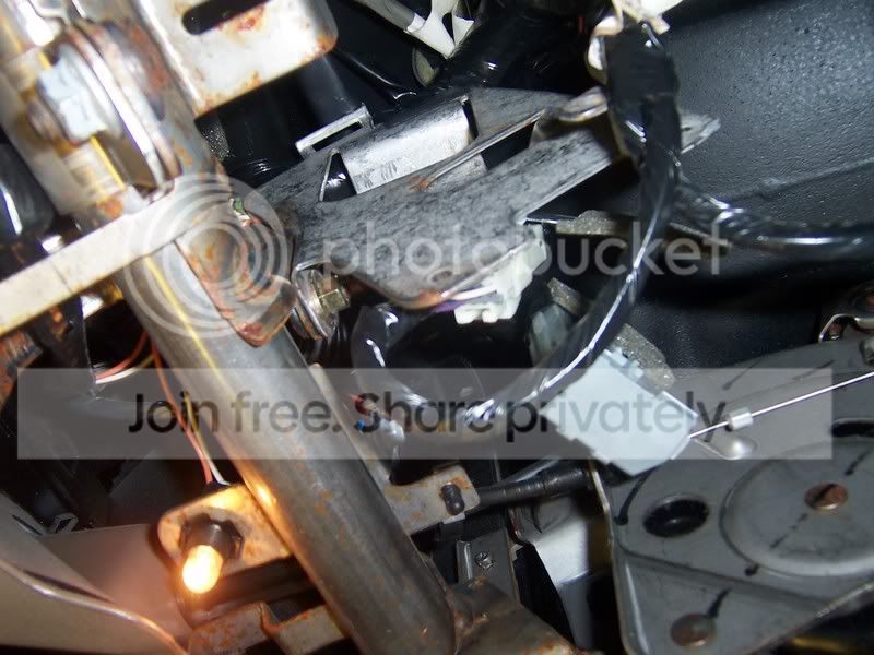

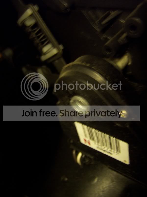

Ok onto the problem at hand...I rented a 8x23 tandem axle car hauler for this up-coming weekend and my dad said that he'd buy the P3 just to have with the truck but also so we could start using it this weekend so I was excited about that...

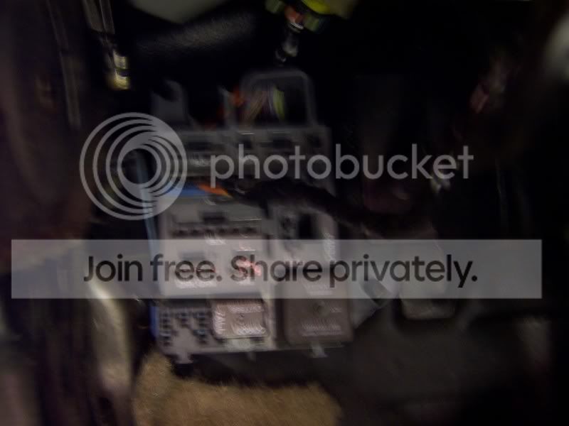

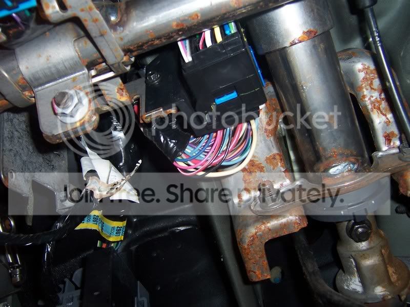

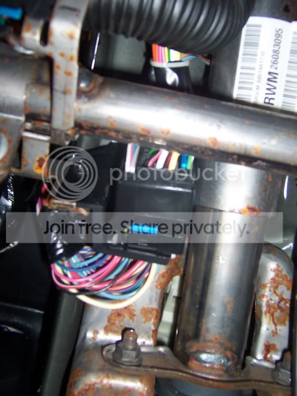

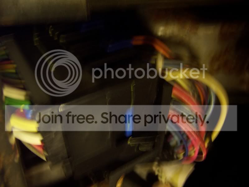

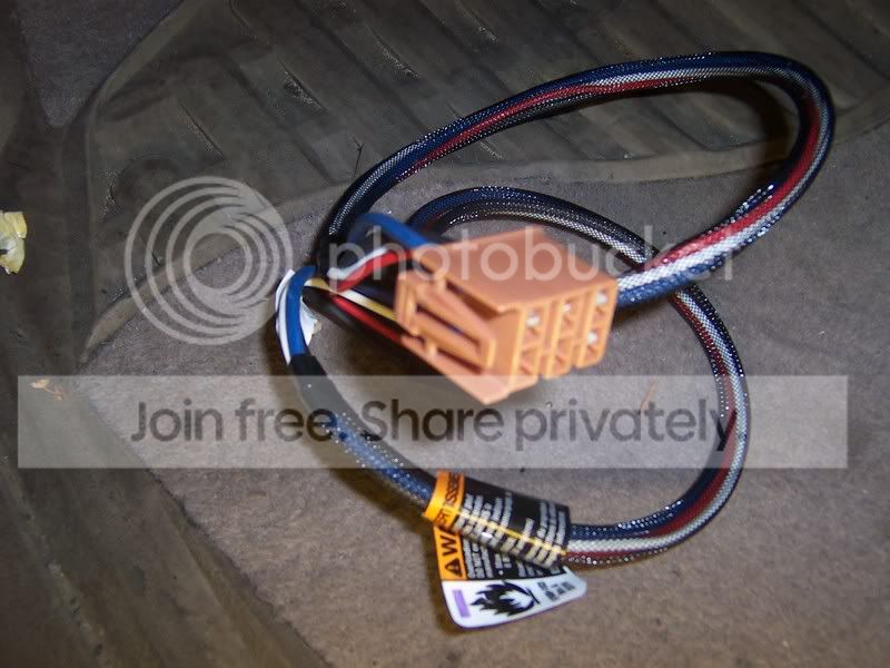

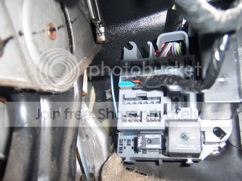

We swung by the same shop I got the one for my work at, bought it as well as the wiring harness for a '99-'02 chevy pickup...I got home and there isn't anywhere to plug the wiring harness in under the dash!
I looked everywhere and can't find it...on my boss' '06 2500HD right under the dash there were three open slots and it just plugged right in...under the dash on our 2000 C2500 I can't find anything...Chas any ideas?
Here's a bunch of pics if it helps...
This is the wiring harness (the brown part plugs into the truck somewhere)...
Thanks!
