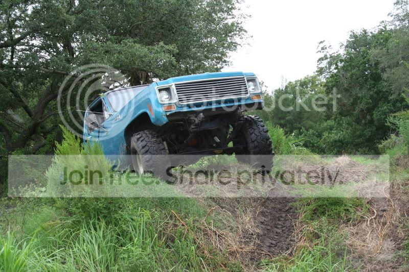

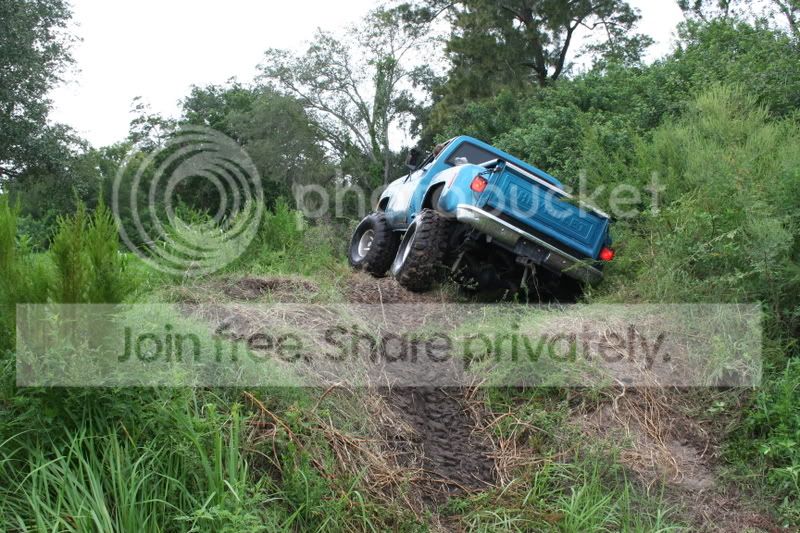

Bad frame flex. I Think I need to remove a leaf in the rear. The shackle angle isn't very good either.
Yeah it flexes a lot.
Yeah I have about 30 total. Uploading as we speak
You can see the shackle angle here
woah :yikes: !!! that's a huge amount of frame flex. at least it's a pickup. if you managed to twist a blazer that much, the body would never be the same. mine twists by a few inches at maximum stuff/droop, but wow.
You've got a pretty kick ass stepside! :bow: :waytogo:
I thought my frameflex was bad, but damn!!!
after seeing the first pic I would recommend checking your frame for bends or cracks but I know the frame is bent already.
Yeah it's cracked and bent
I think I might just weld some flat plate to reinforce the cracked part.
I took a pic but I guess the camera didn't save it
After wheeling it I couldn't open the door lol.
I would be checking all the body mounts as well. A bad body mount can allow the frame to flex way more than normal.
x2. loose body mount bolts have the same effect. i pulled my grill off and tightened the front two, several months ago. made a difference.
The two rear body mounts are very loose. Is there a nut on top or do I just screw them in? I never really looked.
I wouldn't be suprised if they are all loose.
If you're looking at the head of the bolt then just screw them in. The nuts are probably captive nuts and will not spin when you tighten the bolts.
