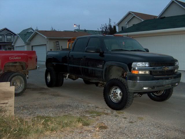

My friends dually. 6" procomp lift. 35" BFG A/Ts stock rims. Duramax Allison, 3/4" spacer between duals no problem daily driver................
