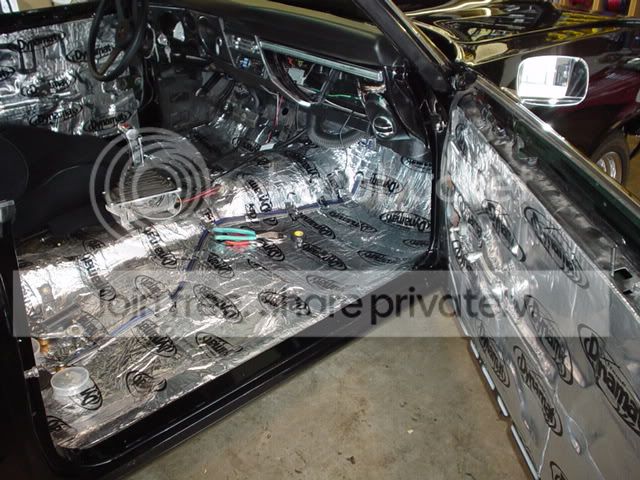

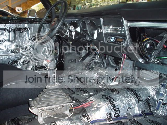

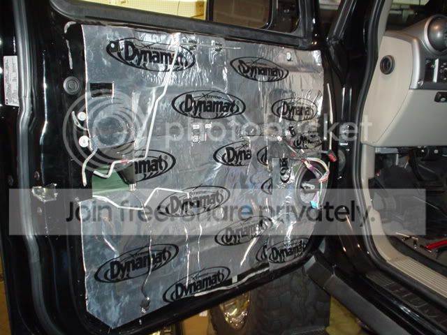

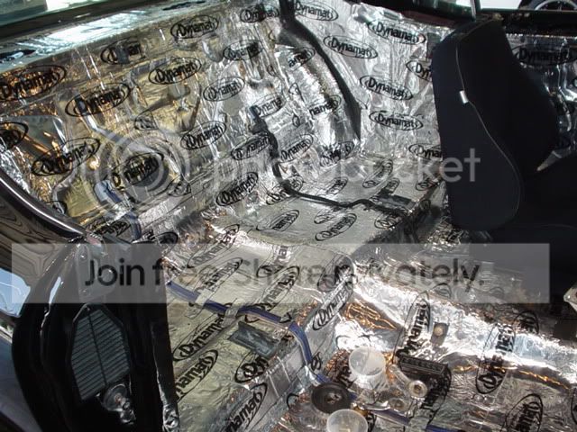

You are mostly right. Number one all dynamat is not created equal. Original dynamat is nothing like dynamat extreme. Side by side they are completely different. I would personally never use the original. Number two you are trying to eliminate the vibration of the metal structure not the panels themselves. The other products you speak of would technically work but will not stick as well to thefloor. To have optimal sound deadening it needs to contour to the floor evenely. I have found that a good prep job is key. AS the temp goes up competing products will start to lift and leave you with a black gooey mess.
This is how it should look!
