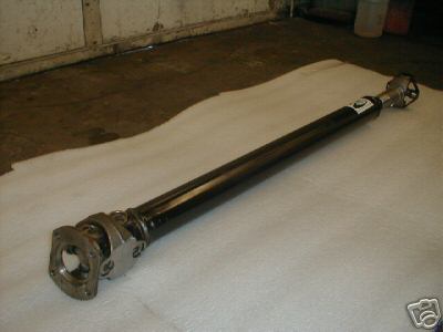

Anybody have experience with these driveshafts?
http://cgi.ebay.com/ebaymotors/NEW-...ryZ33738QQssPageNameZWDVWQQrdZ1QQcmdZViewItem
I contacted the seller about flanges to connect it to. Specifically I was interested in using a stock flange from the front of a 208 (my T-case has 28-spline outputs front and rear) and he makes it sound like he can do that.
hi. i can make this shaft with the chevy cv. 3" pilot. 1350 cv. flat 4 bolt flange. thanks curtis. 1-801-685-0056.
I'm just wondering. If this is so easy to do, then why do places like HAD produce custom flanges for their CVs?

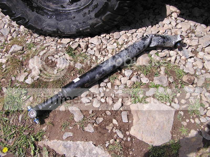

I don't think .080" or .125" wall will hold up very well if it actually touches a rock.
On a fullsize, if you actually want the shaft to rest on a rock and not dent I would plan on a .250" wall shaft (and then you have no chance of having it balanced or using it on the street).
I've had the truck resting on the front shaft (.250" wall) and on the old rear shaft (.090" wall). The front had no damage, the rear looked like this:
My .250" wall front shaft would have taken that with no damage, a .120" wall shaft would have no chance.
Basically, if your driveshaft hits a rock I wouldn't plan on .080", .090" or .120" to survive.
That is basically what I was trying to say. But pictures are better:D

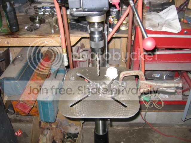

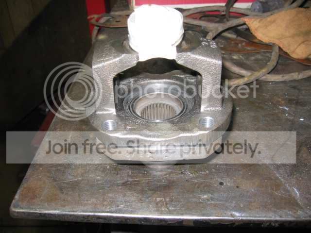

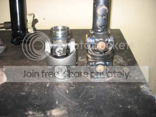

The c/v is complete with u-joints..here's a pic with it sitting next to a 1310 c/v. (Neapco N921052)
I had to disassemble to drill out the flange holes...
The spacer needs to be removed, then machine the stock flange on the t-case to fit.
