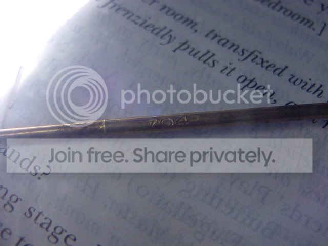

What kinda motor did you put it on? Do you still have the stock metering rods? I would be interested to know what the numbers on them are. If it turns out that I have smaller than stock rods, I'll buy your stock rods and jets from ya if you still have them. That is assuming that the electric choke and manual choke carbs are the same (mine is manual choke.)

I had an orange spring and the number on the side of the rod seems to be 7047, which should be the stock rod for a 600 cfm manual choke performer.

I'll check what rod I have in when I get home (I don't remember what one I switched it to), but 047 is the stock size rod that came in my 1405.
