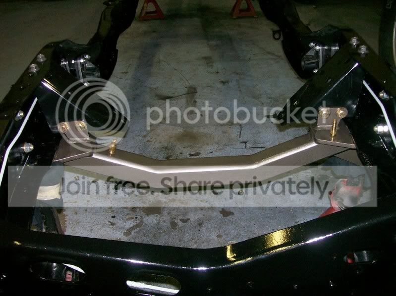

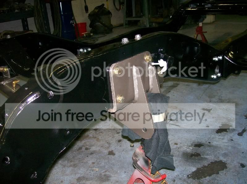

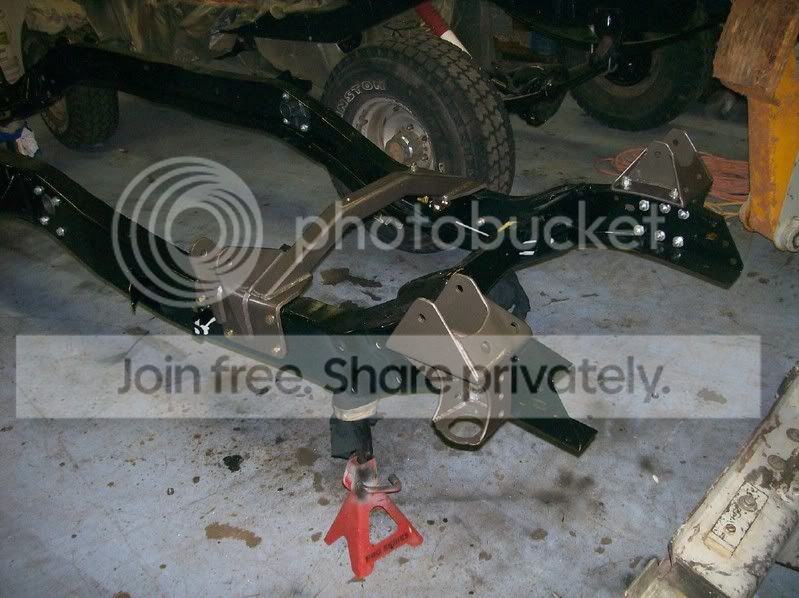

Just wanted to post up some pics of mine installed on my bare frame. Gives you a different perspective then seeing it n a complete truck :D
There is an upside down frame pic for ya :rolleyes:

First let me thank you for the complement, confusing my fab work with Kerts :bow::D.
Actually I built those, obviously based off of Kerts design, I wanted end up with approx 8" of lift, I had a set of 6" springs that I wanted to reuse and I really liked the stoutness of his design. These keep the springs in the factory position but drop them down 1 1/2" inches, combined with Kerts add a inch and factoring in the weight of the BBC and the bumper I am planing I should end up right around 8".
I have longer rear shackles to match as well, they are all made from 1/4" plate and overall I am happy with how they turned out.
Did you make these to use with the stock length front springs and wide bushings?
Yes, I am using a pair of 6" Skyjacker springs I had in my 85 K5 that I parted. The hanger part of mine measure in at 3 1/2" inside width, my springs have new poly greaseable bushings (ORD stuff) so they fit perfectly inside.

did you see the pics on this thread? it is plain to see, i mean im not being a smart ass there are like 4 pics of the crossmember only mounted to a frame...
