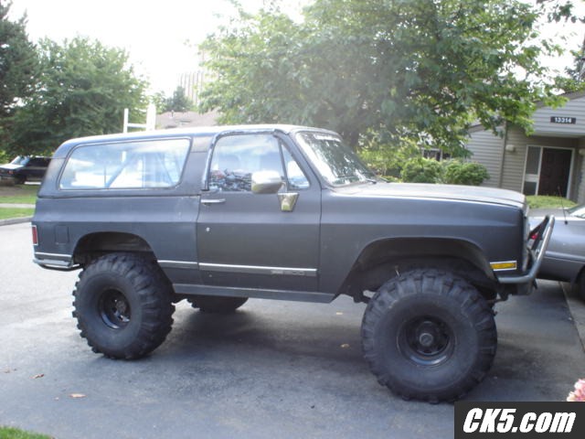

Easy to clear 37" with 4" lift. My V3500 crew cab has a 4" lift with 37" and a fender trim, works great. My '90 blazer has 38" on it with a 4" lift and the axle 1.5" forward, big trim and will probably clear a 40".
My trimming advice is cut the fang off the front of the fender. At the rear of the fender opening measure back about 6" along the bottom, adjust this for personal taste. Mark the bottom then draw a straight line up to the curve in the fender opening. This will give you roughly what K85 Octane has in the picture. This line is the "fold" line. Mark a "cut" line that is 1" less. After cutting make a bunch of slits to the fold line and bend all the tabs in. This will give you a pretty nice edge and help with looks and strength. Extra points for welding all the tabs together, you will get a real strong fender if you weld. You will need to beat the inner fender back some with a sledge.
Here is my old pile with 5" of lift and trimmed for 40's. Front diff moved forward 1.25"
