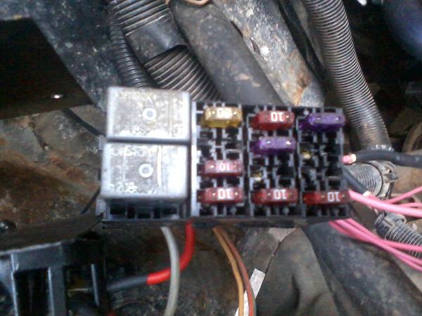

More pics, since I "updated" my auxiliary fuse panel. Not sure what this is out of, GM something, Dad might have grabbed it for me. Much nicer to have the relays as part of the panel. As always, apologies for crummy phone pics. I can't make excuses for the wiring though. It's a mess. Really need to take the fenders off and do this when I can actually access everything. It's really hard to run wiring with everything that is in the way. To my credit, I wasn't done when every pic was taken, but it's not a whole lot better now that I am.
12 fuse slots, since I purchased all the terminals to wire up the panel as I saw fit, I left ones I'm not using empty. Fair bit of room for expansion I figure, the panel runs the ignition switched EFI circuits, plus the mirror and camera of course.

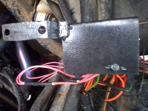

This is the "holder" I made for it. The last one I used didn't have a cover on it, and really wasn't much of an issue except dust, so I figured I'd bend up and weld a basic cover for this one, since I had to come up with a grounded mount for it anyway. Easy fix! That's an 8GA feed wire coming in from the battery, the others are batt 12V to the relays.

I thought the wing nut on the back of the panel cover was a nice retro touch lol. The auxiliary fuse panels like this are all plastic, and the "feet" are supposed to clip into whatever they mount to. Not real practical in the truck, so I drilled a hole in the panel, put a screw through it, and the wing nut is what tightens the panel to the protective cover so the panel doesn't move around.
