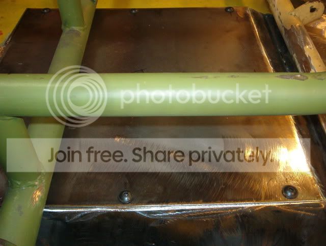

I hav the removable transmission hump. How would I go about taping it off so i can remove it again in the future? Leave it bolted in and cut the "seam" afterwards?
you'd have to cut the sealer for that to get it off anyway, just line x over it.. later, unbolt, cut thru line x, sealer with razor knife and scraper... touch up on reinstall...
like my custom one.....
I'll trim out the sandwich lip with paint, install the rubber gasket (as opposed to seamsealer), install cover plate, roll herc right over everything.. time to open it, cut with razor knife...
ok another one........ I know I know......
If it were me, id do it the same way they did the rear tailgate access, remove it and do it as a seperate peice and just put the bolts in the holes in the floor to keep the Line X out of the holes. Otherwise youll have to cut the Line X and could turn into a nightmare.
Keep in mind that if you remove a panel be it rear tailgate access or trans hump, there will be built up material at the edge so you will have to work the panels back in their position. My rear tailgate access panel sticks up ever so slightly due to Line X build up, but nothing anyone would notice.
yeah, but the tailgate plate is easily removed, pull the screws and it comes right off... trans hump's are super hard to get off sometimes.. why break the seal and invite leaks to something you may never actually have pull back off?
