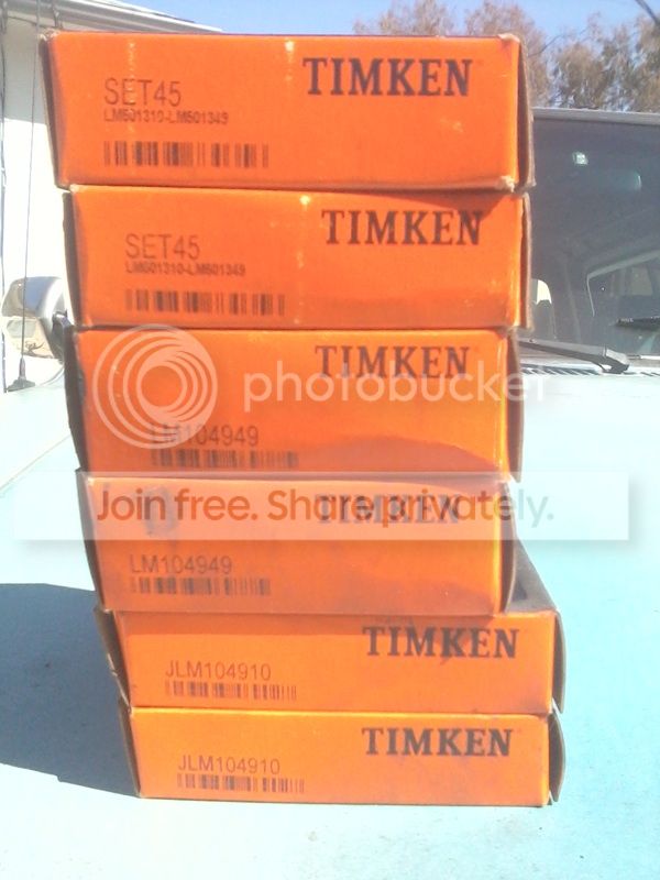

Timken #
Set 45 - outer bearing and race pkg. (LM501349 bearing, LM501310 race)
JLM104910 - inner race
LM104949 - inner bearing
Just re-did my entire front end on my '89 Blazer and this is what I used.

I realize this thread is old but it has exactly what I was looking for, I think.
I've got an 85 K10 that I'm putting 8 lug hubs on. From what I've read, my 1/2 ton spindles (being that all 10 bolt 1/2 tons had the larger spindles) are the same as the 3/4 ton spindles of all years. I don't know what year the hubs I'm getting are. They're just used 3/4 ton 8 lug hubs.
Do the bearings and races in the picture in post #5 fit all years of 8-lug D44/10 bolt hubs and the 10 bolt 1/2 ton spindle?

No, there was a year split between small and big bearing and the year split was mid 1976. If the hubs you get use a different bearing then you'll need to find the matching spindles as well. You cannot swap bearing sizes in the hubs from one size to the other.
