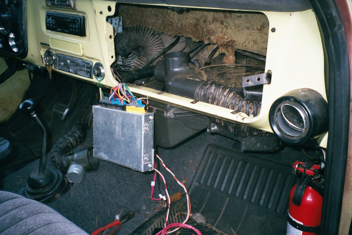

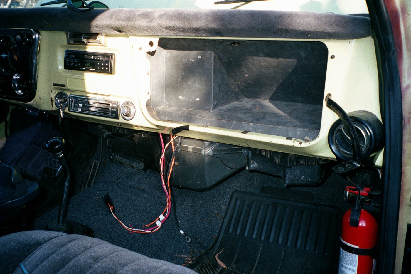

Where did you install your ECM? My inner fenders are either going to be gone or hacked up by my engine cage, so I'm looking for ideas. Pics would be cool if you have them.

i bought topdowns projection and i'm planing on puting it in my center console that i bolted to my cage.he had it in his glovebox. /forums/images/graemlins/thumb.gif
Re: Fuel Injection guys, I\'ve got a Q
mounted mine to the back of the cardboard glovebox liner.
yep i mounted my ecm pretty close to where bobk mounted his..
I put mine kind of next to or above the radio and next to the glovebox under the dash...
To weatherproof it just a bit for in case my truck gets the ocassional rainshower with the top off.. I used a bag and put the ecm in it, then taped the open end of the bag around the wires.. then once installed i poked one or two small holes in the bottom of that bag so it wasn't totally sealed and it could breathe... but it would be like an umbrella if any water got under my dash. /forums/images/graemlins/peace.gif
