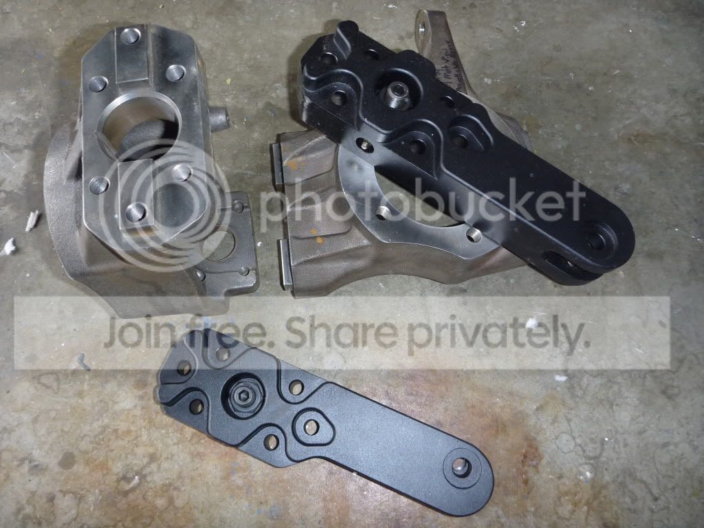

those arms look like a nice setup, but hard for me to not like my new ones that i just put together. virgina 4x4. the difference in the amount of meat on the double shear is pretty big. these are machined out of a solid block of 2". running psc kit with single ended ram.

Well kinda, I traded my stock knuckles for these... The knuckle itself has also been beefed up with 1/4" flat stock... In person they are really impressive...

Looks like a stock knuckle with an arm weled to it? Is that the case?

Mine are from Virginia 4x4 like ssyork's too. Mine are the keyed 6 bolt ones for solid knuckles and his are for reid knuckles.

Yes, the arms are bolted and welded with a formed 1/4" strap welded down the front too. I made them before aftermarket knuckles were available.
