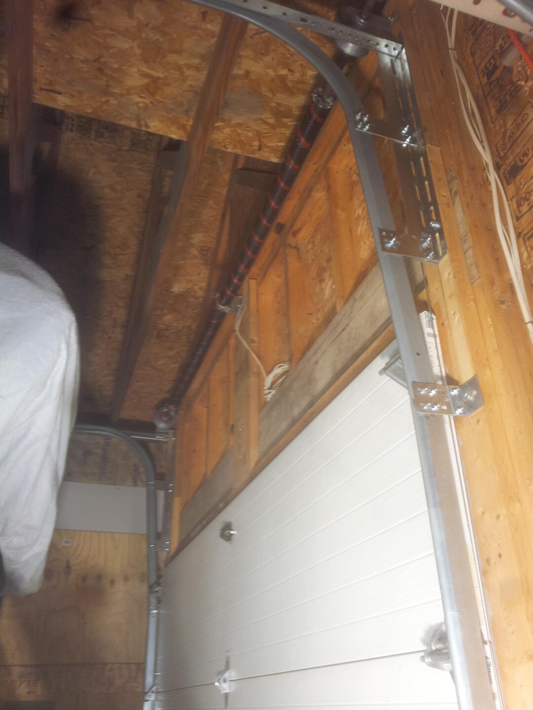

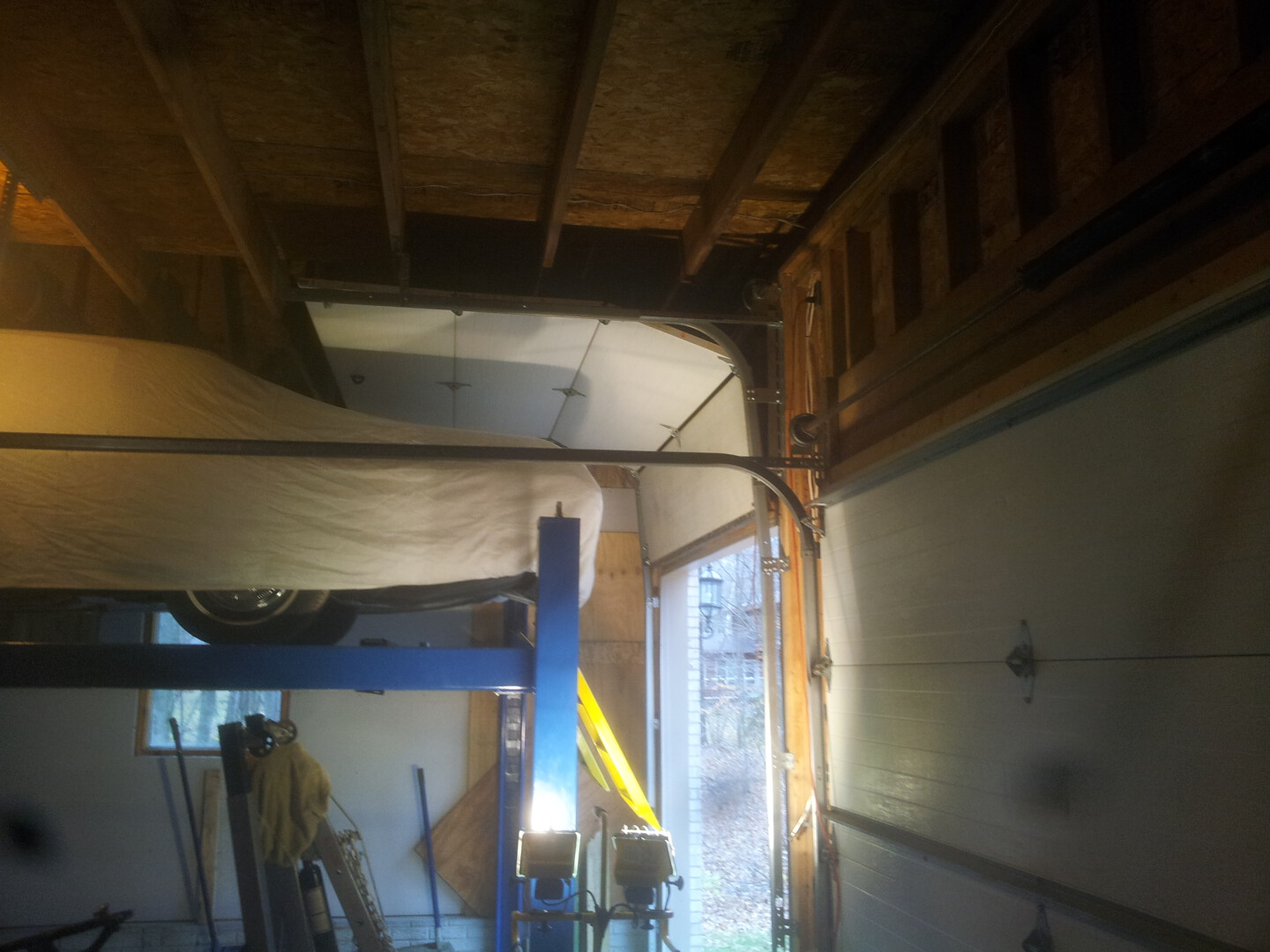

I recently bought a lift, I have 12' ceilings with 8' doors, but with a car on the lift, the door was not usuable. So I needed to convert the door to high lift!
Requires new springs, drums, cables and an angled vertical track extension. I just wanted to pay someone to do it since I've never messed with a garage door before, I know what I'm like, I'll spend hours researching and looking up stuff, what's needed, reading tutorials...I just wanted to pay someone for once...

Installed it yesterday with the aide of his super detailed tutorials from assembling the vertial extensions, to how to wind springs to general door adjustment tips... and didn't have so much as any little hitch.

Now I can actually use the bay underneath the lift for parking my little tractor and snowmobile , or another car, when I'm not wrenching!! No more shuffling crap around to get one thing out.
Being able to open the door while using the lift would be reason enough to convert it.
